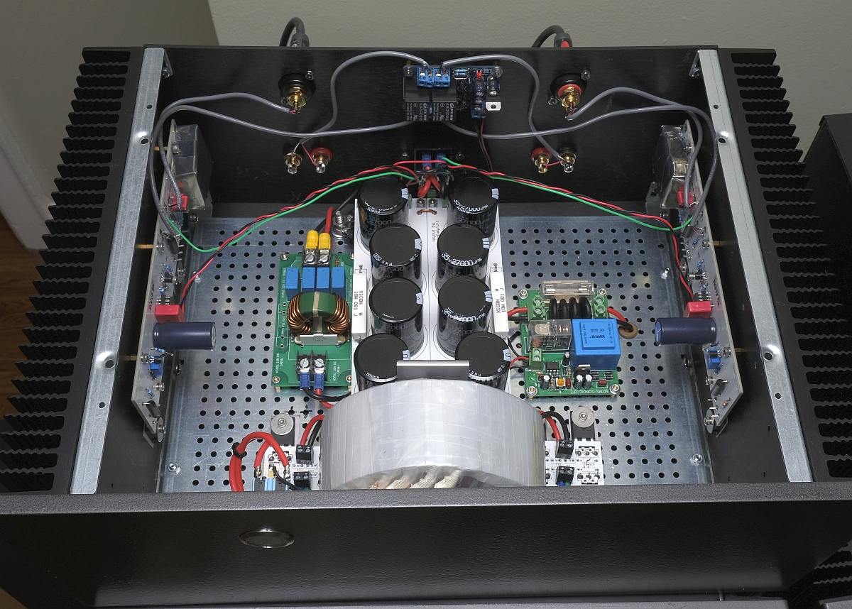

People are using the Fo-Felix inside amps and things as well as in distribution. I'll draft up a MOV board perhaps soon, and/or look at other surge tech that could be used.

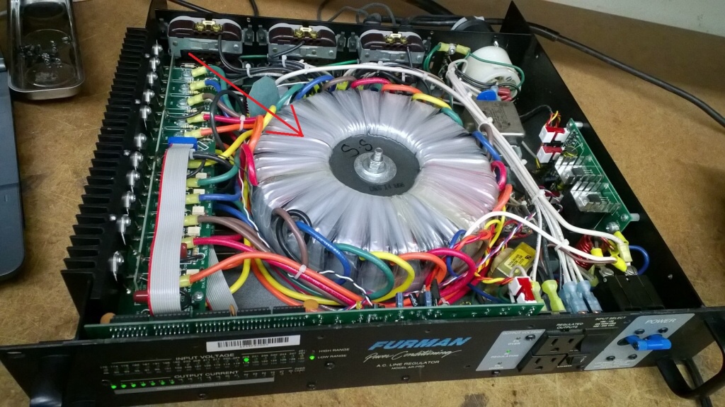

I've never liked the sound from Furman. The transformers are small and they make a few (IMO) classic mistakes with their filters. If you want a good transformer unit spend more (a lot) and go with Torus AVR20+. I wouldn't fiddle with the other stuff at all. I'm not even fully convinced that isolation transformers provide sound I like. (I haven't heard a stereo with one that was spot-on yet, but it certainly is possible I just haven't heard the right stereo). The Torus are much larger and the AVR function prevents sag, which otherwise makes the units only really good for TV's, Streamers, and Blu-Ray.
That’s why I suggested a daughter board. I think it’s wasteful to use in one amp.... especially with how people around here go through amps.
My thought is they are likely doing this because they are then plugging that amp with the Fo-Felix into their existing power conditioner or surge protector unit.
That’s where my thinking personally went.

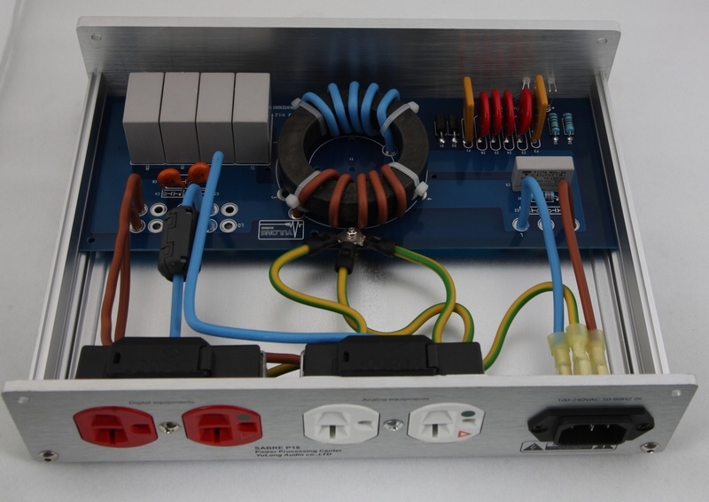

Again, Furman was just an example. The Yulong Sabre P18 is another low cost example. Looks like it’s closer to your conception.

My tin can comment is geared towards the inexpensive 15ti unit you mentioned. But the Yulong Sabre P18 is basically the same thing but with presumably worse surge protection. From what I can see it has some choices I would not make, and not great surge protection. The problem with MOV's is they are very limited. That's why people use several in parallel (and I probably will to). So you pretty much need something else to help take on the load. GDT works because they are slower but can pass and clamp extensively higher amounts.
The Furman's pro line that's AR spec'd does voltage regulation but only has a single CMC and some caps for all the sockets.
The Furman reference line has large transformers but zero voltage regulation so they can sag extensively easier than Torus models.
You would need to combine a $1300 and $2500 Furman into a Frankenstein setup to equal one Torus. And you still wouldn't get isolation between your equipment.
