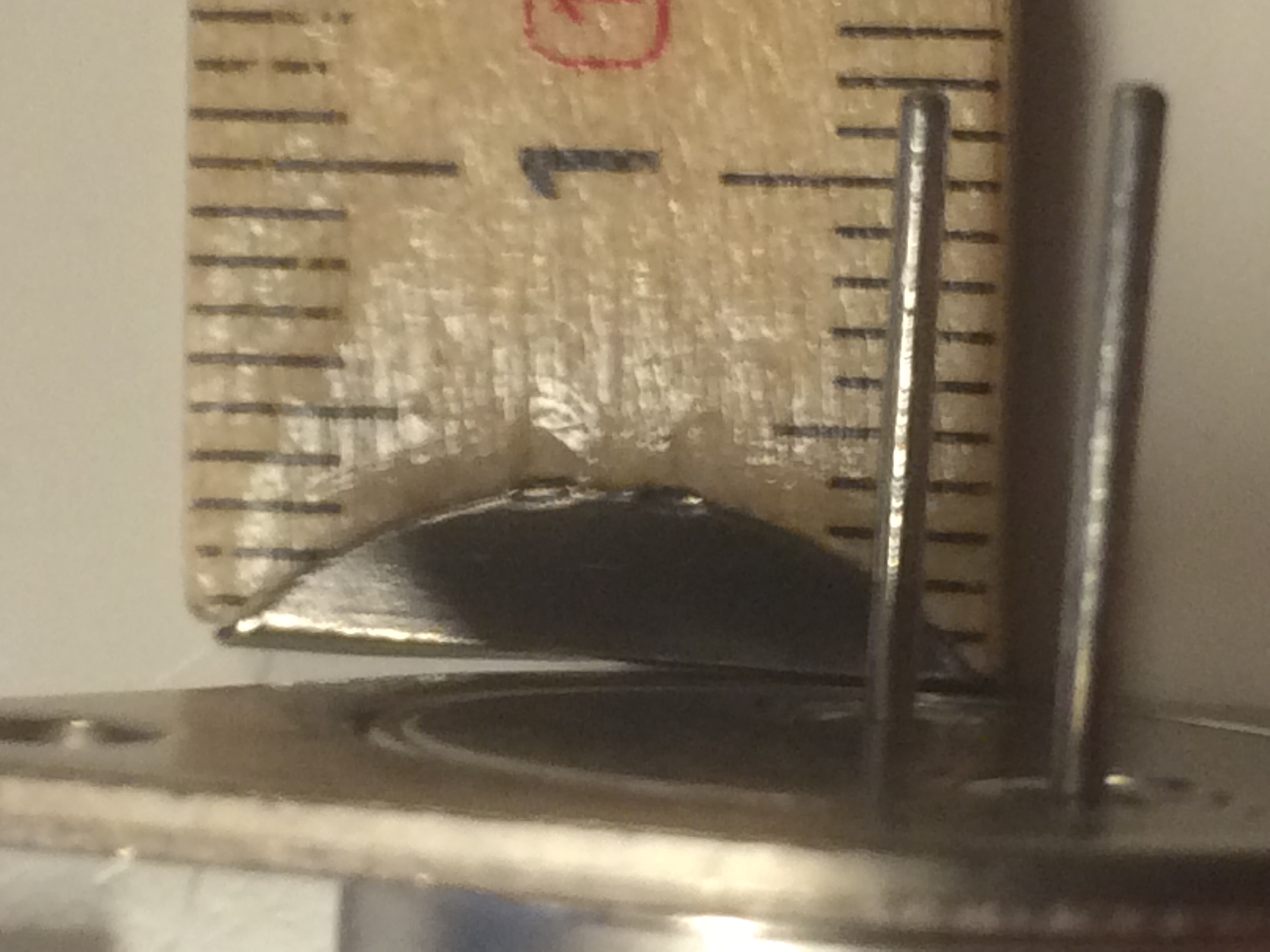

Yeah. Fischer in Germany have this 60mm 60mm and 6mm thick STP 4, Aluminium Flach-, Vierkant-, Winkel-, U- & T-Profile, Khlkrper f.cool, Fischer Elektronik
I see. Well, this gives an indication for the max this ckness of the profiles.
VFET legs are 12 mm.
Thickness
