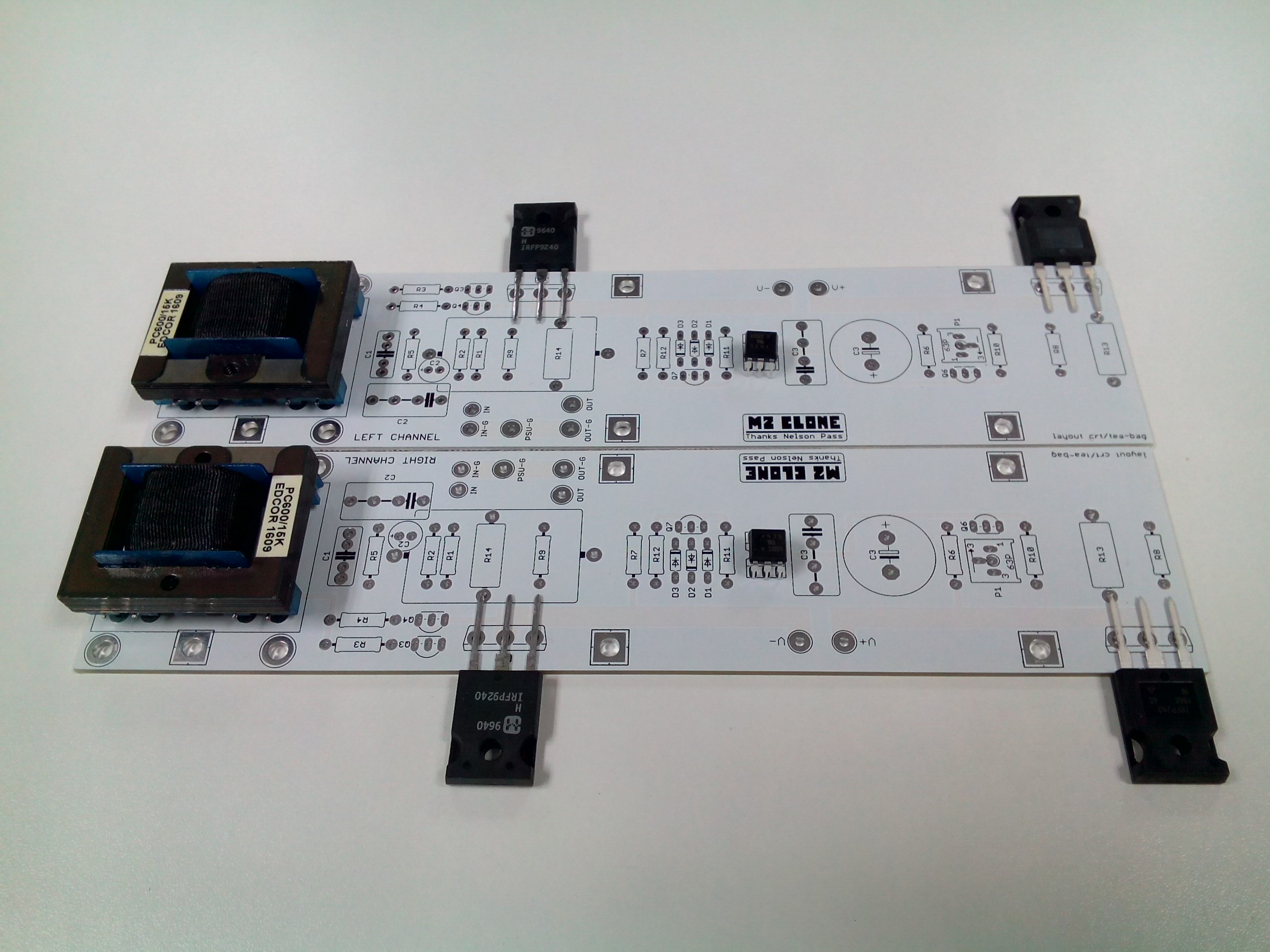

Hi Tea-bag.
Got the parcel safe and sound apologize for the delayed update.
And thanks for the nice package.
Going to go through a bom tomorrow 🙂

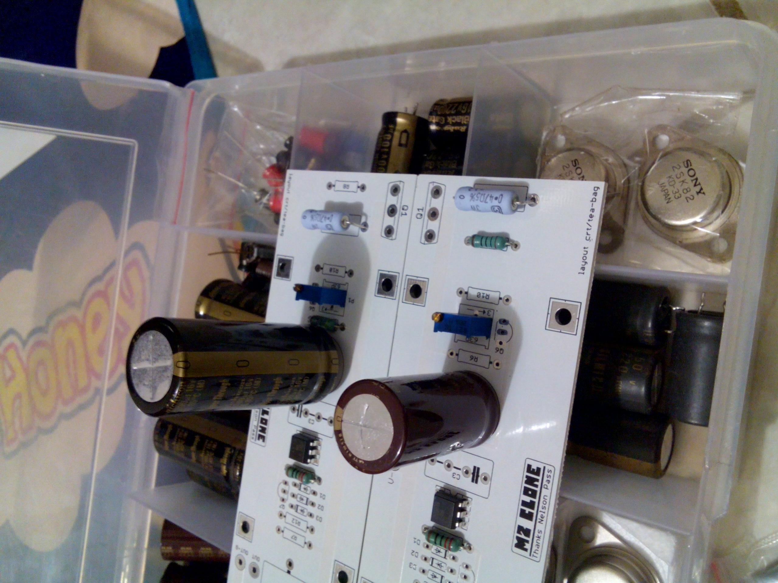

What is working voltage on C3? Just look at my drawer,I find lonely Elna silmic ii 1000uF 50V (fit nicely on the board) and nichicon superthru 4700uF 16V (body is too big). If I remember correctly,C3 will set charge up period, higher will be longer,smaller will be faster. Any advice which one that I should use?
