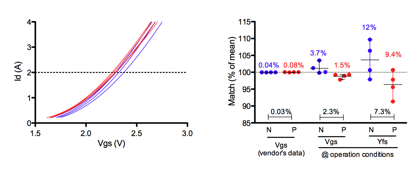

> I have noticed in matching that some devices are more affected by changes in temperature than others.
That is precisely why I always insist, to the annoynace of some here, to match under operating conditions.
And of course I know why this is so. And I can give you a hint.
See if you can find any data at all on the Rthjc of Toshiba FETs.
Patrick
Patrick

While you may think the nikon1975 set is "good to very good" this is not really the case. The Yfs of the N-devices are all over the place and perfect P-devices, or a balanced topology, will not fix this.
Nic has shown you a good matched set from other suppliers.
I have seen much more terrible ones from his measurement data.
So while he is being polite and diplomatic to those offering matched sets here,
what you saw above is the pretty side of the story.
Patrick

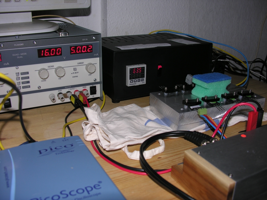

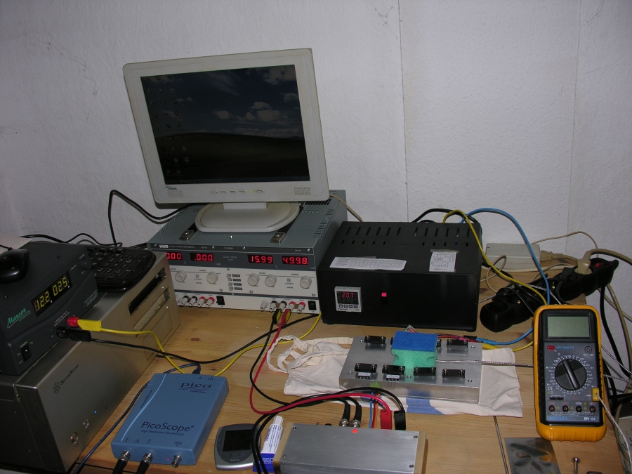

Here are two pictures of the equipment I use for data collection. The first one shows the working environment:
I collect the raw data and send them to Nic for further analysis and processing.
- USB scope connected to computer and FET tester
- Power supplies for FET tester (16V, current limit set to 5A, output switched off) and 12V heating circuit (delivering 2,5 A to heating block via SSR in PID controller case)
- PID controller case and heating block
- Multimeter with thermocouple for additional temperature monitoring

For those who have already bought NP-matched (not PP-matched only) devices from Zhou I am likely to be able to help in finding significantly better matched 2SK1530s for their 2SJ201s.
I will likely do this free of charge for people who are going to get matched sets from me, but this service may also (FETs permitting....) be extended to others.
More about this later.
Nic

Patrick,
that is of course all completely correct. I do mean improve, not make perfect. What I am saying is simply that the probability of having a decent PPPP-set is higher than having a decent NNNN-set. But still a lottery.
The 600+ 2SJ201 I have looked at for certain have a much tighter Yfs distribution and more similar Vgs change with temperature.
The only right way is of course to get the FETs to heinz1 and have a look at what can be done, with no guarantees and well understanding that we are not in the miracle business. This would obviously only be possible if heinz1 would agree to do it and in front of a reasonable compensation for his efforts.
We have now settled for the 26 perfect NNNNPPPP-sets and most should be able to finish their amps🙂
We should have the time over the next months to investigate the possibility.
Nic
