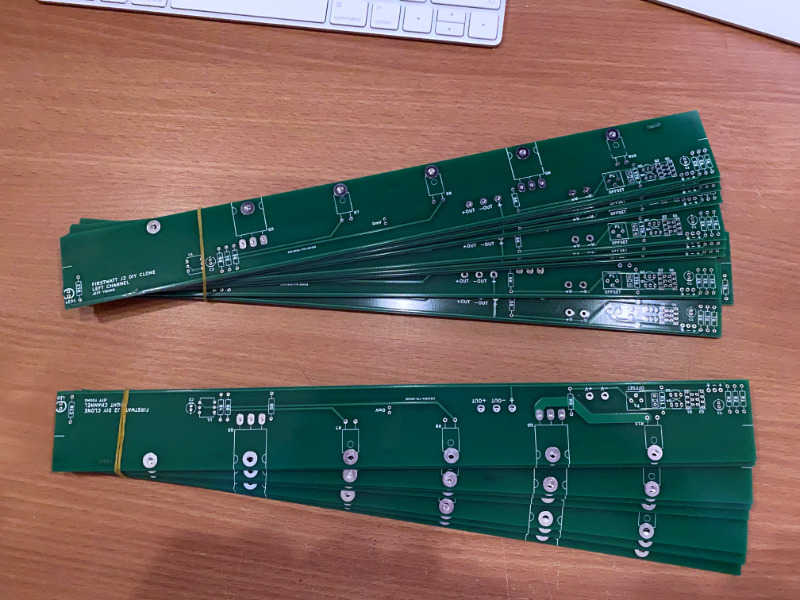

H,
pcbs are landed, tomorrow I will start packaging and contact for last paying.
@atom622,
still interested, then wrote me a PM?!
@atom622,
