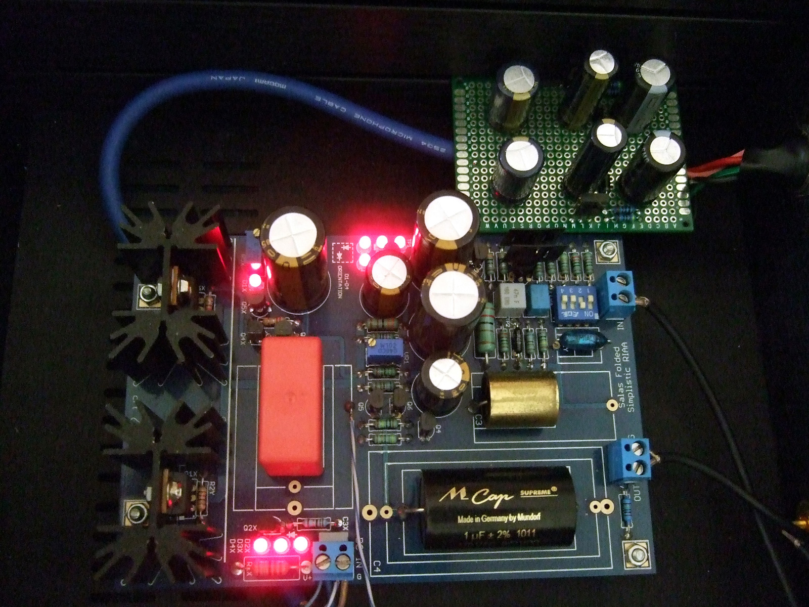

I have an original unbuilt FSP kit that I have been working towards by building a few simpler phonos first.
I’m pretty sure I have everything. Possibly not the extra JFETs to build it specifically for low output.
That is because I wanted the flexibility of using it with both MM and MC carts and I have a high quality JFET MC head amp I can switch in and out in front of the FSP to allow for an additional 20dB of gain.
It seems like this “Ultra” version has addressed the issue of adjustable gain and also improved the power supply.
Are there certain parts of the package I can buy to use with my original FSP kit so that I can benefit from some of the improvements?
I’m thinking maybe the power supply? But it seems like the variable gain would require new boards?

Chromenuts, I still have many parts needed for the original design if you want to complete that. The 2SK369BL Quad is what you want for low output. But this kit overall, even minikit, not appropriate for older version.
We dont offer the 1.3S supply separately to rig back to this unit, which would effectively be mostly the sames setup , sans the ability to alter gain readily.

Why not add your own between the boards, or the power supply by cutting a trace? Another regulator would be much more effective though and is easily converted from C multiplier circuit.

Then you should see what a regulator can do! Far more effective than a C multiplier, same layout and only a couple parts change. So the question then becomes, why on earth would anyone use a C multiplier???

Alex hi. I had also tried advanced 2nd order Cmult in-between the Raw PS and the onboard shunt reg in the previous realization. Results were not palpable enough for me thus I did not adopt it or recommend it as standard part of the phono configuration. Cmult is very useful in many situations but rather not in this one. It proved a robust enough system for raw dc line noise rejection on its own.
