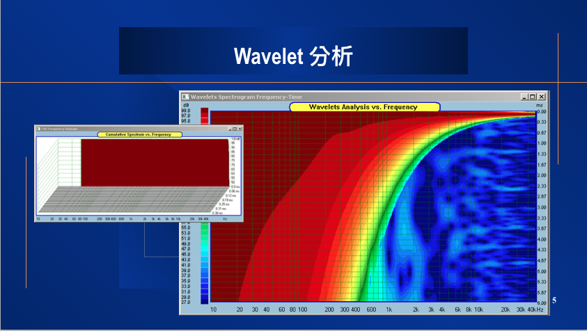

Here is an example of software loopback. The CSD plot did not have enough scaling range to show lower level effects, so I used the wavelet plot on the right. As we can see, this is clearly not ideal. It is not clear why this is, but it would be good to have the capability to gradually isolate.Can you provide a bit more detail? Maybe an example?
The different version of the software generating the CSD plot would generate more artifacts visible in the impulse as well. I am just demonstrating the clean version as an example.
The CSD plot looks perfectly ok to me. However, I can't read the numbers on the y-axis, so I can't compare to the wavelet plot. I am not sure what the wavelet analysis does, but I guess the issue you are referring to is the hash/noise in the blue area -- correct? Is the wavelet analysis really comparable to the CSD?
Ok, if the same data gives different CSDs, something has changed with the software. You could ask the programmers if/how they changed the software. Note that this assumes you compared CSDs / wavelet plots using THE SAME data, not the same measurement setup to measure things once with the version X and again with version Y, which will give different noise residuals, and hence different hash on the CSD or wavelet plot.
Can you export the impulse response data and upload here so that we can look at it and make CSD or other plots from it using different software?
I have talked with the developer, he is aware of the changes and looking for a better solution. It seems that for this particular case, MLS signals generate a DC offset which results in some artifacts. I would suggest programmers look at their own programs and generate results first so that some comparison can be made.
The scale on the CSD goes from 100db to 50db and the wavelet goes down to 20db if I recall correctly. Yes, the light blue in the dark blue background are some artifacts, some of which seem to have some repeating pattern over time.
Well, yes, an MLS signal does have a bit of DC. Windowing a signal with a DC offset as it is done when the CSD is calculated will cause some artifacts showing up at frequencies above DC. This effect is not unexpected and it is related to the CSD+MLS method per se. I would not consider this as a problem with the software.
