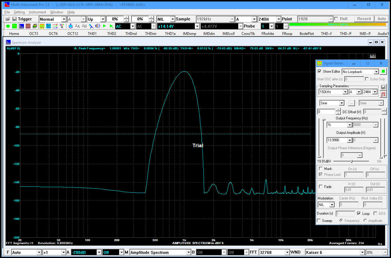

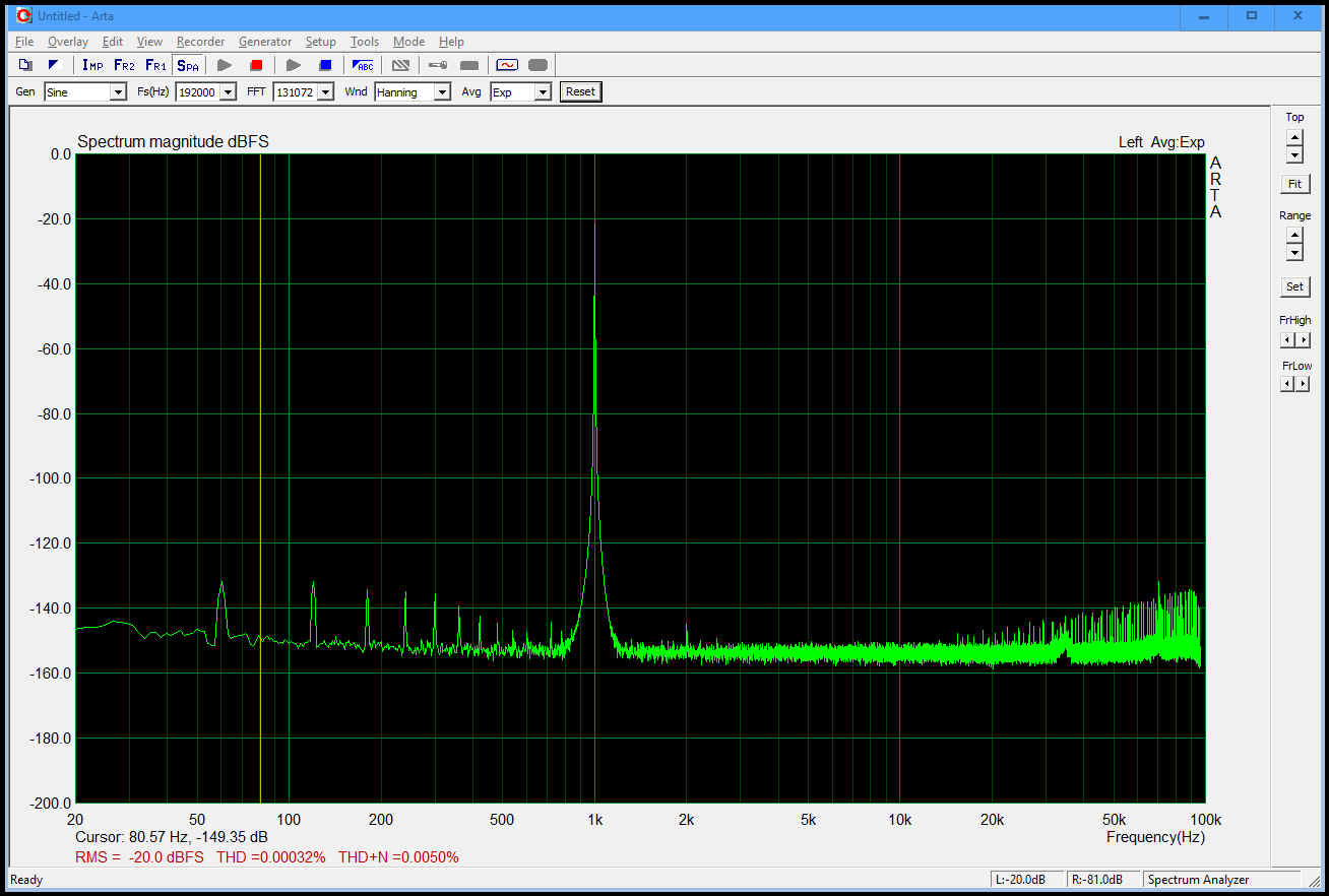

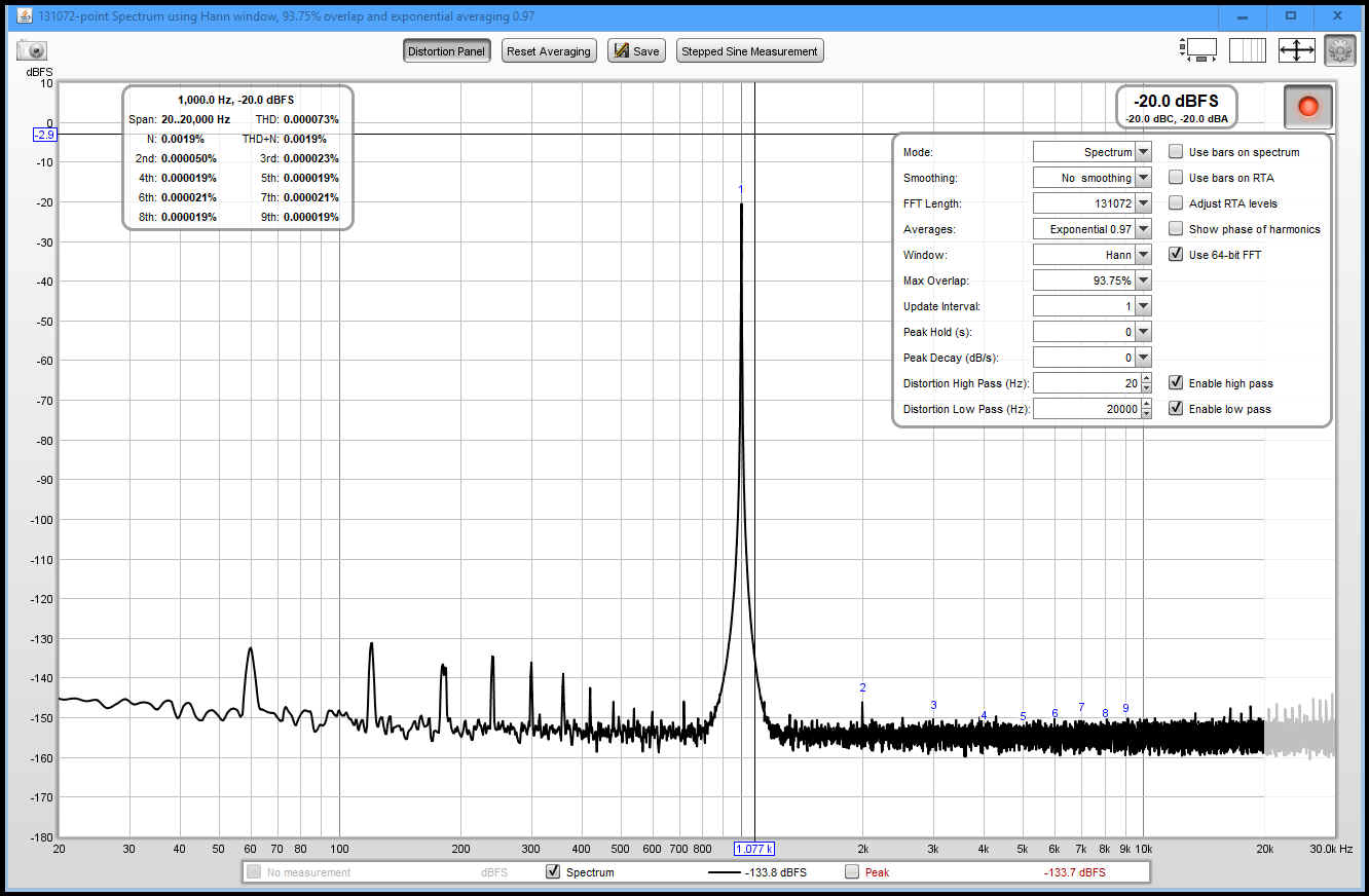

Spectrum Analyzer windowing
I'm unable to obtain similar performance results using MI vs Room Equalization Wizard. None of the FFT window settings in MI result in a narrow bandwidth rendering of the carrier when a pure 1 kHz tone is looped back into the RTX6001 on channel 0. Each of the MI window settings changes the shape of the carrier, but they're all much wider than I'm accustomed to seeing in other programs such as REW, ARTA and my own custom applications.
The reported THD is degraded in MI vs REW and ARTA. REW and MI are both restricting distortion calculations within the 20-20kHz band. REW is broadband, so its figures are slightly and expectedly higher.
Perhaps I'm improperly configuring MI. Please review the attached screen shots and diagnose.

MI has a few differences in its operation from the other programs you showed. Key first step when looking at spectrum is that you need to go to the waveform display and change the duration. You probably need 1 second (lower left option when waveform is selected) as a starting point. Then it collects 1 second worth of samples and processes the selected FFT size from that set of samples. If you select say 262K and you are sampling at 192K you should select a longer sample time (2 sec.) to get enough samples or it fills in with zeros. It's probably collecting more like .1 second and doesn't have enough info to get the selected resolution.

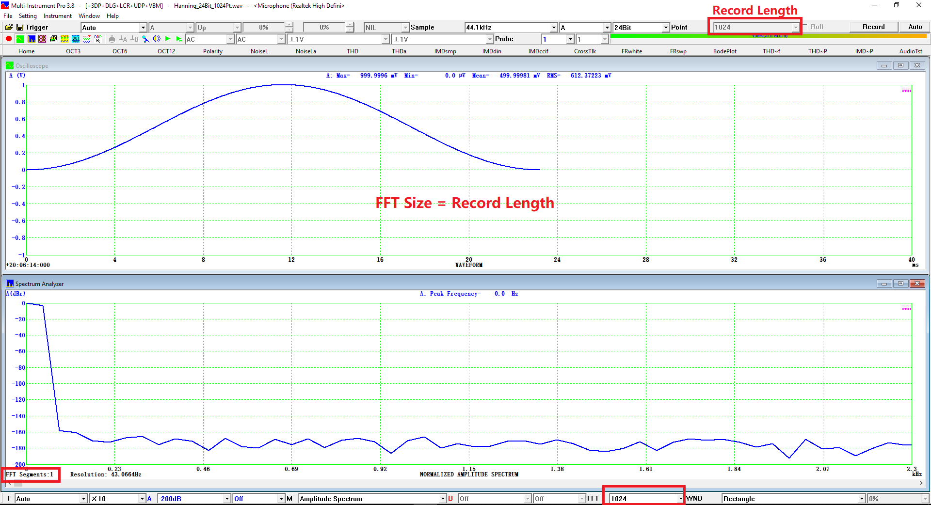

Record Length vs FFT Size
In Multi-Instrument, Record Length is the number of samples in the oscilloscope. The data sampling length is based on the Record Length not FFT size. FFT size is a parameter for analysis only. Record Length determines the max. frequency resolution achievable while FFT size determines the apparent frequency resolution. For example, if the Record Length is 2s, then the max. frequency resolution achievable is 1/2s = 0.5Hz. Whether it is achieved or not depends on the apparent frequency resolution, which is equal to [Sampling Frequency] / [FFT size] and is displayed at the lower left corner of the spectrum analyzer.
To change the Record Length, click anywhere within the oscilloscope window and select the T range at the lower left corner of the screen.
While other software might force [Record Length] = [FFT Size] to keep things simple, MI gives more weight to flexibility. It allows the following three configurations:
1. When [FFT size] > [Record Length], Number of FFT segments <1, thus zero padding will be used in the analysis.
2. When [FFT size] = [Record Length], Number of FFT segments =1.
3. When [FFT size] < [Record Length], Number of FFT segments >1, intra-frame average will be used in the analysis.
Where [Number of FFT segments] = [Record Length] / [FFT size]. It is displayed at the lower left corner of the spectrum analyzer. All the above three are useful for some applications. Some brief explanation on this topic can be found in Section 6 of the Quick Start Guide for RTX6001 and MI integrated system (http://www.virtins.com/RTX6001-Multi-InstrumentQuickStartGuide.pdf).

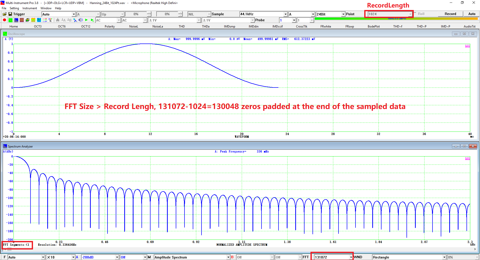

The following is an example showing that the above Case 1 (zero padding) is critical in some cases. In the \wav\window subdirectory of MI, there are 24-bit 1024-points wave files for 55 window functions. They can be loaded into MI to display their spectra. (Note that [Spectrum Analyzer Processing]>”Intra-Frame Processing”>”Remove DC” must be unticked for this case.)
The first screenshot shows a Hann Window with [FFT size] = [Record Length] = 1024, the resulting spectrum is very coarse and inaccurate.
The second screenshot shows Hann Window with [FFT size] (131072) >> [Record Length] (1024), the resulting spectrum is very good and as expected.
There are many other cases where forcing [FFT Size] = [Record Length] is really a limitation of the measurement system.
