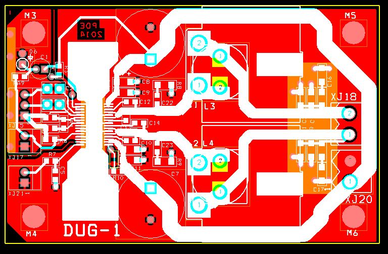

So far the changes form my original board layout are:
Input caps were 0805 are now 0805/1206/1210/through-hole @0.1"LS/0.037" holes.
power electrolytics were 0.4"dia/0.2"LS to 0.65"dia/0.3"LS mainly to accommodate higher output powers.
Power supply HF bypass were 0805, now are 1206.
Inductor footprint will take at least 5 different types and also has two sets of through holes.
Filter and snubber footprints (top side) are 1206 with exposed copper on the bottom ground plane for other larger parts.
Exposed copper below the input area for ground plane extension for those using really large input caps.
Startup mute circuitry.

Will your board incorporate the mod around AVCC that abraxalito did separating pin 17?
I am a little unclear as to the resulting power available from PBTL. The datasheet says "MONO mode enabling up to 100W output power" and the circuit diagram shows 100watt into 2 ohm. Do you get 100watt into 4 or 8 ohm or is tho output reduced? I assume the LC filter will need adjustment for the impedance being driven, is this designed on same basis as straight BTL amplifier?

In the other tread there was a link to another device TAS5756, amplifier part looks almost equal to 3118, but not sure if it is totally equal. With that in mind that chip that can process 25Mhz signals is decoupled with: 0.1uF+ 1uF+22uF+390uF (for PBTL). There are layout instructions in datasheet with maximum!!! distances for powersupply decoupling, I tried to measure and I think they are from mid solderpoint capacitor to chippin: max 2.5mm for 0.1uF, max ~6mm for 1uF, max ~7mm for 22uF and 10 to 12.5mm for 390uF. The first 2 positions on layout for DUG pbtl look ok, how far is the big elco away from chippins? BTW Now I am sure, I won't be using 1nF, closest to chip will be 0.1uF for me.

Pre filter the EVM module also has output connected through 330pf and 10 ohm to ground, that just happens to be connected to bootstrapcap too. Only board I recall that copied this is SMSL amp. What is supposed to be the function of this?
I have added the snubber directly on the outputs as in the ap note.
The R is 1206 and the C is 0805. (I am not using 0603 on this board)
Also probably the last change:
Avcc has been separated with a series R and bypass cap. (both 0805)
This will allow people to at least try this mod without hacking up the board. Anyone that does not wish to use it can either jumper the resistor or connect all three pins on the IC together.
