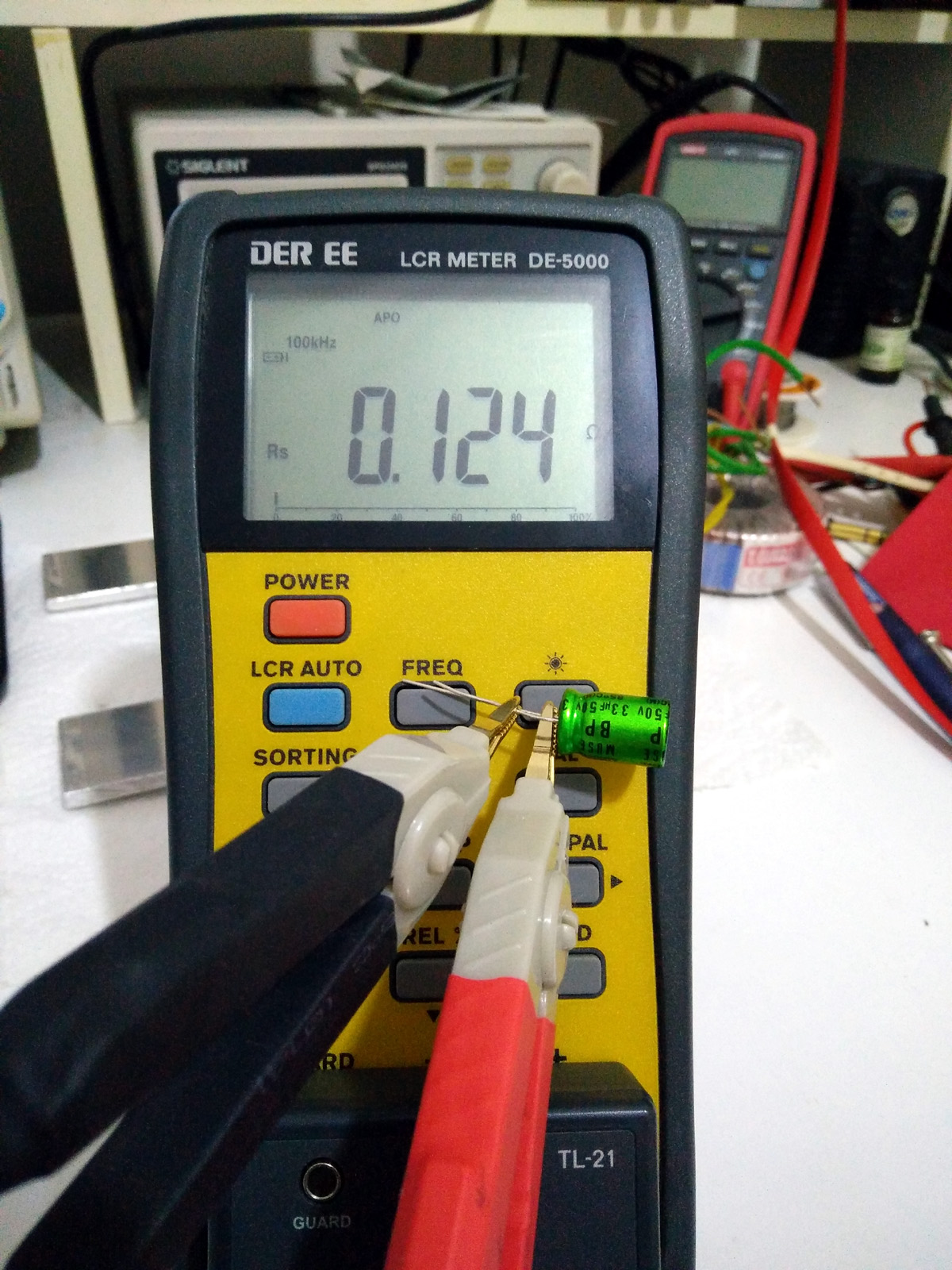

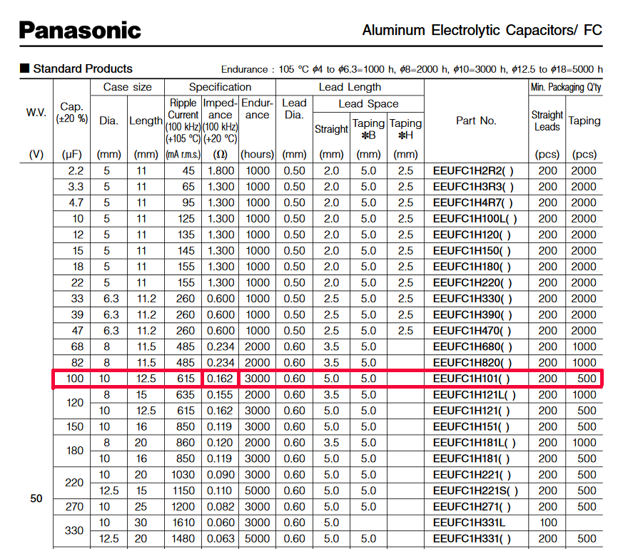

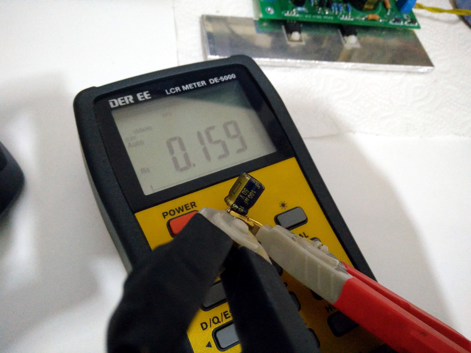

I don't know what tricks they do at Nichicon, but fact is for Pana FC 100uF/50V 10mm diameter I measure 0.116 1kHz DF when for ES BP 33uF/50V 0.042 (!) Even at 100Hz which is the realm of a PSU application capacitor the FC measures 0.032 DF but the ES BP 0.031 which still amazes when considering its having three times less capacitance than the FC even if it was equivalent PSU polar capacitor type to the FC (!)
Measuring 100kHZ Rs (ESR) for the 33/50 ES BP its 0.116 Ω but more for the 100/50 FC (!) 0.158 to 0.163 Ω (depending on sample (5pcs) and on how I handle the Kelvin clips)
Which is bang on the datasheet figure in Panasonic's FC case so thumbs up for their reliable published data. That one proves my calibration is reliable for measuring the Nichicon correctly too. No doubts there.

No difference between ES & UES I think, and apparently there is none more analytical datasheet. Its surprising how well the ES bipolar manages when a Panasonic FC 33uF/50V is reliably listed for 0.600Ω 100kHz impedance but I found a much lower 0.116-0.124Ω* 100kHz impedance in my ES (BP) 33uF/50V samples (!)
*depending on ambient temp and sample and/or the meter's set up details regarding ambient temp and the DIY Kelvin clips dressing (0.120Ω mean).

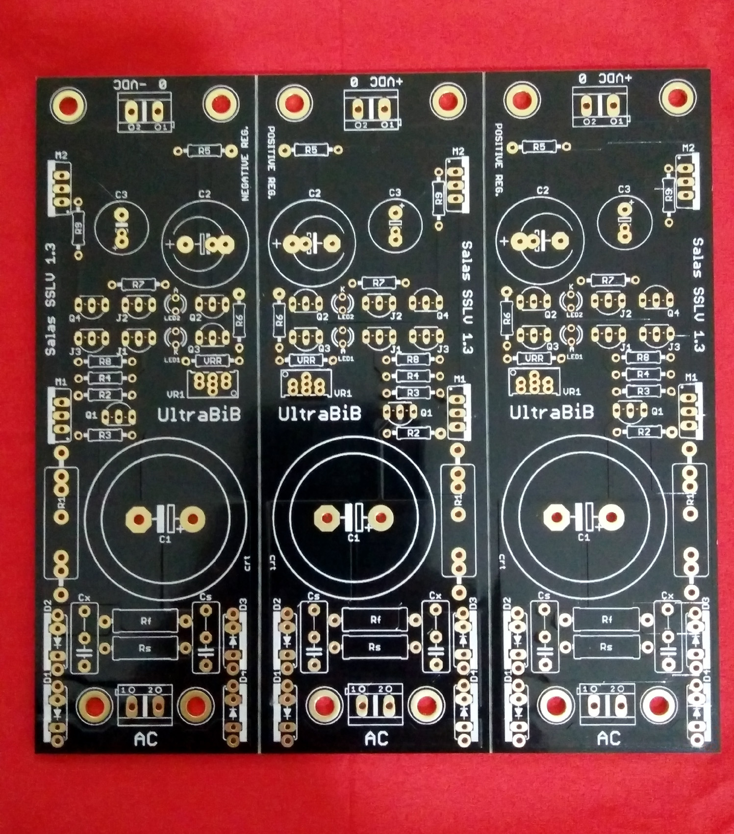

Finally got my boards today. Well done (the stripes on the right side are light effects, the print is clean everywhere). Thanks!
salas, why are there 3 boards? shouldnt there be 2? what is the purpose of the third board?

i just ordered all the parts in the exrtra section of this document and i calculated R1=2 ohm so i ordered vishay 2ohm 2 watt 1% (5 of them just to be safe). but then i realized that it doesnt specify positive or negative. so these extra parts is it for the positive or negative or both?
i just ordered all the parts in the exrtra section of this document and i calculated R1=2 ohm so i ordered vishay 10% (5 of them just to be safe). but then i realized that it doesnt specify positive or negative. so these extra parts is it for the postive or negative or both?
They are common to both polarities. For the most part, only transistors are of issue in +/- situation. However, the layout may change of course.
so i should have doubled the count?
One set would be needed for each section of the board. Note how the schematic legend supports this.
