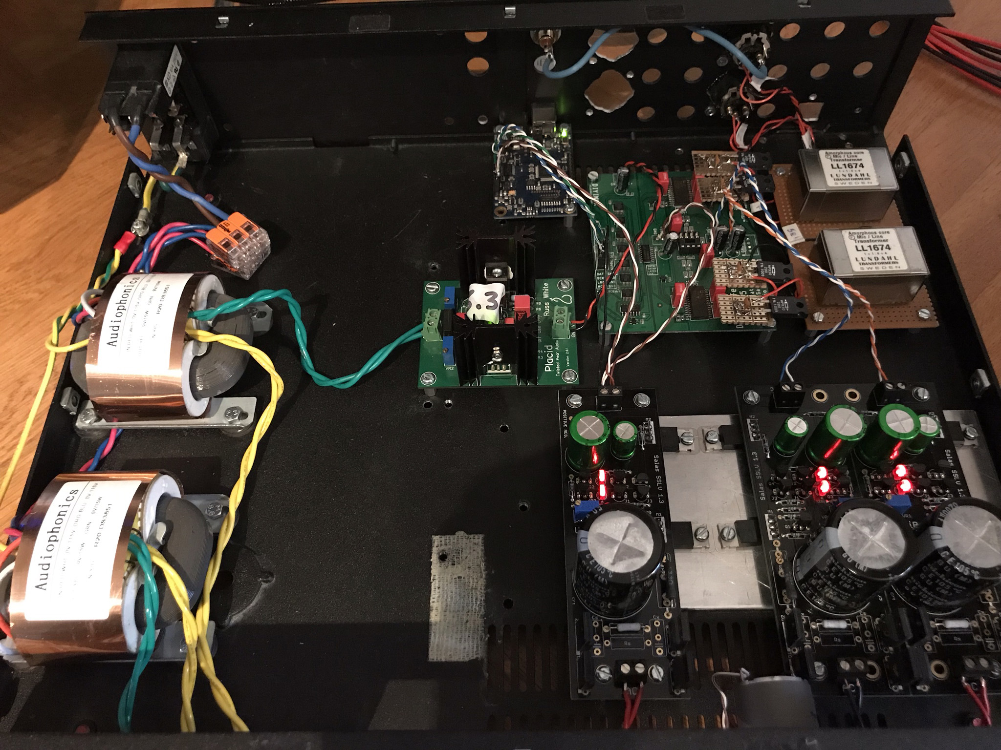

Have questions about Raspberry Pi feeding.
I'm finishing Katana DAC integration and use 4 Ultra BIB
1. +5V - 200mA - DAC
2. +5V - 120mA – Micro Controller
3.+5V - 1.15A – Raspberry Pi (RPI) with Isolator
4. +15/0/-15 - 200mA – Output stage with opamps
All 3 low current PSUs units are behave totally fine and DAC SQ is fantastic with these BIBs. I did not get yet to the critical listening sessions since it is not fully boxed, but it is already sounded nice in my bench-shop setup: YouTube
Now, #3 (Raspberry Pi) isn’t gives me a needed feed and RPI does not starts right. I have massages indicating Low Power issue and etc.
It works fine when I use 5V/3A wall-wart switch PSU. To be honest, and during troubleshooting, I connected my HP linear PSU to RPI (I set it to 5V and 3A CCS limit) and also RPI didn’t work correctly. It was consuming 0.8-0.9A during that test. PRI with Isolator current consumption must be about 1A based on manufacture “measured” advice.
So, my question is if you know someone who uses BIB v1.3 to feed RPI? May be Liniar PSUs and CCS shunts are not the best solutions for such applications when current consumption is widely fluctuates during different modes of operation. Please let me know you opinion.
Additional details:
Transformer is Talema 70060K - 7V/3.57A (parallel)
R1 is set to 0.56R 5W (MRA-5) – I measure 0.9-1A on R1 dining PRI connected as load after 1 min of board turned On.
Additional details:
I generally don't recommend CCSed shunt for mini computers. It seems they do fast bursting that asks for higher CCS setting and stronger transformer than initially thought from their suggested spec. That leads to high heat shunt PSU setting until workable. Maybe they are weird loads for phase also because not doing well even on your HP bench supply is curious. Try with R9 1k or 1.5k and boost the CCS setting also. Put another 0.56R on top. But use a stronger M1 type.
Nonetheless there is a persistent member who made UBiB work for RPI3: https://www.diyaudio.com/forums/pow...ultrabib-shunt-regulator-131.html#post5737249
