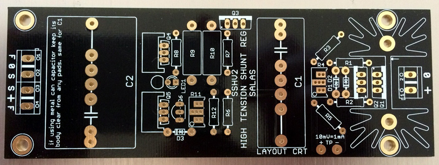

Good news, we made it in time with the board print details I wanted to update. I hope that C1 & C2 alternative parts size pads are clear now on which pads the capacitors legs must go. There is also a caution for remembering not to allow exposed metal can capacitors touch any pads under their bellies. Plus the TP pads show where to put the red and black DMM probes for proper polarity reading and advise the mV/mA interpretation. Such stuff may seem trivial but we had some confusions in the past. And I remembered to fix those points some time. I updated the guide content a little to the better I hope and put the fresh PCB photo in it too. Its on post#1 replacing the old pdf file.
