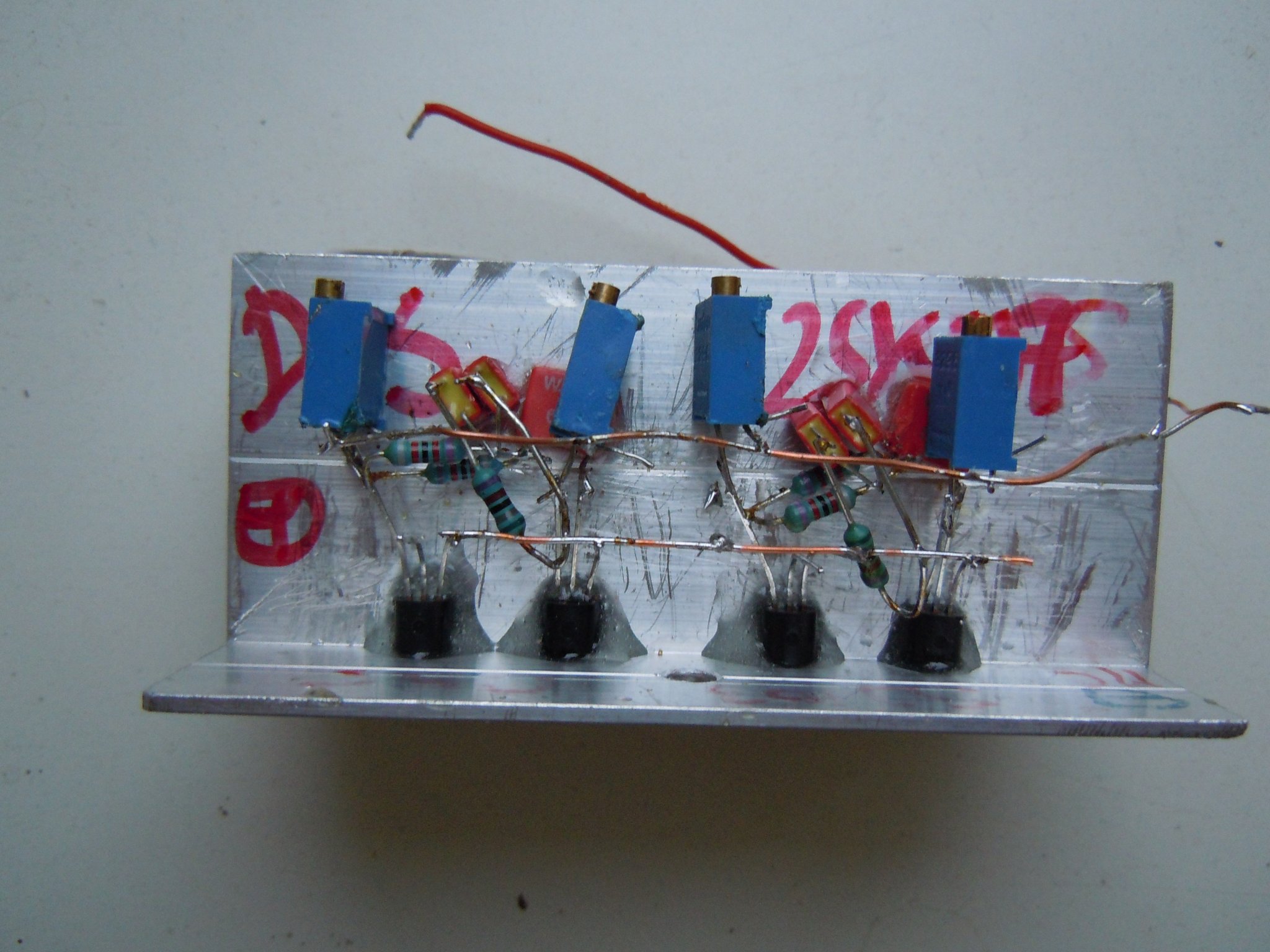

Salas RIAA is, may be, the best JFet-phono-amp!
Do not throw away the feasible best sound by, for example, circuit board construction.
And: trimmers usually sound better than resistors.
Use better capacitors than you see here. But these FMDs also sound quite good: just a bit more grainy, coarser than the best others. Use as small as possible: mica or polyester. NO WIMA MKPs or other fat gimmicks.
