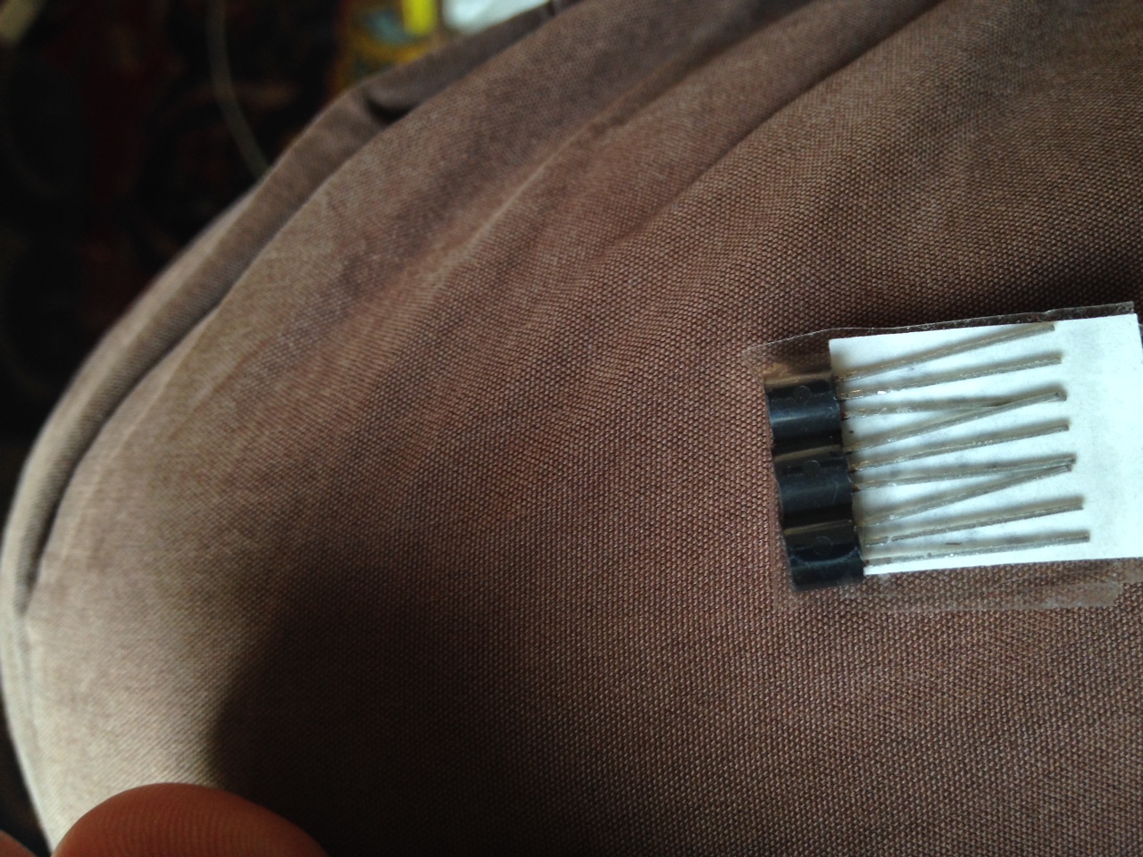

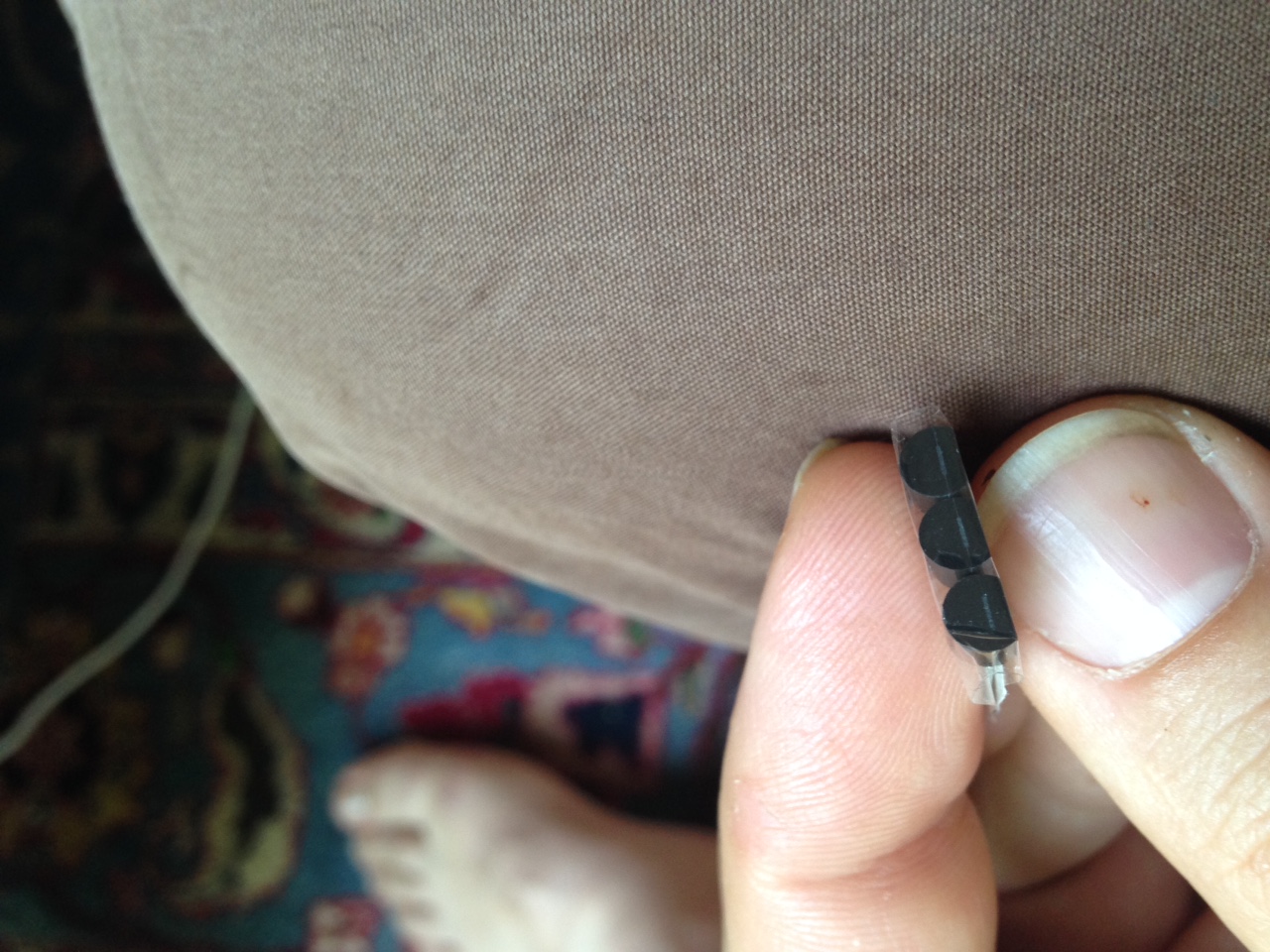

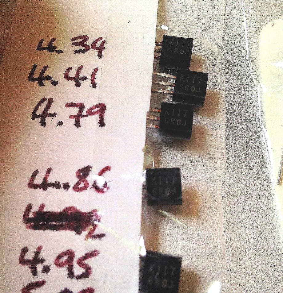

I have the K369 quad from the group buy, and matched K170s I have from way back (all good and tested!). The K117GR fets are from eBay, but I don't think they are faking those cheapies are they? The 2SA970BL is also eBay, but a good source from the UK.
Caps and resistors to buy mostly. Thinking PRP, Vishay and Mundorf (basic for shunt regs and Supreme for DC blockers.)
Yes they unfortunately fake those too. An Australian member that built a very nice valve preamp had all sorts of problems recently with K117GR fakes in SSHV2 HV power supplies for instance. When he replaced them with good ones all ills solved instantly. Show us a macro photo from your K117GR, many times we can say if fake just by looking. We could in that case too. Its not the end of the world if bad though. You may either ask Tea if he can spare a couple out of his minikits quota, or use two lowest IDSS K170BL within 1mA tolerance between them from your stash.
They've all been matched for IDSS by me, some months back, and so they're currently wrapped in sellotape with the results. I hope you can see if they're fake or not through the shiny tape. Let me know! Thanks...
