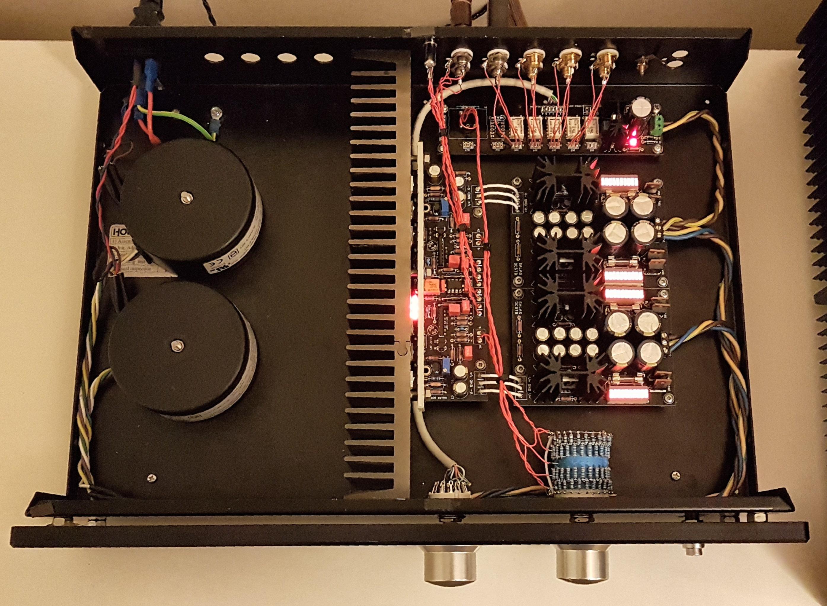

My dcg3 with I-select. AC tapping direct from one of the channels of the dcstb. No hum, noise, anything but pure good sound. Recommended.

I did a build very similar to Bambadoo - this is what I ordered from Tea-Bag:
I-Select x 1
I-Select Kit (no board) x 1
DCG-3 PreAmp board x 1
DCG-full kit (no board, includes transistor kit) x 1
DCSTB board - 2 sections x 1
DCSTB Full kit (No board, includes transistor kit) x 2
I ended up doing the build without the I-Select, plan to integrate that later.
Hope this helps.
