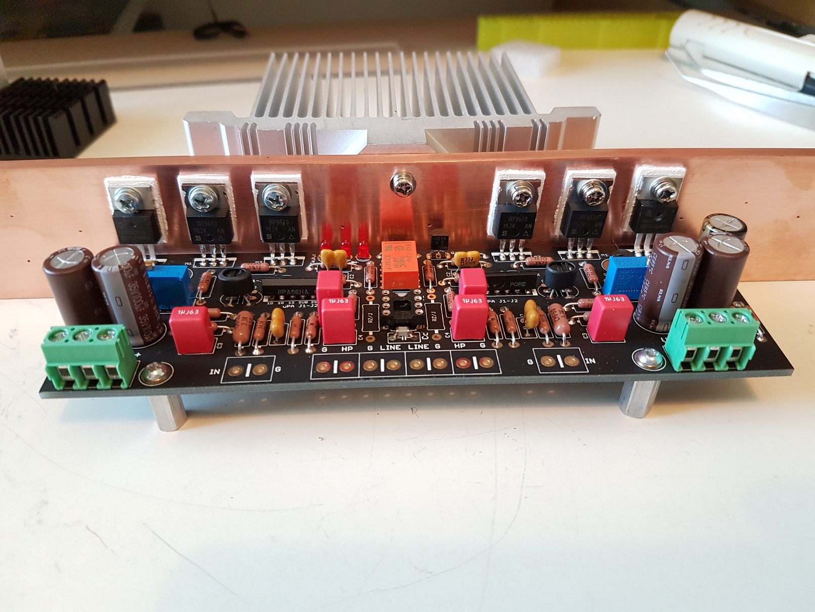

Hi Tea,
I'm starting to populate my boards and have a question on the orientation of the uPA68H.I see that there is a white line on one side on the board, the uPA's that I got in your kit have a small round mark with an "N" inside at one end on the side with the uPA68HA printed on it, Singapore is printed on the other side. Does the small round mark with the "N" in it face the white line on the board artwork ?
Thanks,
Paul

The left must face to you and the right to output transistors.
Be careful: Same orientation also for Q5

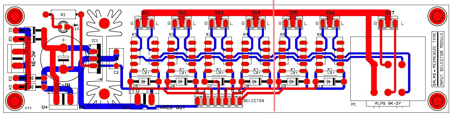

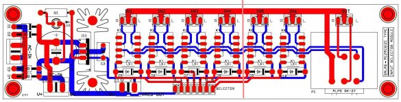

Hi Salas,
For layout reasons I want to cut the I-Select board between the 4th and 5th relays, similar to what you did in your build. Question: the board-to-pot ground appears to be an easy connection, but how did you take the signals from the I-Select board? From pins 3 and 8 on one of the relays? Or better to tap into the traces? Also, is a 220uf cap OK when DC fed?
Keith
I am not Tea, but here's an idea
That selector board has options and connectors. AC or DC powered. Run a straight DC feed to the selector board from a DCSTB's positive rail. Don't even populate the selector's rectifier diodes and use a 100uF capacitor for decoupling instead of its 2200uF reservoir. Not even a sink for the 7812. One relay only will be engaged for connecting an input. Talking just 10mA. Look in my preamp, no extra transformer. A DC feed +/0 twisted pair travels under the double floor and emerges under the selector's board DC in. OK it does not always have to be a Paris sewers ghost 😀 It can simply get nicely dressed on the surface and be better serviceable too.

Yes. As we count from the relay's side that faces the kickback protection diode, tap into the signals on the third row of pins up to the left and right side. Its easier than cleaning the narrow traces to create "end pads". They may come off in the end when reworking with wires on them. The aluminum bar for the Mosfets does not have to be that wide as in mine by the way. About 3cm width will suffice (an inch+). Its helpful as local heat absorbing mass but on thicker chassis than my cheapo box it can be possibly skipped. At 100mA bias at least.
