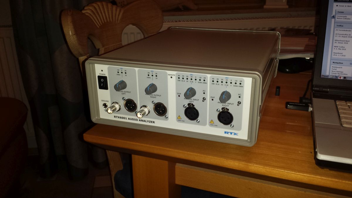

Been using my RTX to test a very low noise and THD analogue active crossover I designed. RTX (and X over) results are impressive. Done many hours of very informative testing with usually no probs but occasionally, with no change in the physical test set up, I loose L & R analogue output (L &R inputs still OK) signals for no particular reason. I use AudioTester so could of course be that or something on the PC. Previously to fix it I have reset PC and RTX and twiddled a few AudioTester settings on and off and it recovered (don't ask me exactly what I did it was a bit suck it and see).
Anyway question is: is there an easy way to identify if the problem is the RTX or the PC / Audiotester as the test set up is currently not working and no amount of resets seem to cure it this time (will try reinstalling RTX SW and ASIO as cant think of anything else).

Do now have it running without reinstalling ASIO or RTX SW (reset seems to have eventually done it) but in anticipation of it happening again would still like to know if there is an easy way to know if its the PC / Audiotester or the RTX.
Hi etlasr,
Try and play some music through it if you have an amplifier available. Just play any digital file, or even the PC sounds. Change the sound device in the control panel.

Anatech, thanks for your suggestion. When ever i get the problem I do select one of the non ASIO (forget which one) DLL's in Audiotester and the test tone comes out of the PC speaker. Still learning the finer points of drivers and the like (I'm more of an analogue man than digital) but took that to indicate Audiotester was working, well at least locally on the PC.

That's fine. You could have a bad USB cable too.
