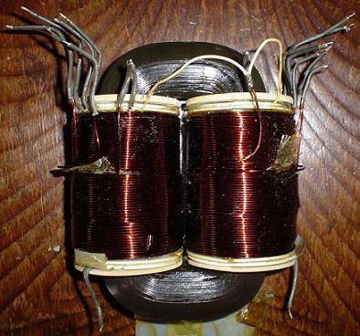

modified R-core
Hi Mihai,
ok, self customized - not bad.
I of course was talking about ready made ones. Found only some far east (custom made) with help of a very nice guy that took part in the pcb GB. Haven't bought so far. Modify the french one is pretty good idea 🙂
How much work? Did you separate core therefor? Think yuo have to. Would you mind telling wire diameter and number of windings?
Cheers Ernst

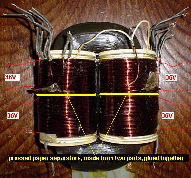

jacco vermeulen said:
Downside of R-cores is that the secondaries are wound on top of eachother.(the multiple parallel secondary versions)
Two secondaries on one arm of the core, bobin is splited in two sections, and the other two on the other arm.
No section is capacitive coupled with each other, well no highly coupled 😉. An electromagnetic shield separate primary and secondary windings
Re: modified R-core
I don't remember, but i think it was around 0.2mm diameter.
The number of windings per volt is pretty easy to find. Just count the number of windings when you dismantle the secondaries and divide this number at 12 (the idle voltage)
Cheers Ernst
