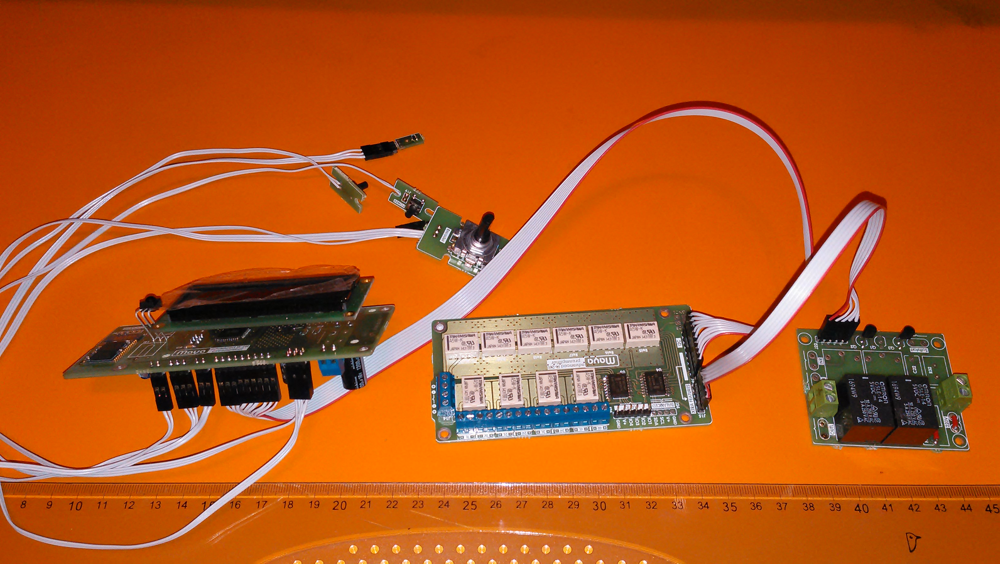

Hi to all.
Just I have finished my case of R2R with DCB1 buffer stage.
I have used another encoder (PEC16-42AAF-S0024 Bourns | Mouser) because I wanted the push switch function for menu.
I see a different working behavior now, than original kit encoder.
I don't know if I have damaged the encoder, but there is no linearity to decrease or increase volume. Sometimes working well, sometimes jumps up or down in reverse order.
Is there any alternative encoder like original that kit used with push switch?

I actually encounter this with the stock encoder if I change the volume too fast. I thought it was a debounce thing. Tibi can you share how to use capacitors to decouple? I actually intend to use one with a push button to make it cleaner on the front panel.

Use your oscilloscope to see any possible spikes on the encoder you just purchased and add proper caps for decoupling.
Each encoder have different capacitive decoupling values. Some do not need decoupling.
Tibi
Tibi, just a 47pF decoupling smd capacitors and the problem has gone!

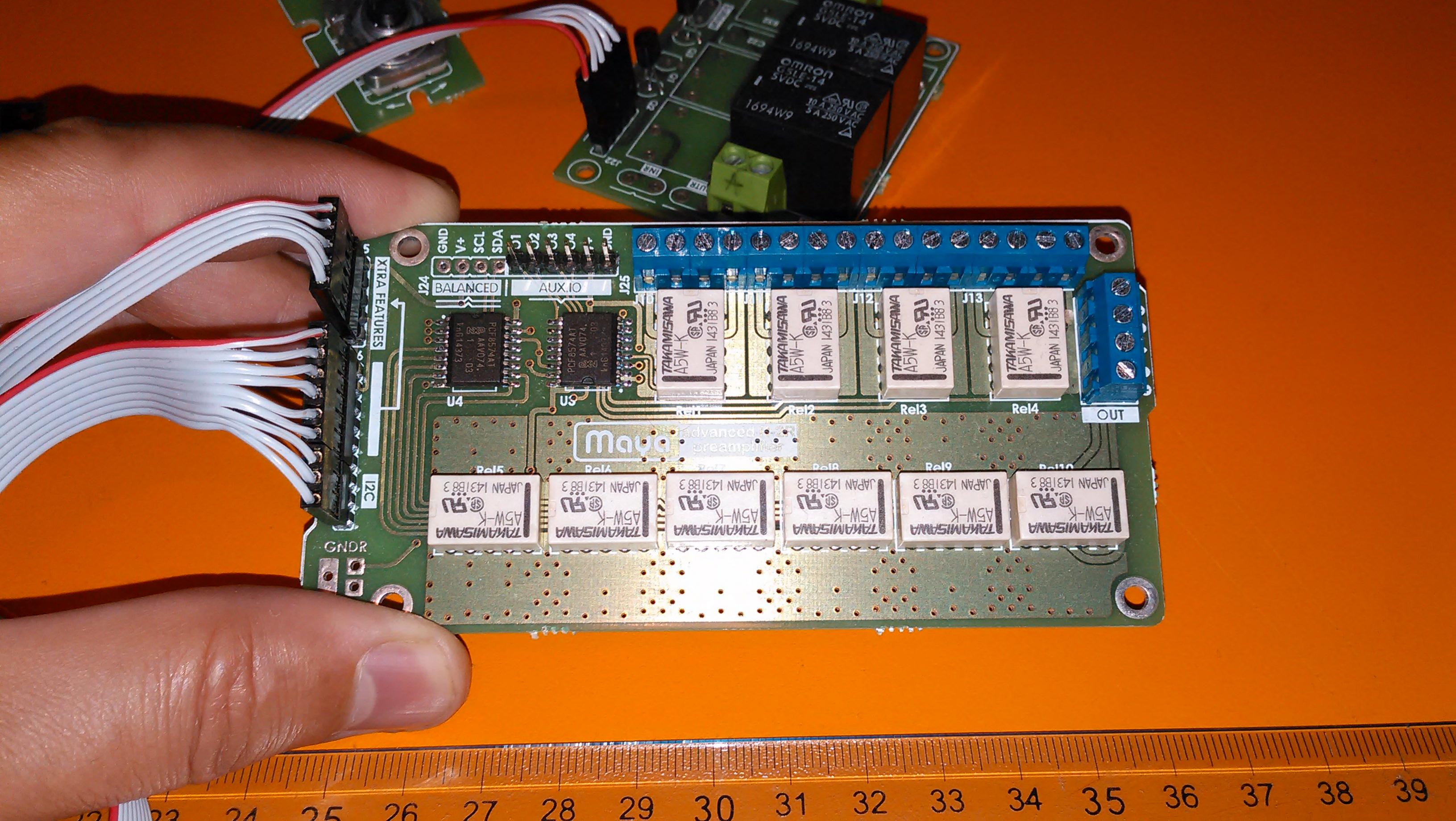

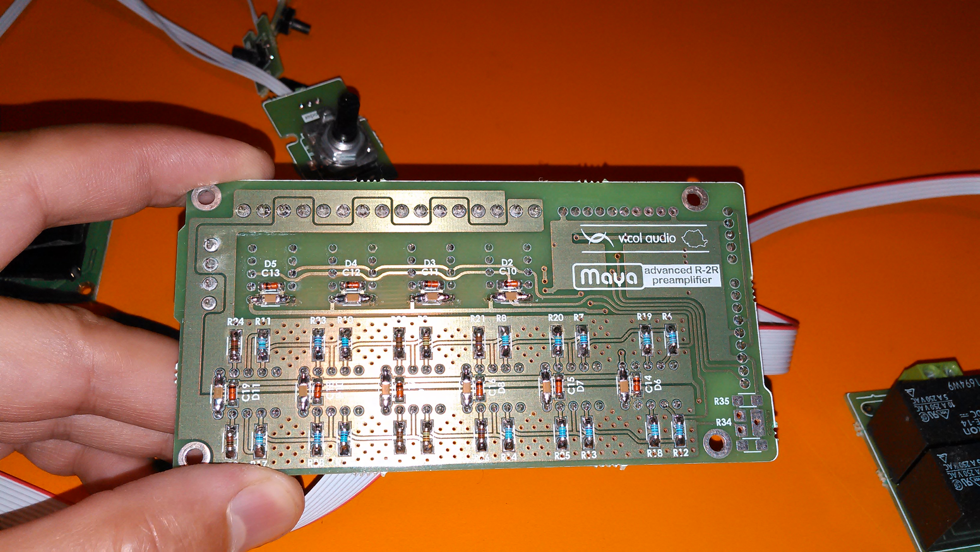

Would you mind share some pictures for us? Besides, how do you wire between R2R with DCB1? Thanks!

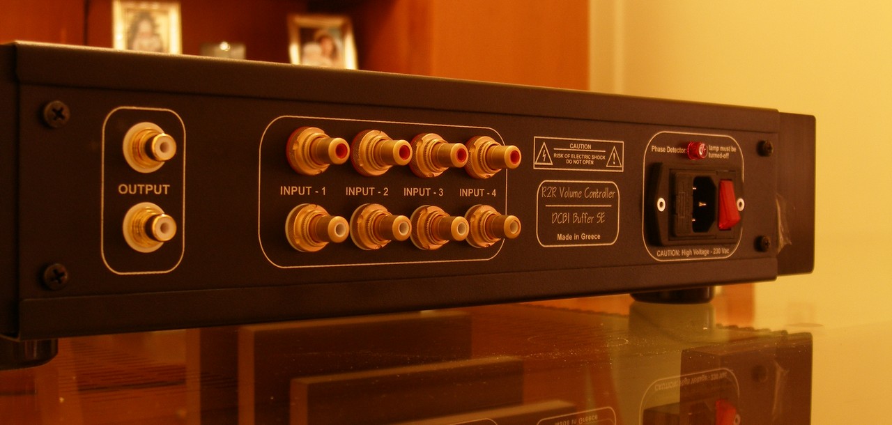

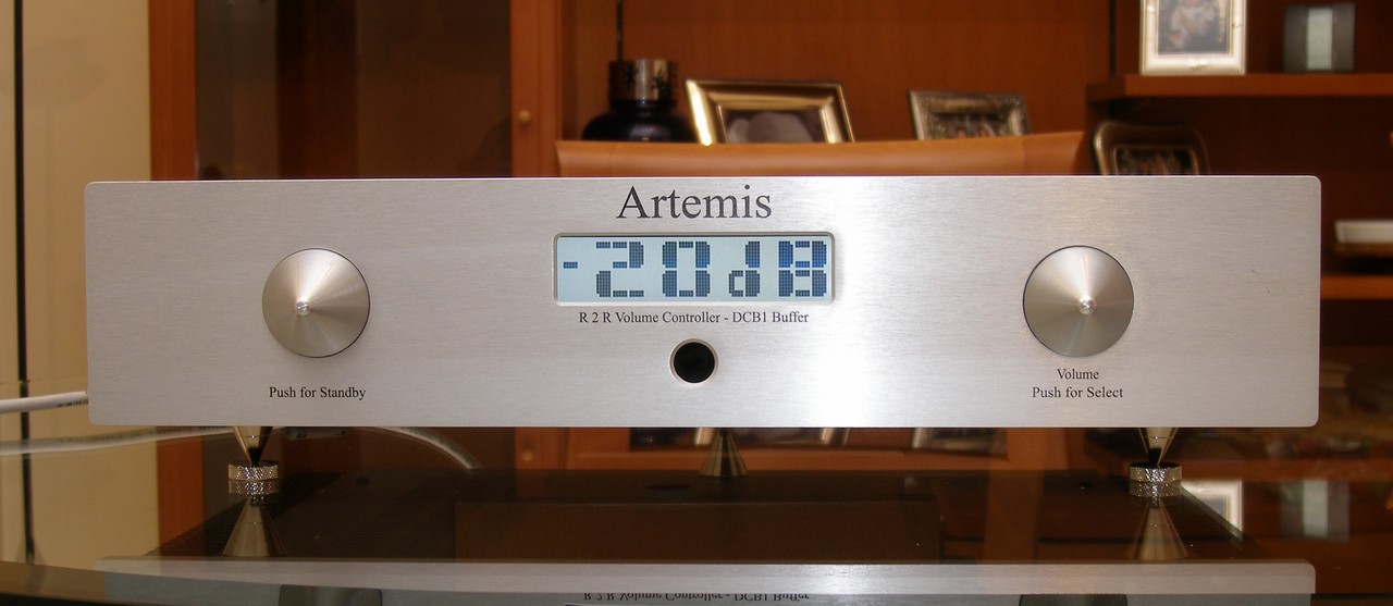

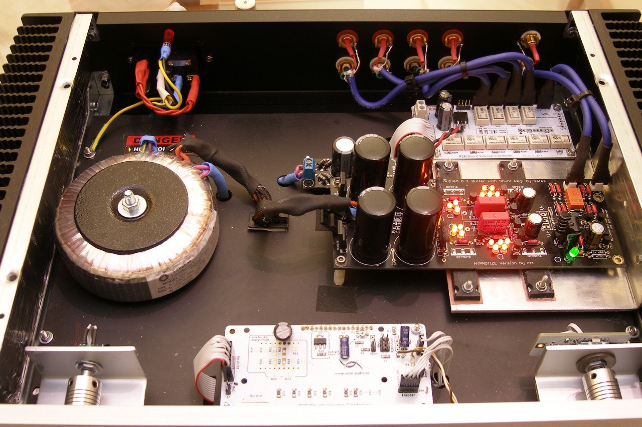

Sorry, I am late to answer about your questions, but I don't make something special, just the 4pin output of R2R going to 3pin input of DCB1 (hypnotize edition).
I have some photos about it and the construction.

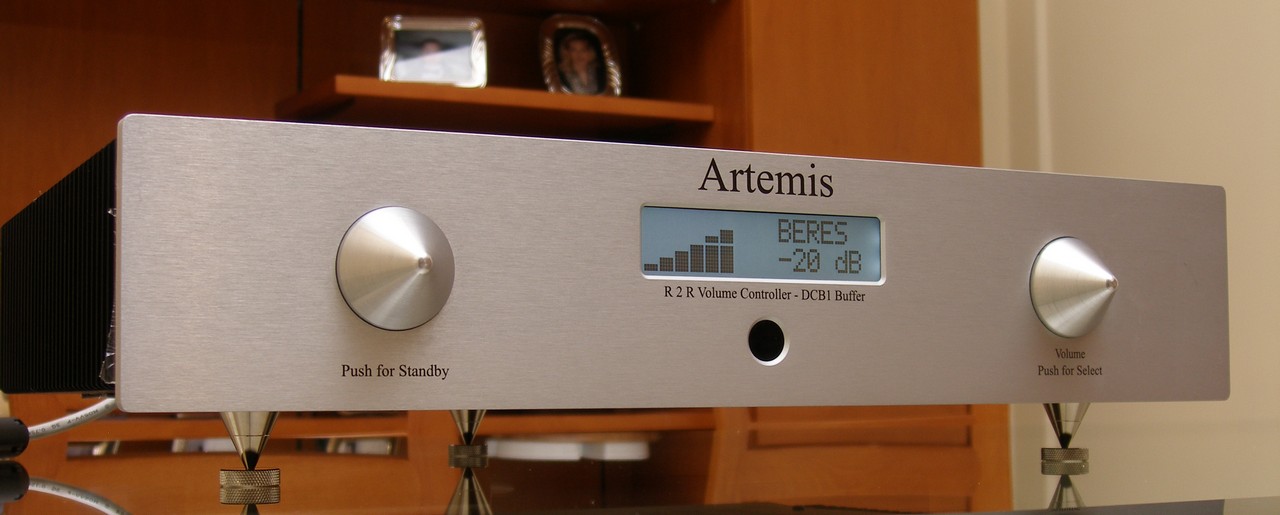

Salas, as you know the "Artemis" is a name of the Greek Mythology.
The main personal characteristics of Artemis (Άρτεμις) according to Greek Mythology was :
- "pure" = pure diy
- "demand personality" = demand design
- "non forgiveness" = absolutely transparent sound with no color!
- "elegance" = harmony design
- "unswerving behavior" = stability function and operation
The combination of Vicol R2R Controller with Salas DCB1 buffer, gives to me the main characteristics of Artemis personality.
The knobs aren't from a catalog, they are hand made (lathe machine ... if that is the right term)...I would like to approach my Aaron final amp look.
I knew she was the twin sister of Apollo, goddess protector of hunt and the wilderness mainly but I did not know all those other things. Alright, very philosophical naming. Nonetheless well executed in practice also. Enjoy it. :up:

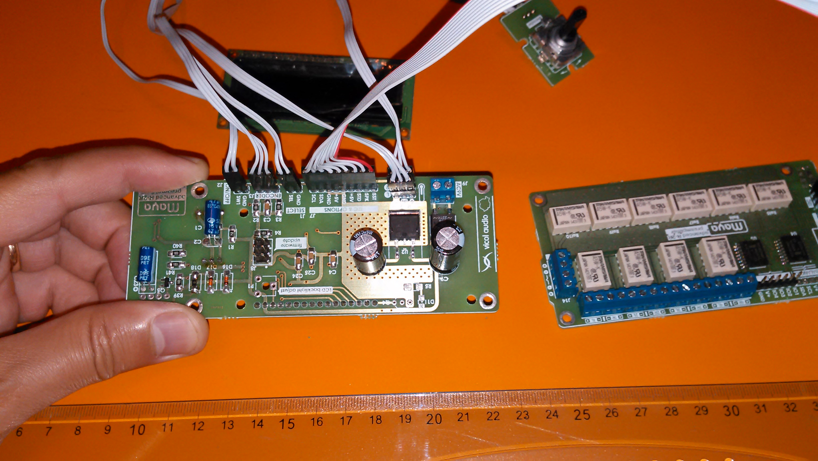

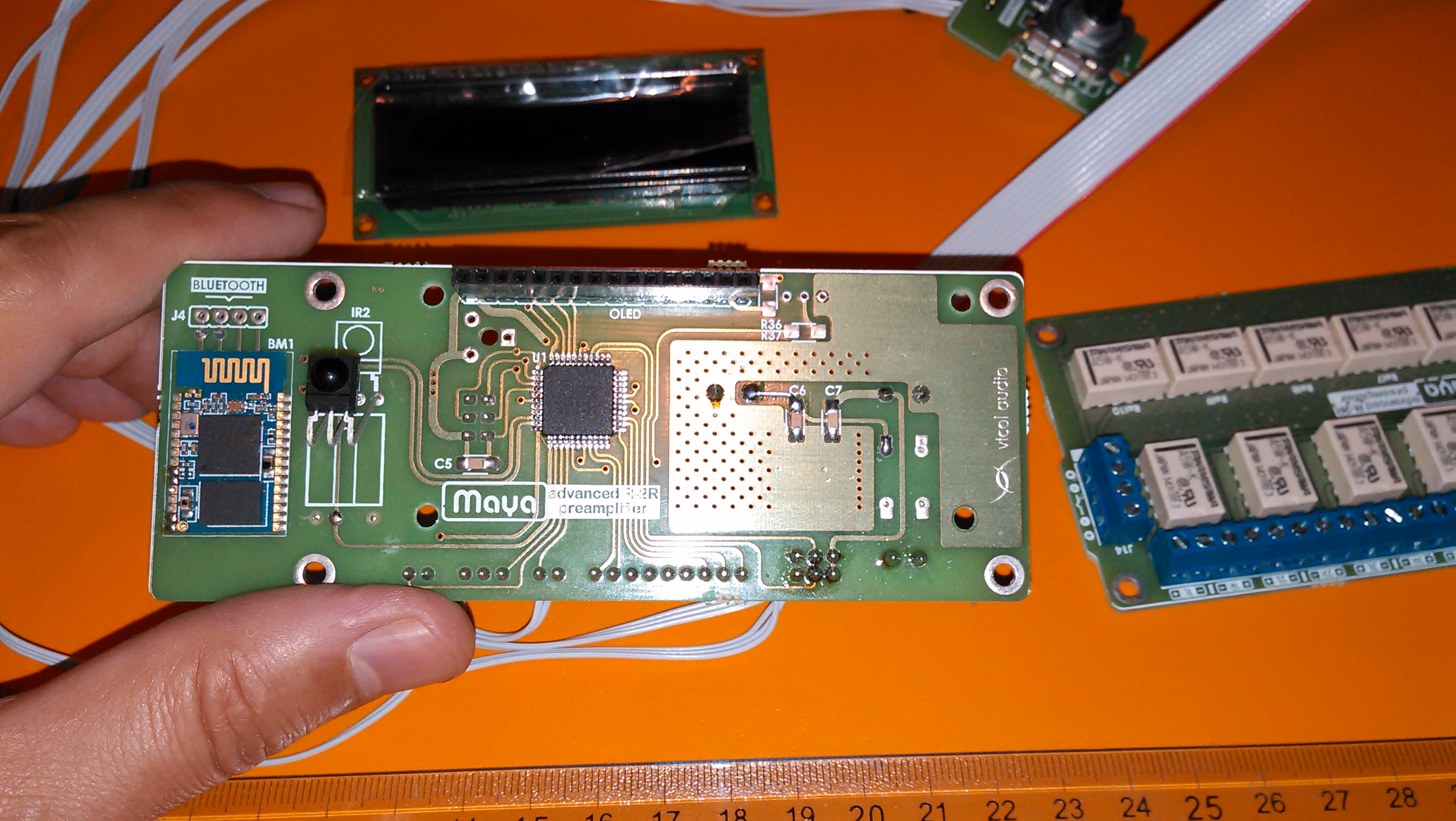

Here are few pictures with Maya.
I'll try to make a short movie with full operation to see the beast at work. 😀
