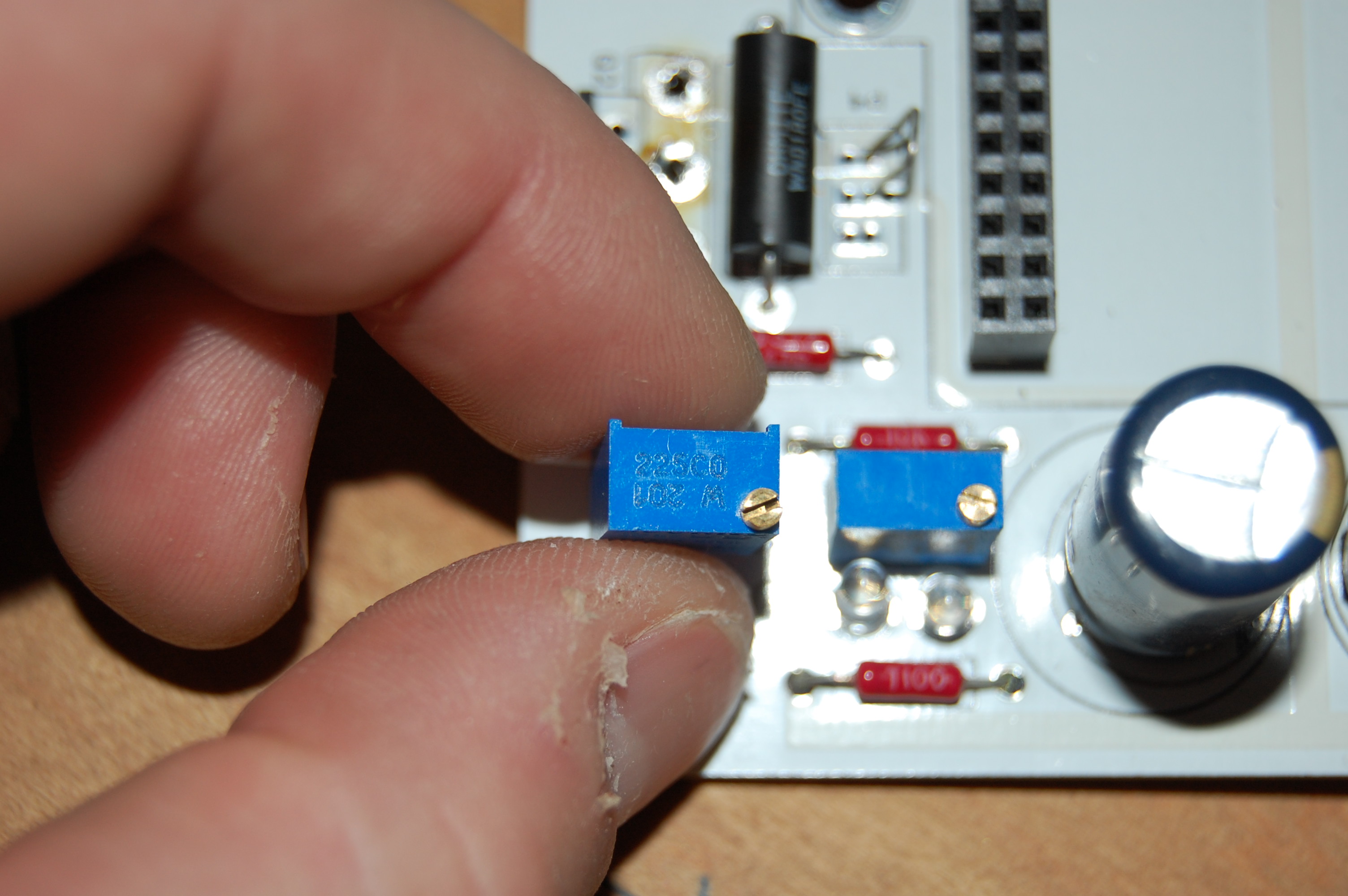

I don't think it's a big deal. Panasonic FM spec very well, so I will switch to them. I am using 3299 pots as they have dual wipers. Switching Rs values is not a big deal. It can be done according to request. The use of panasonics should save a couple dollars.
We will use KZ (Muse). This will drop $6 off the price. The Cinemags are $26.5. Big savings there will be the shipping.
3299 is larger than 3296. The back alley talk is that it is due to dual wiper, reliability, yada yada. I can post a pic if its helpful. If the pitchforks come out, Ill use the 3296😀

Using Kz instead of ELna Silmic II brings the kit price to $57 for a stereo pair. The Cinemag transformers will add $53. If turn out for them is really good, over 50 pieces, the price will drop to outstanding $51. Here is a pic of the mighty 3299 pot. Mack daddy of all pots.
Using the 3296 will save $2 off total kit price, as they are $.25 cheaper than 3299
