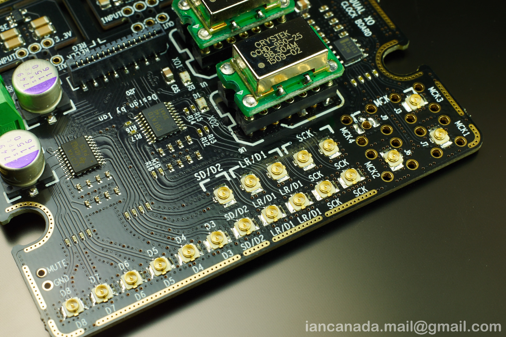

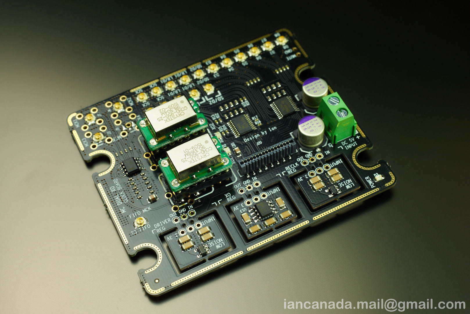

MultiChannelClockBoard by Ian, on Flickr
