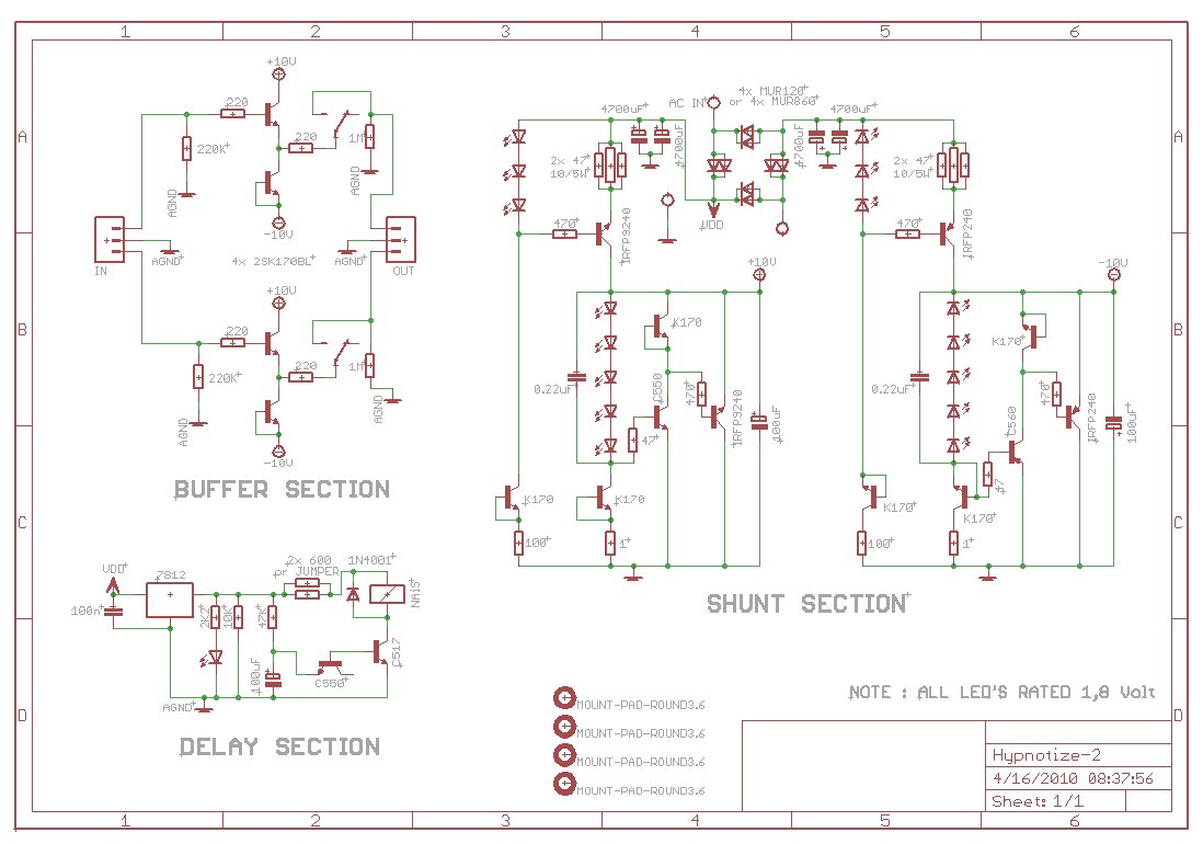

hey guys, with so many versions getting about, where would I find the BOM and schematic for the D1 (symmetric) found in a varied form here I just bought a couple of PCBs and apparently it follows the regular D1 schematic and parts (though some values have been altered for use with the sabre dac)

D1 is a DAC, and what you bought is the i/v stage from the DAC.
ah IC, no wonder. I know I only bought the IV, thats all I wanted as its going on the ackodac. I just thought it was yet another acronym. so I need the D1B1 of course, but which BOM do I use? from pierre's post I gathered he has been using this on his buffalo v1 for some time, so I didnt think it could be owen's BOM and schematic, but maybe i'm wrong. guess i'll just wait for pierre's reply on the matter.
he said to see the D1 BOM specifically, so you cant realy blame my confusiuon. so I guess I just use the D1 BOM, but only use the buffer section?

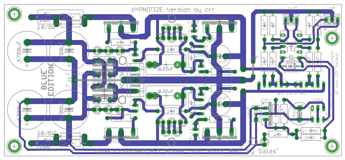

I cooperated further with CRT and this is the outcome. It has beefed up PSU for more uF by paralleling filter caps, and TO-220 diodes option. That will make it better when running high current and will take advantage of the thicker copper pcb planned. Big Rset places for hot current users too. Its also turned around for having the PSU to its left as the standard goes. J1,J2 jumper designation for those who tend to forget, and orthodox plus side Vref Jfet connection since the higher current offsets the unorthodox connection's subjective benefit to its most in my experience. That will give intuitive results for +/- Vout for builders also. Jfets will go in as is if used for regs only too. Film caps mod for string of 5 bypass also of course. Roughly 155mm X 68mm. It looks OK to me, we need one proto so to know all will work out fine in production though, and see about costs, because we want to make it double the previous copper thickness, plated holes for sturdy pads which count as double layer pcb cost, and its bigger. The repeatable fine sound quality reports so far by so many builders, plus the quality resistors, best caps, LSPDs, switcher pots, silver cabling, expensive RCA terminals used etc, probably deserve no skimping for the special edition board. The beefier rectification and filter section plus heavier copper, will come handy to those using it as a high current shunt reg platform only too. More news, when there will be.
P.S. I am including the CCT again for review against layout, maybe I missed some error and could be pointed out by the keen eyed among you sooner than trouble.

I cannot evaluate film cap bypass pitch correctly, but I presume it's 10, 12.5 and 15 mm.
IMHO it should be 5, 10 and 15 mm which are the most frequent std pitch for film caps. 5 mm can be useful for Elcaps too.
I would use 15 mm pitch for std Rset too. Now there's space enough. Doing so people can accomodate a pair of 2 watt resistor. 17.5 mm for 3 watt like the very common blue Pana.
Moreover the pads for the two 600 ohms resistors (to be used with 5 or 6 V relays) can be joined by a track: no jumper required for 12 V relay, cut the track and insert resistors for 5 or 6 V relay.
Can I suggest:
Leave the hole spacing and diameter at the end of the power supply big enough to take a 3 pin terminal just like the one for AC input?
It would be handy for anyone using it as a supply only.
Fran
.... and maybe add two more mounting holes (difficult with the existing layout) if somebody would like to cut the board.
If you're going to do that, might as well do 4 more holes and add a score line on the top side 🙂

The layout details are on crt and I don't know his eagle constrains or free time, but this is his 3rd attempt on blue. Will send him a link with your extra suggestions, maybe he can/will do something in time or not, but the Gerber is produced and Tea has to arrange for a proto in due time.
