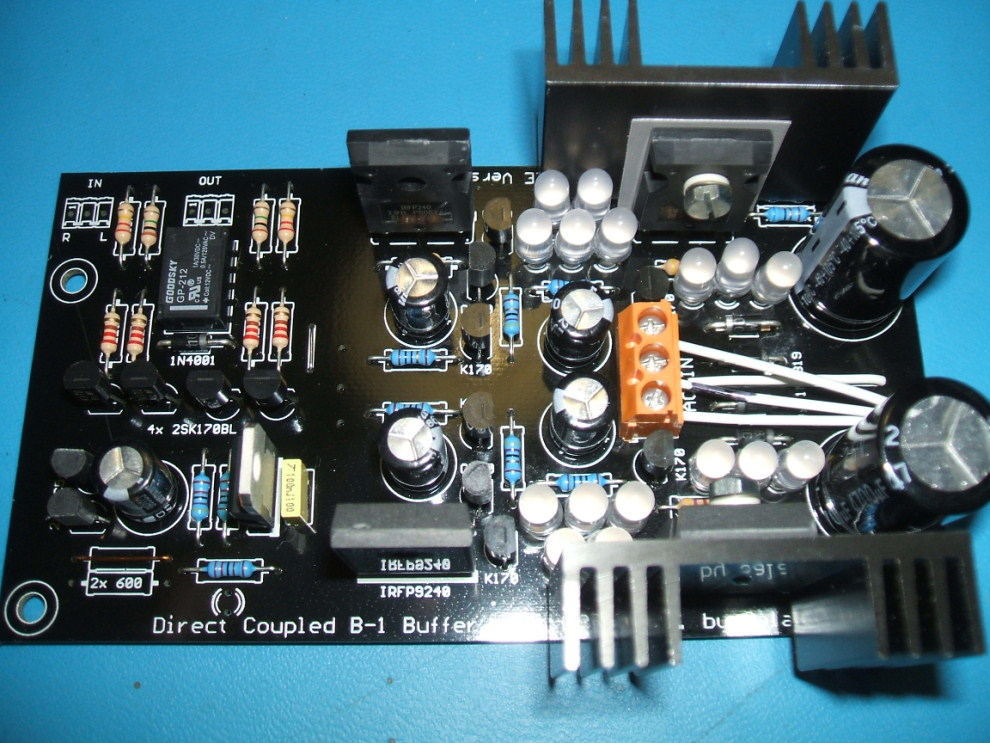

It sure is a nice piece of gear! In my budget system, I use a PC as source, with a DIYparadise USB dac, Lightspeed clone, Tripath TA2020 and FR speakers (Lotus from the Spawn family). I have a long interconnect from the Lightspeed to the Tripath amp, about 5m (15ft). I connected this buffer right after the Lightspeed, and before the long interconnect. It has restored some lost detail, well a lot of detail in fact. It also lifted the volume but I think that is due to better impedance matching as there is no gain as I understand it.
It was sounding a bit edgy at first, but after a few hours it started to come good. The PCB had been powered up approx 15 hours with no music before this though. I used carbon resistors where specified, and low ESR caps, but no boutique parts as yet. The other reason I was interested in this board is that my dac uses +12V and +18V DC supplies, and it appears that this PCB could accomodate that without too much trouble. (I will wait for the GB to try that).
Very happy camper here...this is the best quality I have ever heard out of this system. I thought it was pretty good before, but now it's better 🙂 Sure puts a smile on my face.
Thanks again for sharing all your hard work Salas, Tea-bag and CRT. I really appreciate what you are doing.

You are welcome. Good soldering BTW. Enjoy!
Its nice it can improve the Lightspeed. Many were using it straight as a passive pre, but as you saw, still rules apply, and in some configurations, the signal power loss is tangible without a buffer. Also nice that it can do enough with plain vanilla components. Your most influential will be the shunt out 100uF capacitors and the audio side 220Rs and 220ks. Also I see nobody uses coaxial signal cable for the runs from DCB1S to RCAs. Try the thinner RG type coax available. In some environments you will appreciate it.
This one shot is a poser. Kinda cool and meaning business. Like ready to bust a rhyme.😀
