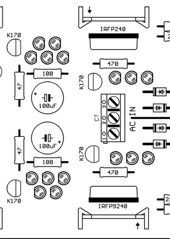

Crt, contacted me, he was on travel, and will do some more labels for the silkscreen layer very soon. 7812, 100nf, 1,2,3,4,5,6,Gnd for the selector.
Weird thing is that on his actual board, and on my Eagle 5.6.0 the Leds don't look like four symmetrical brackets, but appear as full leds with a straight and a round side with those brackets inside them. 😕
Maybe it goes down to the pcb maker's version and/or symbol library?:scratch1:
Tea-Bag can you ask them? I told Crt to maybe try another tell tale symbol for the Leds cathode orientation and we will see.
I think the Eagle to Gerber translation does this. It appears on all Gerber file output. I think even the one we sent direct to them from CRT (he in the end outputted to GERBER, but I am not sure if I deleted the specific message that forwarded that data from him from you. We likely need to use a different symbol, or the masses will have to get over it.
I think you will fine those missing brackets are on the Documentation layer 51. This layer is for printing (documentation) purposes and not used for the silkscreen. If you need them to be on the silkscreen then they should be moved to level 21.
Eagle uses layer 51 on lots of the components so it is not a good idea to routinely ask for layer 51 to be included on the silkscreen, especially on 2 layer PCBs. BTW: Level 51 is usually used when the graphics overlap the pads.

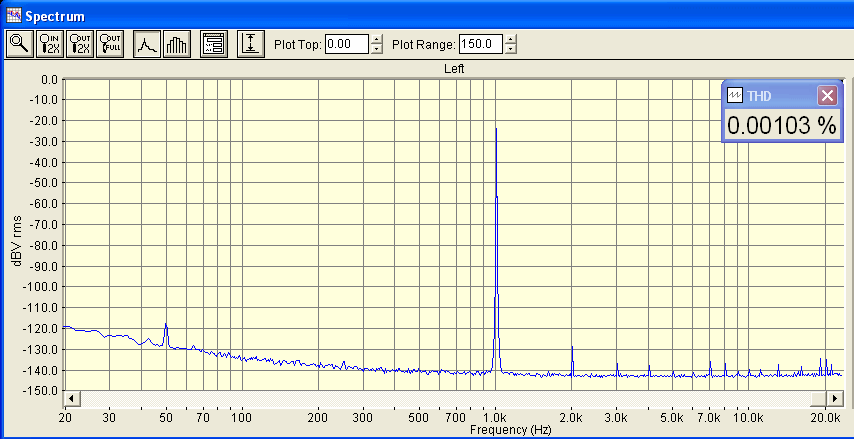

As for measuring its noise floor mentioned, here you are, see it attached. 0dB=1VRMS. The GB pcb version I will measure it again for you when I get the pcb copies here and get em done. The scope stuff has been shown from Ferds before. Same as I got. Refer to those posts.
