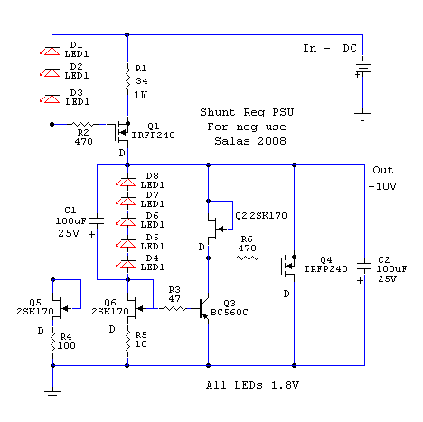

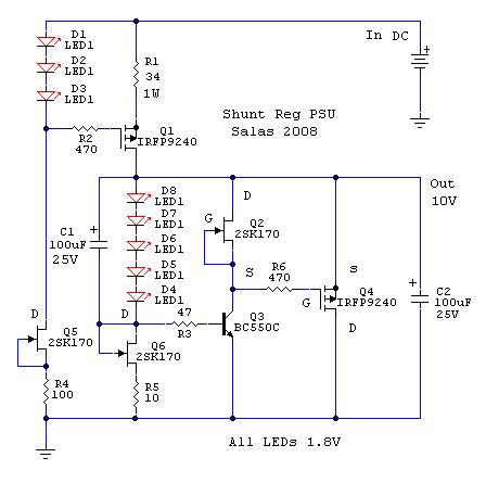

Thanks for your quick replythe yellow LED Vf is 1.8v to 2.5v, they can go to 5v for 2 in series as their maximum rating, my techer said LED is current source component that they actually not work in one Vf? I just increase the CCS current and they go to 5v, is that any problem if the CCS resistor is less than 22R, which is too much current to feed to the LSPD? or just not over 5v is OK? My current setting is 4.98v😱
They force feed nothing to the LSPD, no worries. The LSPD draws what it needs, the rest is shunted through them leds to ground. Hey, nobody here matched leds found with 2,5Vf with the battery method I suggested? 😀

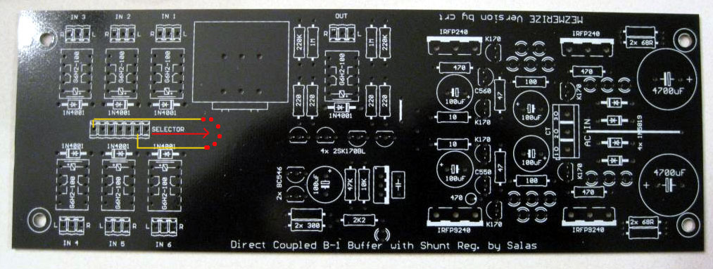

So, I finished building my Mesmerize board up last night. Everything went well. I have not put power to is yet as I finished up real late and want a set of fresh eyes to look everything over before I power it up.
Nitpicking comments about assembly... The holes for the 1/2 watt resistors were a bit small. The leads did go in, but they were a real PIA. LED orientation would be really nice to have marked on the board. About wiring the input selector switch. I haven't done that yet, and it is not clear how it should be done. It would be great to label + and - and input #
Otherwise it was a smooth build with no real significant issues. Nice work.

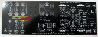

The right most pin on the selector connector is the ground, as you face the board, the last one towards the main circuits, near the word ''selector''. There goes the switching. All the other pins are for each position to select. Will ask Crt if he can do something about the labeling of the leds and the connector's header.
This relay is pin compatible.

Any reason to go with 5V vs 12V? Think we should just narrow it down to one choice.
IRT the LEDs I think orientation is always nice to have on the board.

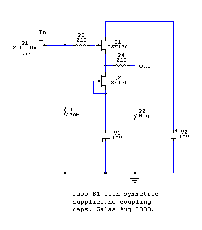

So we need to match 4 2SK170 and the Mosfets. Do the BC546 need to be matched? Should BC550 or BC560 compliment each other in any way or just stuff them in?
Lets say someone buys a few of these boards and sits on them for a few years and then cant find the BOM. That regulator not being labeled might be frustrating as well as the value of its cap.
The three holes in the center near the jumper could be labeled.

The reason is that 5V relays have been bought early from ebay by enough people, and its good to have 2 options, easier to hit some available deals. Its just a matter of using or not the Vdrop 300 or 600 resistors.
If you match everything, you are going to get nicely symmetrical voltage read outs, that mean nothing to the B1 performance. Some reg assymetry usually works towards lower DC offset in this case.
For the labeling suggestions I will email Crt, maybe he can enhance the labeling layer before final order. If he can't bother, I guess those things are a bit odd but not tragic. Has to have some degree of involvement, its DIY after all.
