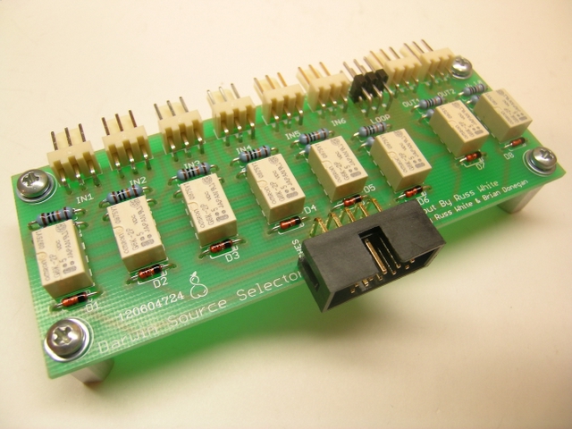

Yep, input'ouput headers would be really great. See the ones used here:
I don't know part numbers etc, but I'll email the TPA lads and I'm sure they'll give that info. What is the pin spacing on the current board does anyone know?

I've found Female and Male parts & refs at farnell's :
Male
http://fr.farnell.com/tyco-electronics-amp/640456-3/barette-mta-3v/dp/588581?Ntt=588581
Female
http://fr.farnell.com/tyco-electron...-de-connecteur-3-voies/dp/1098438?Ntt=1098438
Yes red color, why not ? 😎
Footprint is 2.54mm, straight parts not 90°.

Anyway, Brian at twisted pear has been more than helpful!! The standard seems to be 0.1"/2.54mm spacing, so it woud be a good idea to have that spacing on the PCB if possible. Is that possible?
The connector housing at mouser:
538-22-01-3037
http://ie.mouser.com/Search/Refine.aspx?Keyword=538-22-01-3037
crimp pins:
538-08-50-0114
http://ie.mouser.com/Search/Refine.aspx?Keyword=538-08-50-0114
and the 3 pin headers, first straight:
538-22-28-0030
http://ie.mouser.com/ProductDetail/Molex/22-28-0030/?qs=sGAEpiMZZMukXCIZ6E1E4C9w5F9bxKjZb1W2GGPACeA=
Now, they are Molex KK ones. If you shop around the mouser catalog a bit there are cheaper options and the non-polarised ones are a good bit cheaper, down to about 15c each or so
