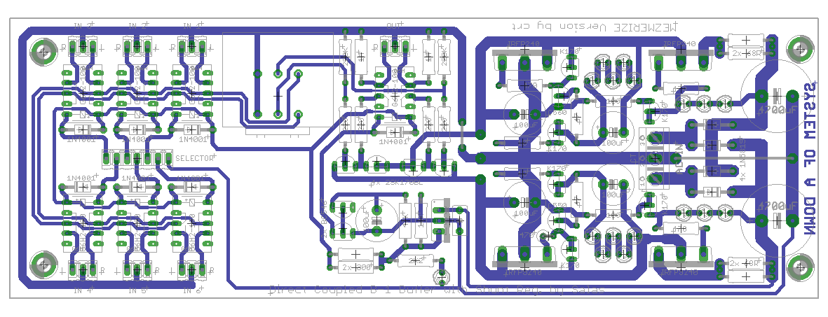

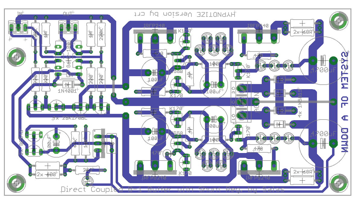

La Ode and I, we could not accept the fact that people's GB suffered.
So we silently cooperated and here they are!
Brand new boards, basic or fully 6 input relay switched, both with delay circuits, accepting 5V or 12V relays by the simple use of a couple of resistors or a jumper.
Both boards are single copper layer, hence they can be even more economic to make. I have the .brd Eagle format files (widely accepted by PCB makers).
Calling Ryssen et all to have a second look for mistakes, and if still interested, I will only send the .brd and schematic Eagle files to the new GB managers. You can then check with PCB makers if all is well and get quotes so to restart the GB.
CRT has done this for absolutely no personal gain, he even has DC B1 with shunts already as you know. It wasn't easy, we had to cooperate a lot. The guy is super. I congratulate him.
The only thing I want to suggest if the GB is resurrected, is to do the decent thing and the GB make for him a couple of free boards as a souvenir and a thanks.
He named the basic board ''HYPNOTIZE'' and the fully featured board ''MEZMERIZE'' inspired by his favorite band S.O.A.D
People, this is about as good as a simple solid state buffer can get. Enjoy.:cloud9:

Wow ... amazing ... thank you!
That is so cool!
I was also hoping to resurrect the GB with a new board design, but my schedule was going to be "sometime in the fall".
What a great thing to do! Thank you, thank you, thank you.
As soon as the wiki is back up I will up my order for boards to include crt's souvenirs.
WOOT!
I do not know if I have the resources, but whatever I can do to assist here in the US, let me know. Shipping to the US folks or whatever.
Thanks so very much for this. Now my 100 sk170's and 15 relays will be of use after all!!

Nice boards!

Salas, does the hypnotize have an issue still possibly with offset during power on/off as we discussed earlier?
I can front some money to have the boards made (cost pending of course) and can do some shipping. I am more uncertain about ordering quality boards and dealing with PCB manufacturers. Is pcbcore the way to go? I would be unsure about next steps if too many questions are asked. I would certainly order a small # first to make sure they work...
