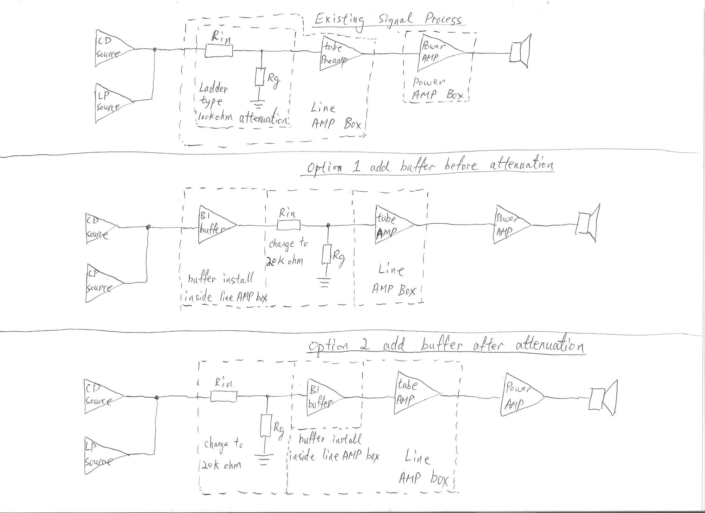

How to connect my B1 buffer
Hello there,
1) I attached my usage of DCB1 (Hipnotize version), however I don't know which option be chose ?

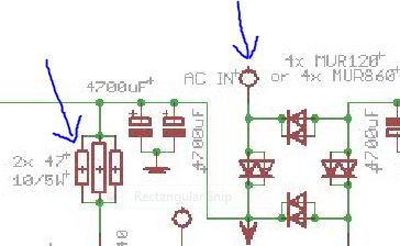

2) Another picture I am not sure these 3 resistors value and rating also the supply AC voltage for the board ?
Thanks for your kindly instructions.
CK

1. Option 2
2. Its either 47//47 for small DC current available (less heat) or one 10R 5W (more current, heat, more good sound). Use 2X15VAC transformer.
*This is a GB thread, please post technical questions to the build threads.
