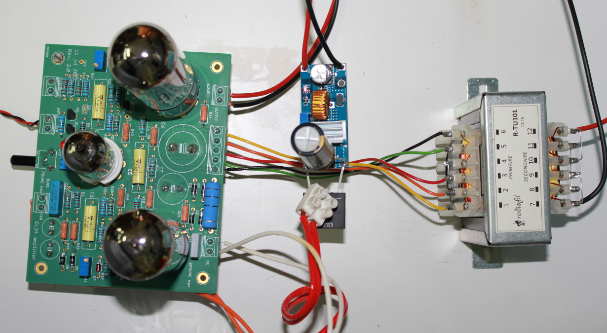

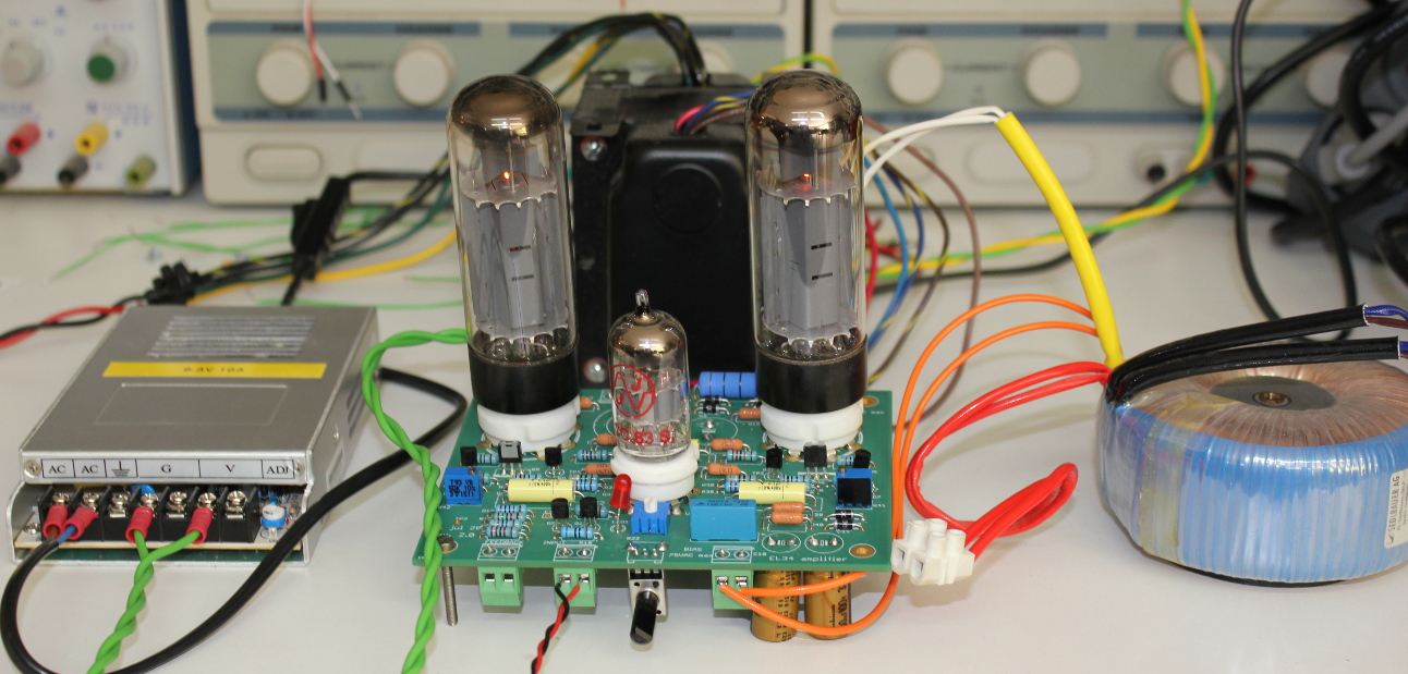

Power transformer
Hi Marc,
Thanks for your fast response....
Can you confirm that this secondaries are correct for an EL34 Baby Huey amp?
* One 225v ac at 400 ma....
*One 55v ac for bias.
*Two 9v ac at 9 amps for heaters.
Missing something?
Something wrong?
Regards
Jorge Castellano
Hi Marc,
Missing something?
Something wrong?
Regards
Jorge Castellano

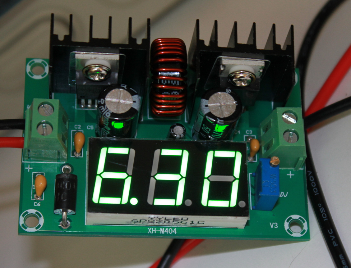

Regarding his question about Baby Huey EL34 PCB power supply, 225 V AC is OK but a little bit low, after rectifier we will have about 310 V DC, I will recommend at least 250 to 275 V AC which will give 350 to 385 V DC... This will be the maximum if you are building the amplifier with 400 V capacitors !
For the bias and the MOSFET, 50 to 60 V will be perfect, you can also use a transformer with two 24 V secondaries (easier to find) and connect them in serial to have 48 V AC... A small power of 10 VA will be enough.
For the heater I recommend to use a switching power supply either directly from the main (115 or 230 V) or from a lower than 25 V voltage secondary. There is a lot of Chinese switching power supply on internet at very low price 🙂 If you want to make or to use a linear regulator you need 8 to 9 V AC secondary. The current will depend of the output tubes, from 5 A to 10 A for amplifier from 6V6 to KT88 (see photos, the first one give up to 10 A from main, I use it with satisfaction with EL34 and 6CA7, the second one give up to 4 A, it is used for only one channel 6V6, and the last one is announced at up to 8 A but I did not test it at such a level ?) !
Best regards,
Marc
