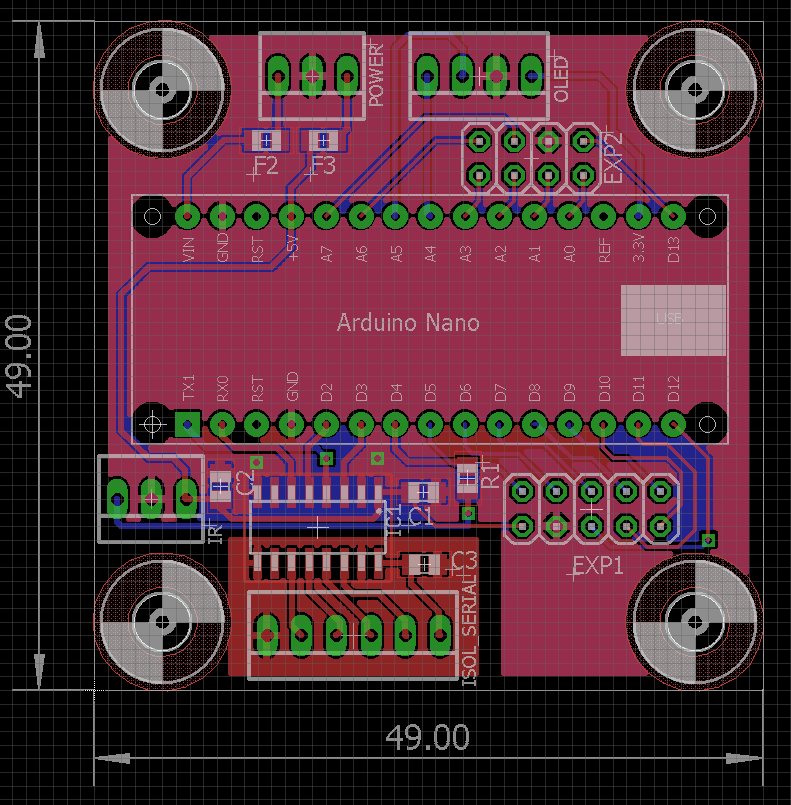

Here is a rough draft of the board:
attachment.php
(click on the pic to see it in its proper aspect ratio)
Besides the necessary signals, I've also exposed all of the Nano's unused I/O. Let me know what you think..

It should be possible to access files stored in an SD card and upload them to the DAM. SD card readers are connected through SPI so I'll have to check to see if these lines are available (or could be made available with reasonable effort). But the software part might be challenging. I had done some such experiments about a year back but I remember getting stuck somewhere.
