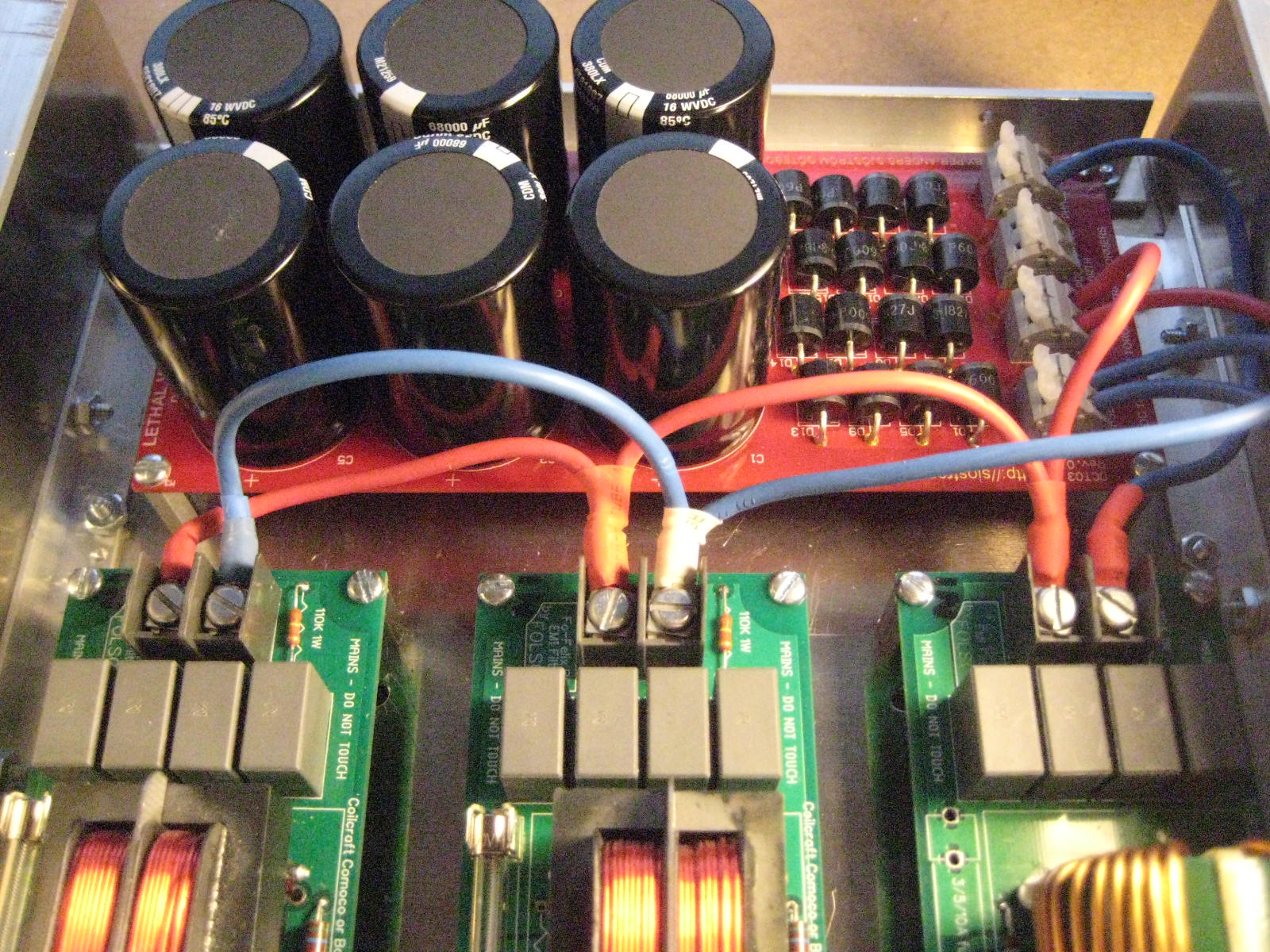

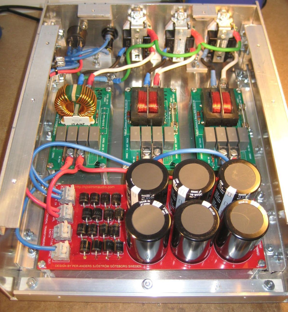

Yes there is room for three boards. The link is aluminum standard American power supply filter socket chassis DIY shell box-in Amplifier from Consumer Electronics on Aliexpress.com | Alibaba Group

hello, what gauge wire did you use in the case/build that you show?
did you use plastic/ nylon washer between the pcb and the case? also, how do hook up the led?

I used 12 and 14ga, basically what I had on hand. I used no plastic washers. The LED came with the socket chassis and included a diode and resistor in one leg so you can connect directly to the AC line.
I finally finished and tested mine and its working perfectly.
The DC blocker is only hooked up to the 17A bourns coil that goes to the power amp.
12awg wire was used only because I had some and the quick disconnects for easy changes if needed.
Teflon coated 14awg wire would be much easier to work with IMO.
All in all, with this being my first DIY project I'm very happy 🙂.

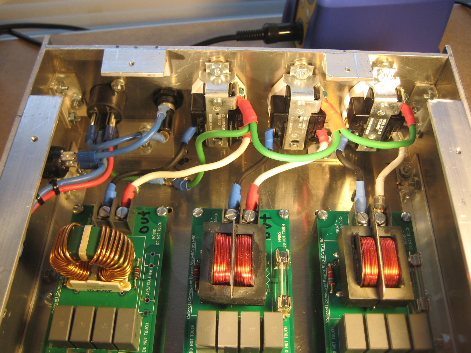

My take on a larger box with multiple outlets for all of the extras in the sound system.
drpro,
Not to be a know it all,
but if you have a metal case, the hydro earth (ground) must be attached to the
metal case with a dedicated machine screw.
From then from that machine screw, I would recommend connecting
the grounds to the outlets using a star configuration.
Your grounds are daisy chained from one outlet to then next - I'm not sure if
that's to code.
Also, I would recommend installing the fuses.
If one filter is over loaded, while the other one has no load,
the breaker might not trip.
