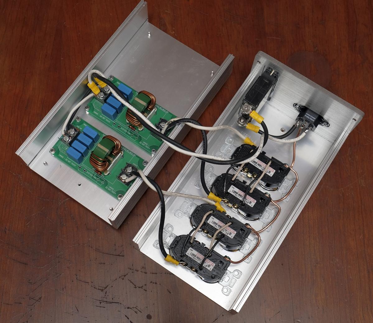

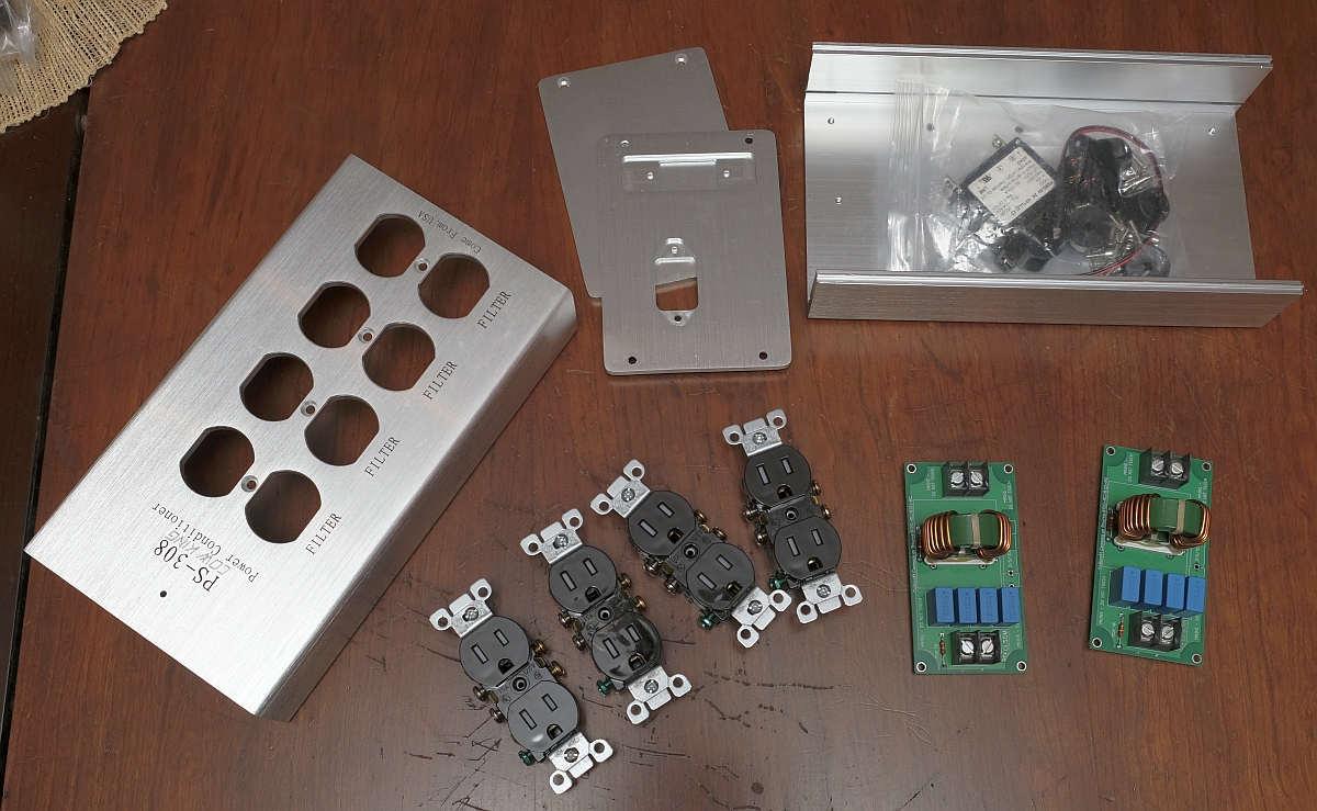

My take on a larger box with multiple outlets for all of the extras in the sound system. Or whatever you would like to use it for.
I found this enclosure online, it came with everything but the duplex outlets and wire. I went with each group of four outlets connected to a Fol-Felix board.
The only bit that is off for those of us in the 120vac parts of the world is the input label is for 220vac.
Not as nice as the one Jeremy was proposing though. For me having the metal work done was great and a time saver.
Not bad looking. Maybe room for one more board? The ones I want to GB... had a sample one nearly done buy discovered I needed to have it masked when powder coated because you can't reasonibly sand down the correct parts to make contact for safety ground. Will hopefully have pics before too long of corrected version.
