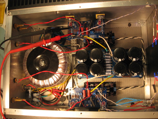

I've built an a F-5 with Peter's boards, and I have another loaded pair and an empty pair, but have plans for those. I've been looking at Christians boards and particularly like the look of the power supply board, and then there's the option of the extra outputs....

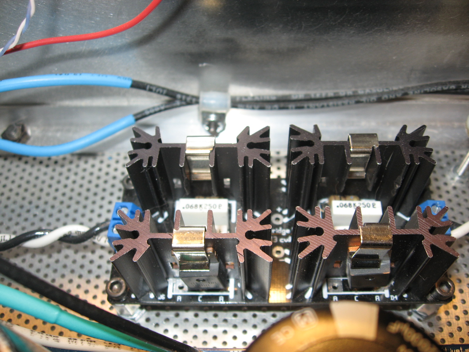

Sorry for the noob question. I want to build stereo F5. In terms of PCB, I'd need:
- 1 PSU
- 2 Channel F5
Do I need Rectifier Boards? If so, how many? I could spend more time researching. But I want to put the order through first. So hopefully people can guide me a shortcut. 😉

Hi parodielin,
have a look at this picture:
http://viller.eu/audio/2009jan_gbf5/P1070474_wiring1.jpg
You don't need rectifier boards if you decide to use block bridges as shown in this picture.

10 boards??? Yeah, I agree they are wonderful. I wish I had purchased more too.
Parodielin,
Get all of the boards from Cviller. You'll find that it makes for a very tidy and clean F5.
