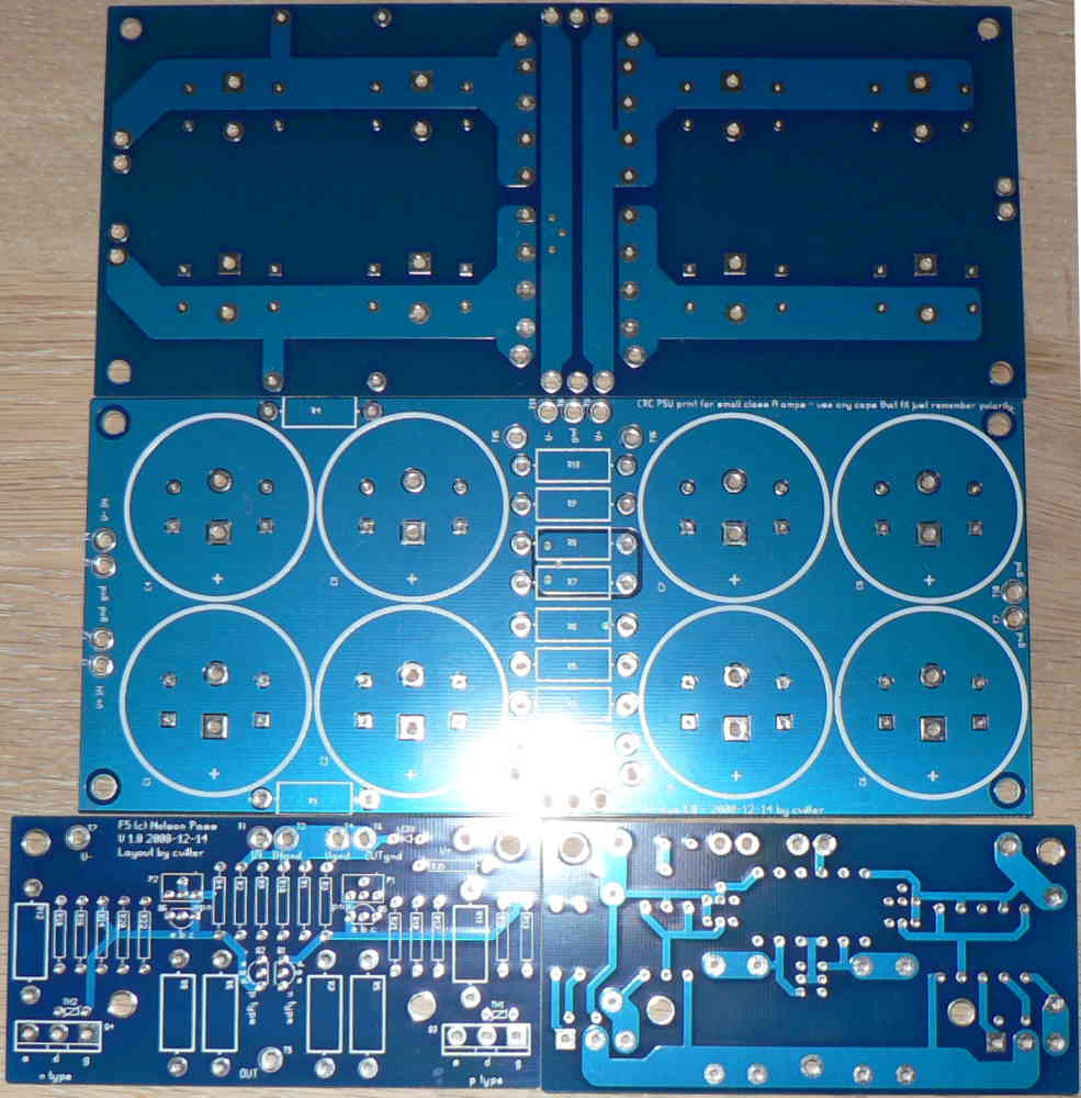

Got the boards!!!
The mailman just arrived with the boards, and they look really nice. (sorry for the poor quality picture)
I had to pay import tax, but it was not too bad. The boards came a little earlier than expected, so I will have to order a few components to complete the stuffing test.

hi cviller, nice looking boards, I´m looking forward🙂
because of the tax, isn´t it that paypal transfer is for free? So we could give you the difference with no problem, even if it is a small amount for a single person.
just say how much!
A (last) tecnical request: I got IR Mosfets, not the recommended Fairchild ones. But it is possible at least to use them for this project, isn´t it? What disadvantages can I expect? more distortion, more offset?
tnx
stefan
I use IR parts with no problem at all. The amp still sounds really good, but you should be able to get less distortion using fairchilds.

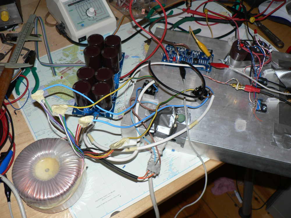

It plays!!
I am now listening to sweet music through my new F5 channel. I was sidetracked by my girlfriend who thought it was more important to buy furnitures and get them assembled... 😕
And then I was unlucky with my toroid, I think it was defect. Besides the broken donut, the build was nice and easy.
Attached is a picture of my test setup (there is also another amp on the sink guess which one... 😀 )

Is there any kind of final schematic for the power supply, to say the board is sort of unlabeled. 😕
Also can i please have some more info about the PSU pcb? Capacitor diameter? Lead spacing? Resistor lead spacing?
I have read the thread over a couple of times and cant seem to find what im looking for.
Rhys
Well it is kinda up to you.... I have made holes and connections for pass labs style psu - you can use that. The board however can be used as a generic CRC or CLC psu of your choice - as long as it uses <=35mm diameter snap-ins.
I can put together a schematics for it though.
Thanks, can you tell me the lead spacing on the capacitor pads? After looking at your post above with the image, i get the idea!
