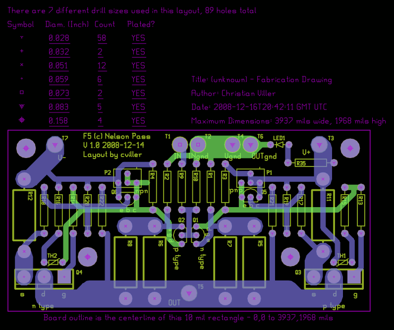

Drill sizes
I have created and attached a picture of the gerber files sent to production, with a list of drill sizes indicated by some pink shapes you can find over the drill holes. You can use this site for unit conversion:

Drill sizes
