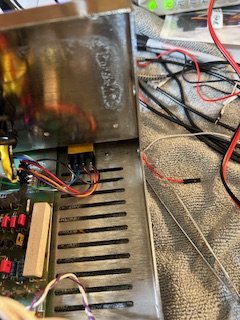

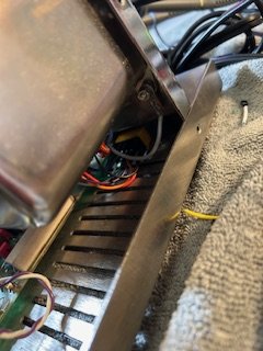

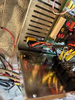

You can replace the green power relay using a standard 12v non-latching relay that's found all over that auction site or from a standard supplier; the only issue is that the form factor is quite different. I used some male-female jumper wires to connect the relay to the the socket -- I could've made a pc board adapter but I'm lazy. Keep in mind that the polarity of the coil connection to the relay is important, and that the NC pins should go to the outside pin points on the socket. I just tucked it away in a safe area and attached it using some automotive trim double-sided tape.

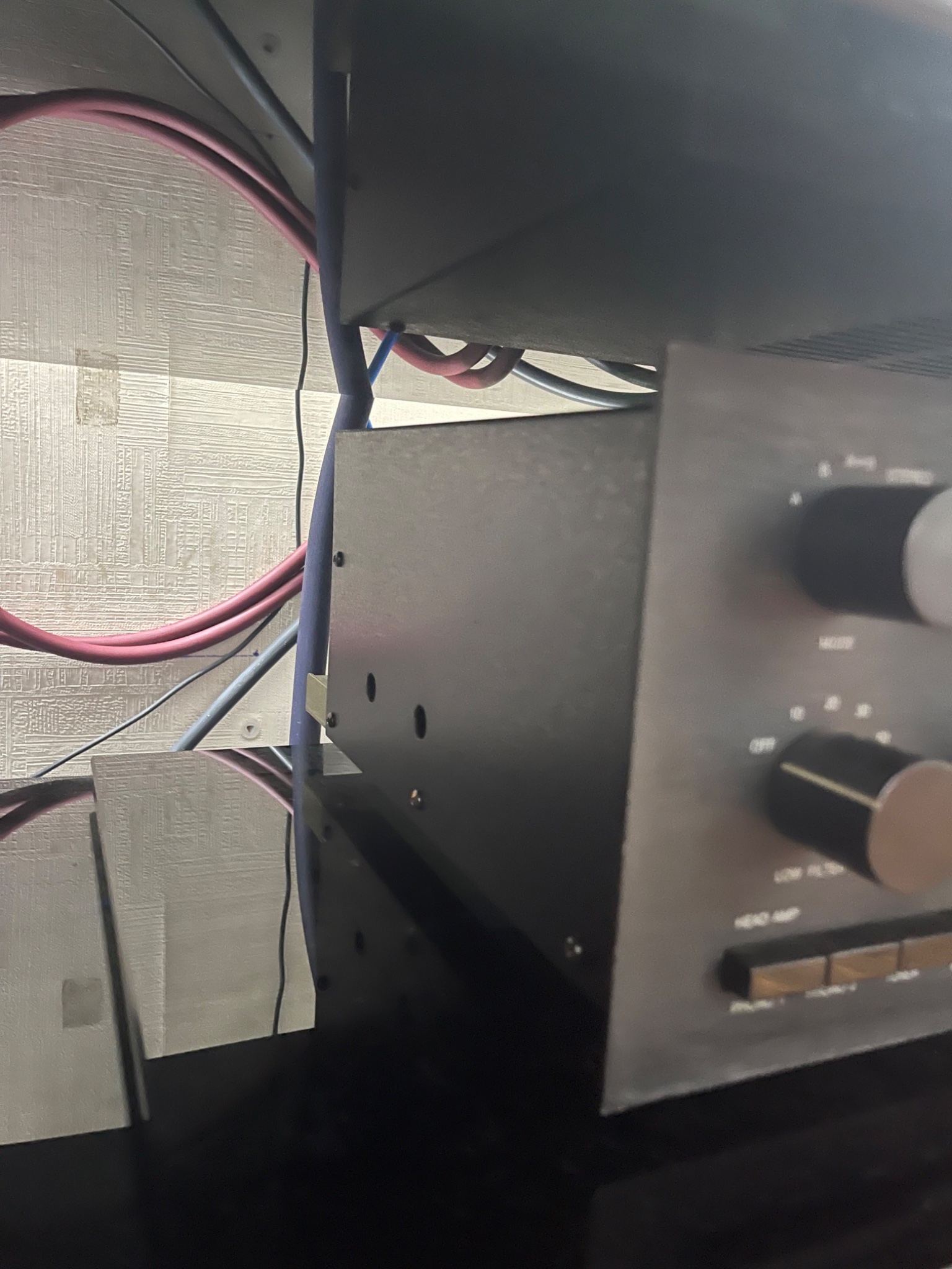

I have fixed my thaedra. it doesn't have a blown fuse and transformer, it has some broken capacitors on the power board. i have a small question i hope you can answer. my thaedra is very hot, especially on the left side. is this normal? i feel it is hotter than my power mcintosh, even though it consumes very little power. also on the left side of it, i see 2 switches, i don't know what their function is. thank you!
Looking from the front, the board on the right, next to the xfmr cage, is the regulator board, it runs on the warm side. Next to that board is the Line Stage it runs on the warm side also. You should have approx. 1.8VDC across the big 30 Ohm resistors for 60ma. Thaedra I runs at 100ma so the Thaedra II is bit cooler. The switches on the left side of the preamp are for selecting the gain of the MC Head Amp.
