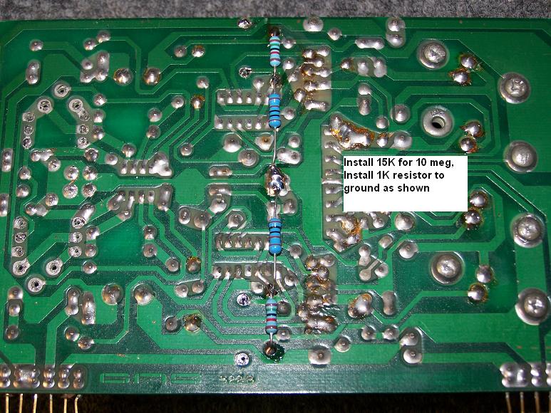

Hi Mike will you sometime soon be able to post the voltage divider schematic to by pass the tone control?

Hi Luke,
I just pulled a 522B board from my stock and have it siiting on my desk in front of my monitor. When I finish what I'm doing I'll take care of it. Thanks for the reminder again.
Mike
Hi Luke,
Remove the cap and resistor, replace 10 meg with 15K and install a 1K to ground as shown. This removes the return from the tone controls and provide a resistive feedback network whose gain matches the tone control networks.
Sorry it took so long for something so simple.
Mike

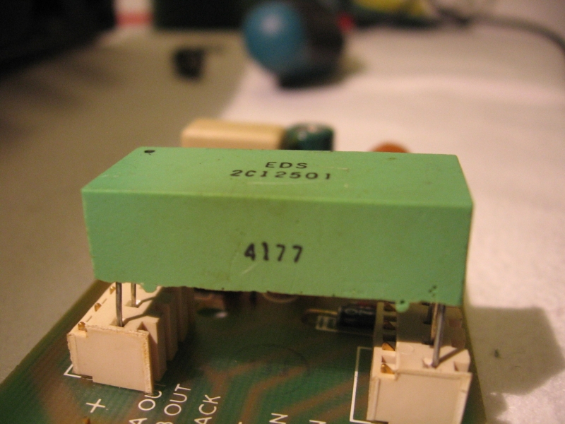

I have a little problem with my Thoebe. If I switch the Thoebe on, there is a bang in the left channel. It comes before the relay switches. Does anybody have a hint for me? What can I do?
I'm pretty sure the relay grounds the output until time in, could be as simple as dirty relay contacts not grounding the output. The relay is on a plug-in board, remove the board, remove the relay cover, clean the contacts with a piece of paper soaked with DeOxit or similar, and the put it all back together. A new relay would be nice but not sure if those are available now.

Well that sucks. The other type of relay, which I have in front of me now, is a NF2E-12V which has a removable cover. The pin out is different so that will have to be sorted out if you can find one. Or try looking for one of the EDS relays. Until then make sure you turn your Thoebe on first, wait a few, then turn the amp on.
I think my Thaedra I has an EDS relay I'll see what I can dig up.
Craig
Craig
My relay board is a 528C and it's out of a Thaedra II. All 500 series numbers are originally Thoebe numbers, which I think was the 5th in the GAS lineup. The original Ampzilla was 100 series, the Thaedra I was 200 series, etc.
My Thaedra I has a MEKO 55-2125-30 plug in relay, so maybe that will work in the Thoebe.
The big resistor next to the relay changed with the type relay also.
Craig
