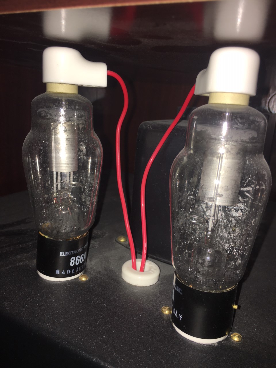

The mercury droplets are clearly seen when cold. As is the amount of mist while warming up. Variations in sound between different makes/vintages are quite obvious. Most "technical" within my stock of 83s is a valve badged "National" which has entirely different looks. Most muisical: RCA from 1935.
Can you post a picture of that RCA and how it should look like regarding the mercury drops...I believe I have as well two RCA in use, but could not see any droplets...just curious how they should look like...with the 866 you can see them much more easily...
Smile...yes, this looks like my 866a...I meant what is the amount you should be able to see in a 83.... mine show mybe a silver mirror coating, but no mercury droplets...
Hmmm. Does this mirror remain after a proper warm up?
Ime the only 83 which developed a mirror was one that suffered several dead shorts. Not sure at all about the mechanism, but it looks like the mercury is fused into the glass. And yes, this would explain the lack of droplets.
Perhaps someone more knowledgeable about the physics may wish to elucidate.
No, they are completely clear once heated...

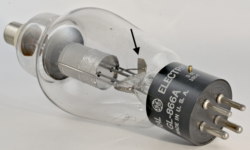

I wonder why most mercury rectifiers don't have a flash getter ? or is it a different getter?
From the picture, I tought it was for a getter?

because this is not a bare vacuum tube.I wonder why most mercury rectifiers don't have a flash getter ? or is it a different getter?
these have pure mercury, or mercury/argon mix.
barium getter could be damaged by mercury i think.
but don´t quote me on ´dis
