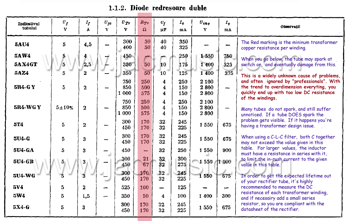

There is an explicit reason why all the most popular rectifier tubes have rather high series resistance: because it is necessary for reliable operation.
Damper diodes are not rated for current surges beyond the peak current required in their intended application.
The surge current due to mains rectification service, especially hot plugging conditions, will destroy the cathode in only a few cycles.
What's the best way to control that current surge? Add series resistance, of course. It's a stupid and wasteful way to go, but so are tubes. Well... that's a rather unkind way to put it, but, I expect few contemporary engineers would've disagreed with that sentiment, either. 😉

Shouldn't a choke input filter reduce the power on surge current to more manageable levels?
Tim
The 6CJ3 is rated for 2.1A peak plate current.. That seems fairly decent to me.
I suppose one could also avoid hot switch-on conditions.
