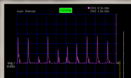

Sending pulses like this to INA and INB, but im not sure about the voltage, as its about 1.4v in the osclilioscope, that means it would be about 92v before my (~65.5x) voltage divider
Use your multimeter. What DCV do you read on those inputs?

with a multimeter its more normal, 2.29v, ill assume the osciliscope is just freaking out. Still going into protect, as it has no driver lol (also the middle pin of the rectifiers is desoldered, gonna resolder that when i get the new driver)

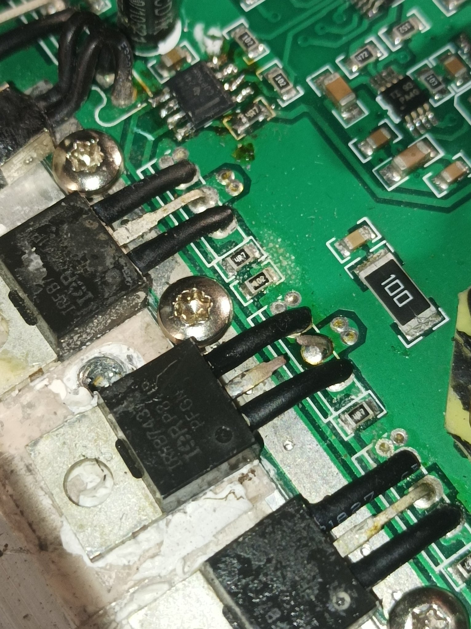

🙁 ****, replaced it, still no work, but a different error. Was power and clip LED on at same time. was testing if its generating a signal and stuff, then a mosfet goes boom. I no longer know what could be wrong
Very ugly solders because i dont have my new tip i ordered, but had no shorts and all connections were good. I no longer have any idea what could be wrong with this amp. When it generates a voltage, it blows up???

Am at a place with some old german analog oscilloscope, can see that there is a square wave on the input of the driver, there is something on the output on the healthy bank, some weird output on the one that died, At 0.1v looks similar to the healthy one, but at 0.05v they are very different, so idk if it died or not then
An old German scope is much better than working blind.
If the IC has two good inputs, a good signal on one output and not on the other, it likely failed.
