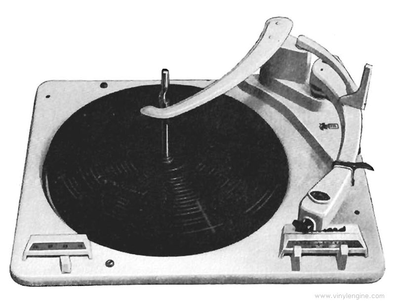

I've successfully restored a PYE Stereo Black Box Model G63 which has a Garrard 210 record changer. Although it works fine it doesn't have the correct head shell - the one I have fitted is cream, 3 pin and made for the RC 121.
What I need is the correct head sell - white, 4 pin and with a black lifting hook.

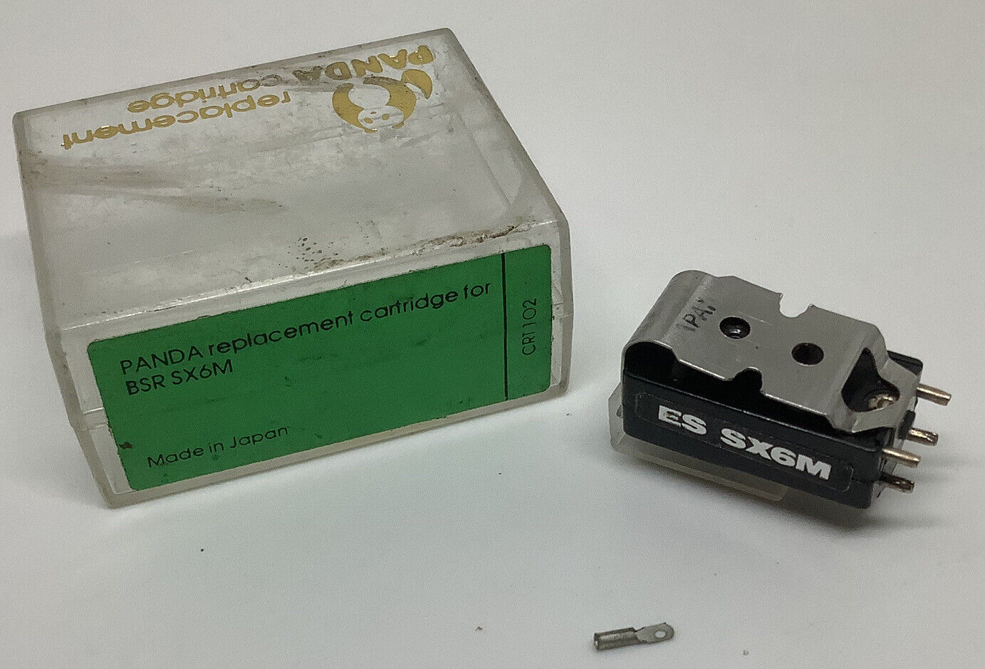

What is it you are trying to find? The cartridge, the mounting adaptor or both?
Complete NOS item available here for £19.95 buy it now: https://www.ebay.co.uk/itm/11590212...jM8Q6KjZrPrkWgvmIwy9ghlNEq|tkp:Bk9SR9DeicnQYg
I see no "broken pin".
I do see a single push on cartridge connector in the image - the type that is at each end of the headshell wires that you have bought.
The box would have originally included four of these in case the user needed new headshell wire terminations.

I'd be interested to know, did your BSR cartridge come with only one connector after all, and not the required four?
Understood, I can be quick!
The cartridge was exactly as shown in the eBay picture - just one connector.
Maybe I just need connectors that are a bit more robust and can handle some manual widening?
