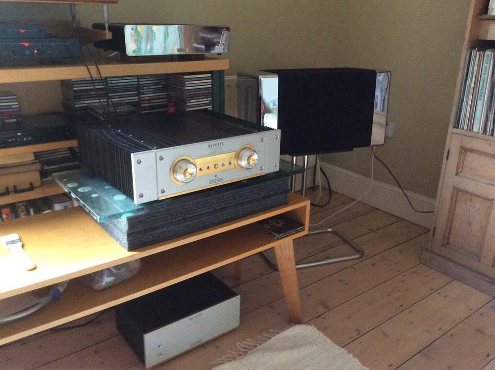

Had our revised xo v original xo shoot out last night. Thanks to Dublinia for coming over. Really appreciate you hauling all 110 lbs of speakers and stands halfway across Dublin!
It was a fascinating evening. Two sets of 401a's in the same room. They certainly looked identical - so much so I took a pic of the serial numbers to avoid mixing up the pairs! But would they sound the same? Similar? Remotely even?
We played a variety of material but for the main part it was Lyle Lovett, Miles Davis, 'Cannonball' Alderley, Art Blakey, Calexico and Gary's Boyle and Moore on 'Electric Glide' who provided the entertainment. All on vinyl with an LP 12 spinner and watts courtesy of a Musical Fidelity Nu-Vista M3... 275 of them.
We kicked off with Lyle Lovett's 'Brown Eyed Handsome Man' on 'Release Me', a superb recording and pressing from Curb Records. My speakers (original crossovers), perched on the new Gale stands. Paul was as curious as I was... "original and best" or otherwise? All seemed good. Was good! Damned good! Just a couple of tracks to keep things focused and then swap in Paul's speakers.
Definitely cut from the same cloth... lots of 'slam', attack, sparkling midrange and layered detail. But where my Gales soared, these reworked xo versions soared higher. Everything seemed be in sharper focus. Same music. Just more of it. More nuanced. This was a "Jazus" moment for Paul and a "ok, I get it" for me. The crossovers will be done!
Regarding the stands, they performed flawlessly. My room has a sprung wooden floor and none of the (very considerable) energy from 32" of combined woofer area, was felt underfoot. They work.
Will need some guidance now on the caps and resistors. I'm keen to keep the integrity of the originals so whatever the modern equivalents happen to be.
