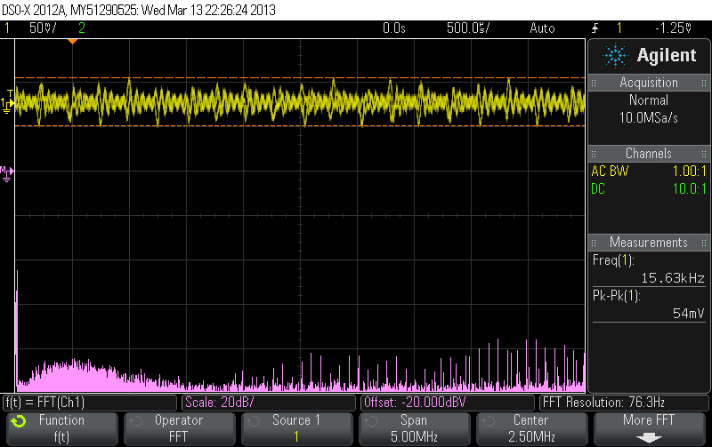

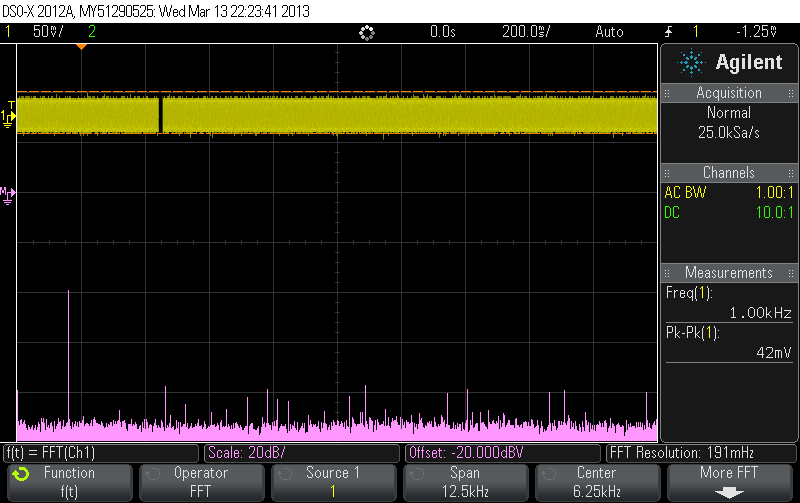

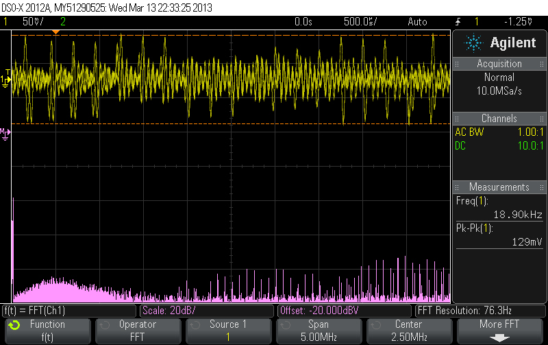

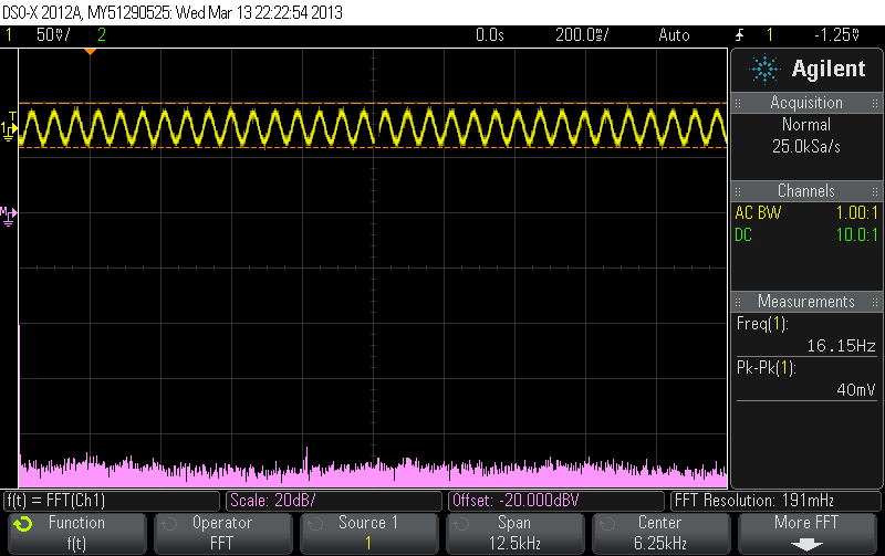

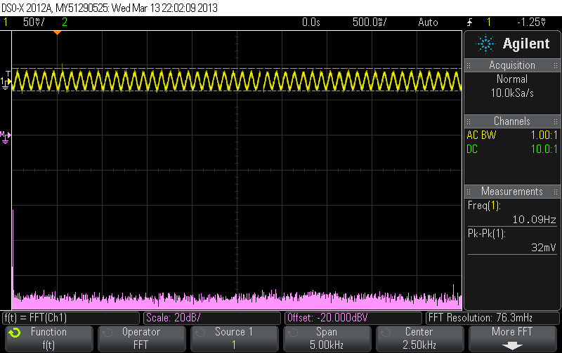

I`ve made some quick measurements on the modded device. I should took the same before, but unfortunately I have not done it... I`m waiting now for some tools to make easy to me to get inside the phone, and I will take a closer look afterwards...
The result of the measurements are quite contradictory. I`m quite convinced that removing of that filtering caps have not big impact for the results pictured here, even though an perceptual improvement for the sound. There may be the DAC which is working so. Even though the all bad to be seen in those pictures, the sound is further very good.
It still an enough big paradox in all this: I can notice some sort of intermodulation distortions in very low end of the spectre, in some special audio circumstances, but the pictures shows the best right in this area. I can not hear something bad in the high end of the spectre, the sound is very detailed and fine, but what is to be seen in those pictures for the high end of audio spectre is quite a disaster... BTW, "hearing" an 18-20Khz sine wave played out on the headphones is a real catastrophe... Only distorted sound! But music come out just fine...
The environment of those quick measurements: I have generated sine wav files (24bit) with the respective frequencies. The files are played out just neutral (no filtering/equaliser or so). No any difference between sample rates. I used both 48Khz (DAC native) and 192Khz. The same bad or good signals out, no matter the sample frequency. No load on the outputted signal. Headphones connected introduce some HF noises (antenna) which it mess the oscilloscope. Is a quite low output level from the DAC...
I think to come back on those measurements (more accurate) another/next time...
The capacitors are likely there to prevent RF ingress and rectification. Having firsthand experience with the EMC testing of such a device, any amplifier pins without RF filtering may cause the device to fail radiated harmonic emissions testing.
The TX power levels in a cellular phone can be very high. Up to +33 dBm for a 850/900 band GSM phone call. Even though it is the output of an amplifier, there still may be a problem. You may even cause the device to generate distortion in the audible range when the radios are transmitting by removing those caps.
as i've said over and over again; in what world does testing for basic (ie pure tonal) interference at audio frequencies only do anything? when did I ever suggest some sort of audio tone would be evident?
Your test does not illustrate any improvement vs what it was before either, you dont say anything about making a or receiving a phonecall, receiving a GSM location ping, so remind me, what were your tests designed to show? that you deem them somehow conclusive is confusing...
