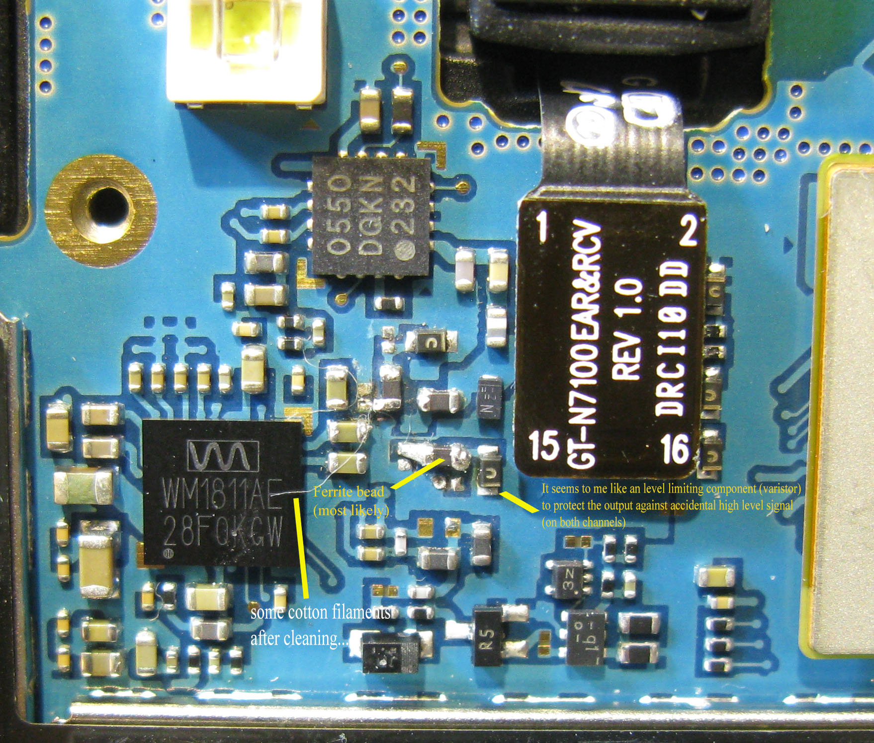

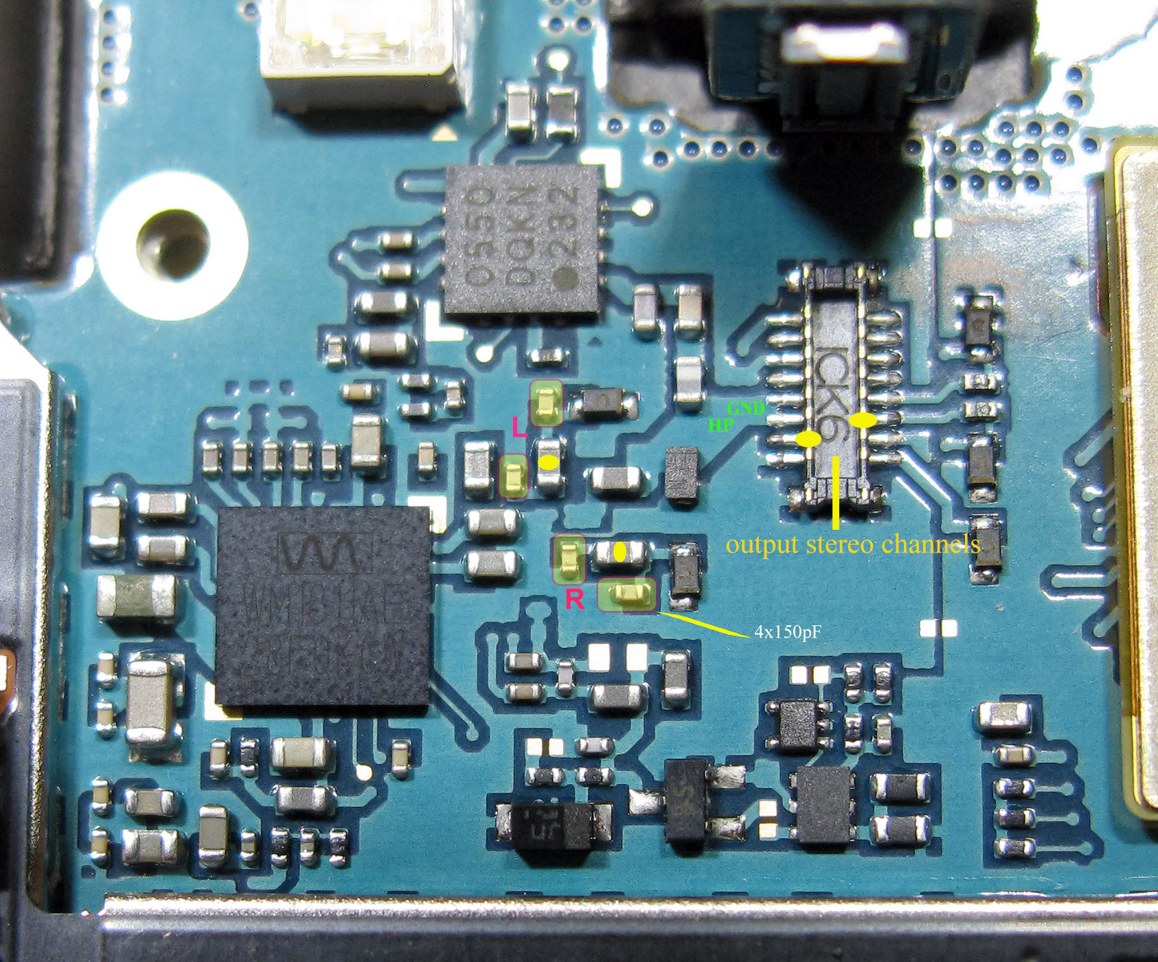

I still appreciate that using of filtering caps on the audio output of the DAC chip is not very fortunate for the quality of the outputted audio signal. I have experienced that capacities of hundreds of pF on output of devices it is altering the audio signal quality. It may be better ways to do this even though the particular case of an important RFI environment... At last I`m not very sure now if that (in this case) component is a ferrite bead. It seems to be, but it may well be a cap (caps network). I will find out soon...
