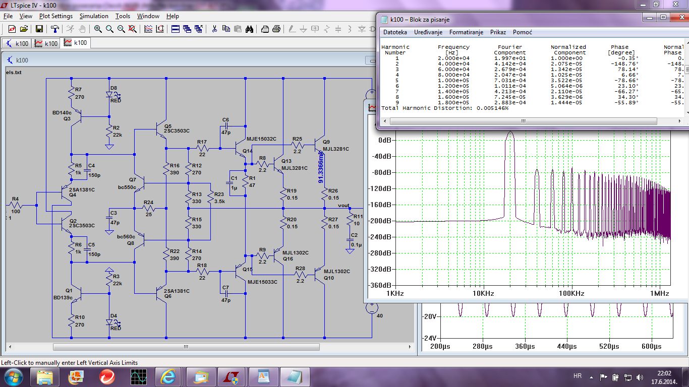

THD20K 0.018803% 100W 4ohm and only 150mA total bias

Yes, but did you simulate it at 1 W, it's even worst then at 100 W, and harmonic distribution is not good at all. In my opinion to get quite low distortion, euphonic harmonic distribution and that it works with no GNFB, a way to go is Class A OPS. I would be happy if someone design Class B(AB) OPS with similar properties as the Class A is not eco friendly.
With the diamond, you can replace the input pair on the OPS with cascoded jfets (despite the absence of the thoshibas there's still good pairs produced for something like this), then you can loose the buffer between the stages.
Still impressed by your voltage stage.
You mean like this? http://www.diyaudio.com/forums/solid-state/255819-gainwire-class-poweramp-ngfb.html#post3918601
...and harmonic distribution is not good at all...
100% agree

Valery thanks for your interest. I simulated some Hawksford EC OPSs and some other types of OPS(buffers) with 100% NFB and I think in some way those OPSs brake No GNFB rule as uses a NFB to lower THD. I know that CFP is NFB but only locally(?). And I never got good harmonic distribution if I remember correctly.
Damir

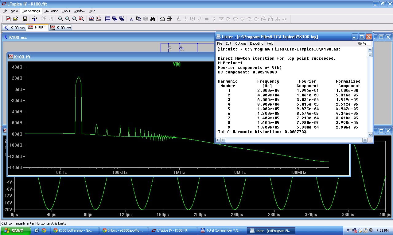

Your FFT are somehow flawed, harmonics are not showed. Could you show your .asc files here?
This looks as finished amp. How have you found the sound?
sim 20k 40Vpp into 4
This is my simulation, I used Cordell's models, readjusted the bias and THD is even a bit lower, but I don't like the harmonic distribution. This shows why I think that HEC is so good for the No GNFB amps.

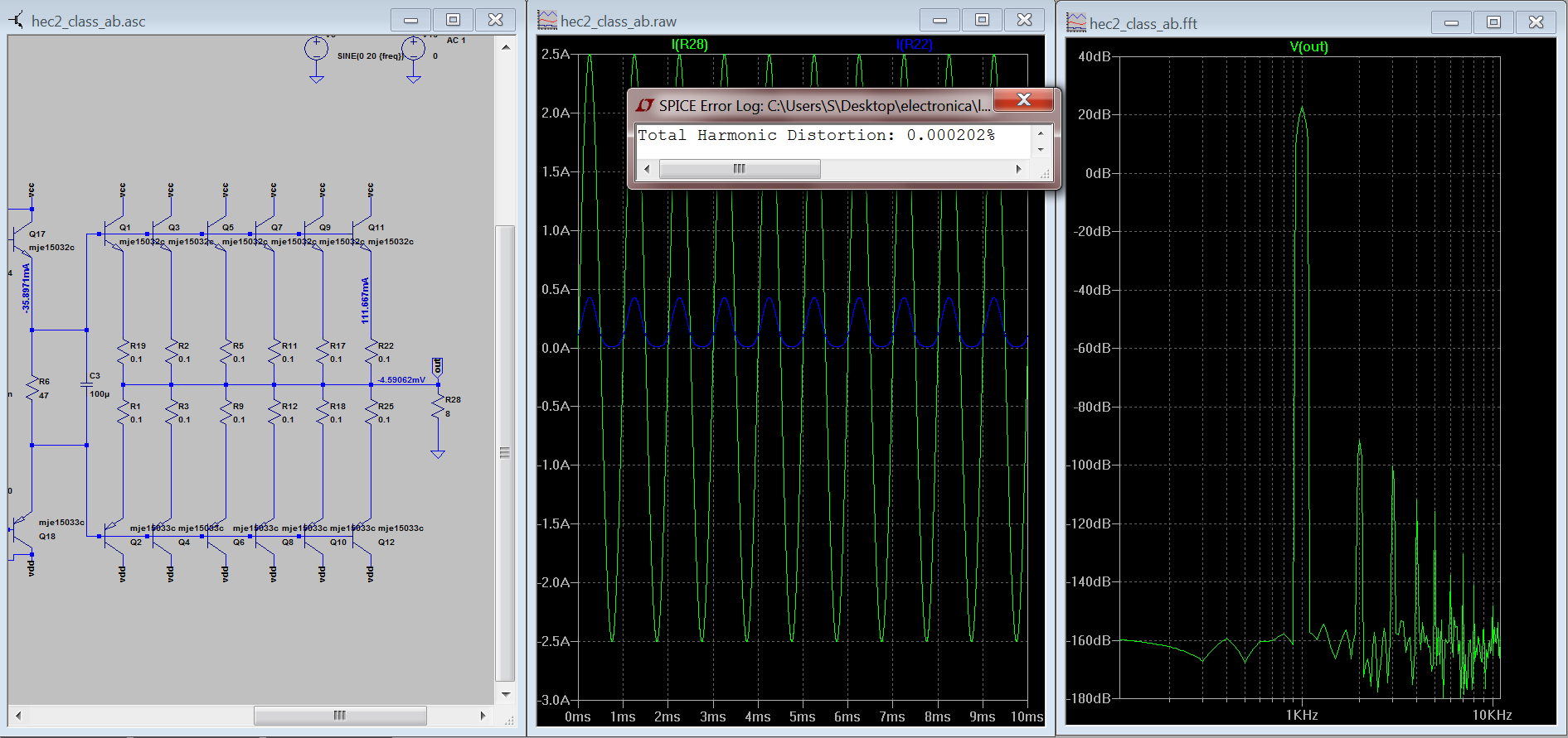

It's possible to design a class ab output stage with similar sonic characteristics of class A with less power waste, in my personal view the way to go is instead of using only one or two pair of power transistor at output, use several medium power transistors like the cheap 45h11 with low emitter resistors (0.1 ohms), in this way the crossover distortion happens at much higher output power.

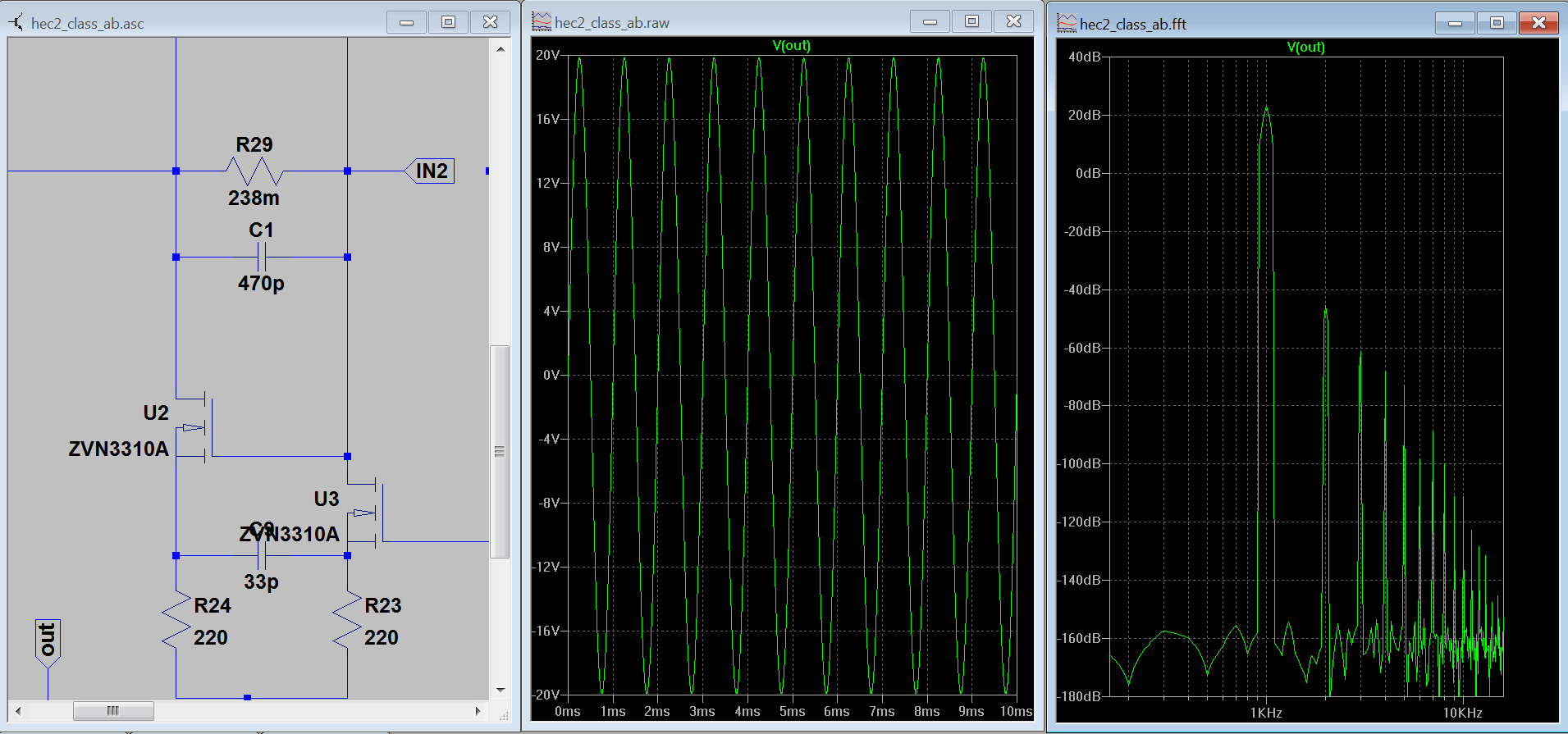

This image is from the output stage of a test circuit of a new error correction that I am developing, I am in the process of simplifying the circuit to make it more DIY friendly when its done I will publish the circuit. The output transistors quiescent current is only 110mA per device, and even with 20V out in 8 ohms load (25W) the output stage have not switch off the output transistors, so the harmonics are very good with only 2º and 3º lower than 120db from the fundamental.
And ofcourse I also find error correction of the output stage a very elegant technique to linearise this problematic stage.

UltimateX86, if we omit the emitter resistors from the output the distortion will be lower but the problem is that in doing so the stage becomes thermally unstable, so in practice those resistors can not be omitted.
I really don't recommend the Sziklai pair for class AB, because the distortion at the crossover region is worst that what can be achieve with the darlington pair. In class A the Sziklay is more linear than the darlington, but again I personally don't recommend class A (just ecological issues of course ).
You don't show whole schematic and it's not easy to comment it. It is not very ecological to use 660 mA total bias either.
Could you explain your use of drivers unusual high cap (C3)?
