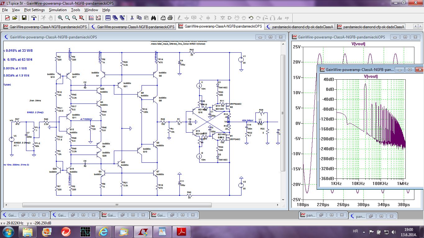

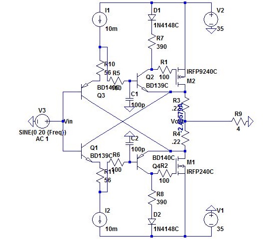

Yes I know that, here is the OPS and ClassA power amp with the same OPS.
Damir, the Dr. Malcolm Hawksford error correction can also be a good solution for the output stage. One nice example is the output stage of the Jan Didden PAX amplifier.
paX: an error-correction power amp

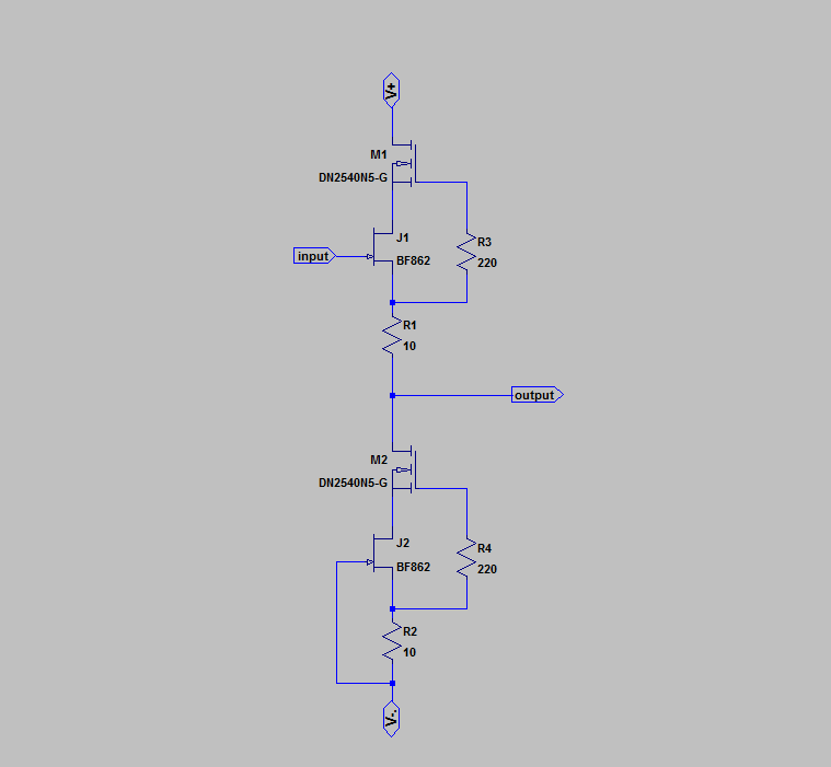

Main problem is to find one OPS with friendly input impedance, as IPS(current conveyor) is quite sensitive to it.
The ops in isolation has THD20k of 0.007413% and whole power amp at the same level increase THD to 0.020025%.

https://sites.google.com/site/opampbasedamp/BUFFER.png
0.016617% 20K 100W 4ohm
0.003030% 1K 100W 4ohm
0.037185% 20K 1W 8ohm
0.035481% 1K 1W 8ohm

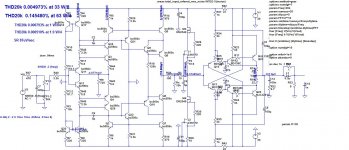

it is not too bad

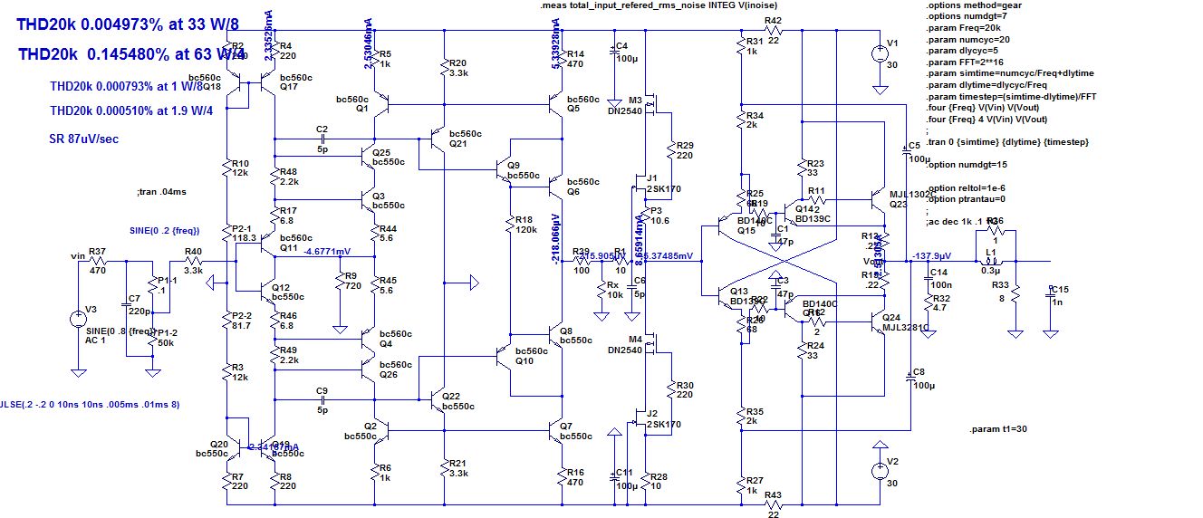

This one could be quite close for practical build.
THD20k at 33W/8ohm is 0.007220% and at 1W/8ohm is 0.000793%.
In my opinion it's better to use power BJT instead MOSFET at the output.

The Sziklai pair at the output is less stable than the darlington and it can easily oscillate, adding a baxandall pair to the mix is asking for troubles 🙂.
If you test your amplifier with a square wave, you will see that it will oscillate, then try my recommendation.
You were right. 😀 Without input filter it oscillate, learning all the time something more, I don't have practical experience with Sziklai.
