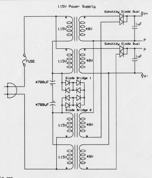

I finally got around to trying the 4-transformer low-flux PS Kuei proposed. The GC in question is 3875 inverted with just 2 resistors and no input cap. Initially a 160VA toroid was used per channel. The transformers i ordered are 100VA EI with dual secondaries which feed dual bridges. I compared the toroid to a single EI (not very fair powerwise) and to two EIs per channel with primaries and secondaries connected in series. Still haven't included dc blocking in the primaries.
The results in my system are a bit controversial. The toroid, as in past experience, produces the fastest and clearest mids, good dynamics but obvious congestion at higher volume and weak and inconsistent bass. The single Ei doesn't give the impression of being less powerful even at higher volumes (my transformer winder claims he's very conservative with the ratings); the sound is a bit slower with a nice deep bass and good depth layering and probably more listenable long term. The combination of two series connected transformers initially showed promise with its ability to efficiently move air. It has slightly overblown bass with good depth, a nice and steady soundstage but very distant mids and generally slow and uninvolving sound. This may have something to do with the low flux but previous experience shows this often to be the result of going over the top with the VA rating.

I understand you are talking about this PS. Which diodes did you use? From what you mentioned, it seems like using transformers separetely may actually produce better sound than series connection?

Peter
That's the circuit which started me. I used MUR860 in a bridge as i didn't want to experiment with too many variables at the same time. Surely full rectification wil sound different to bridge - less switching noise from the diodes but more stress on the caps - may well be better. I might try it first in a preamp as it seems to make more sense with less current. My observations about the sound may only be relevant in the context of the particular transformers i use. Kuei seems to recommend this circuit with toroidal transformers and the results may well be different. All this is pretty inconclusive...sorry.
cheers
peter
The diodes limit the voltage across the caps to 1.4v. I still haven't tried this circuit. It will probably have a more pronounced effect on toroids than on EI and while some of this effect will no doubt be beneficial you'll have to cope with an extra cap colouration. it will be great if you give all this a try.

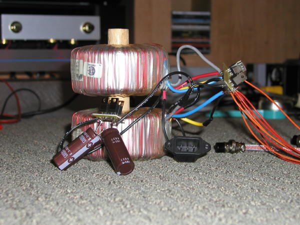

I tried today PS suggested by Thorsten and pictured in post #4. I used 2 Plitron toroids rated 300VA and 2 X 35V. I compared it to single Plitron toroid rated 400VA and 2 x 18V. I used single bridge in new supply between primaries and MUR860 diodes everywhere.
It seems like a new supply has much more micro detail. Low noises and sounds, I normaly didn't notice, suddenly can be further detected, highs are also cleaner and soundstage seems to be bigger.
The old supply has more lower midrange but seems to be veiled somewhat. Please note that I didn't use fuse and switch in new supply, so that may affect things somehow. I also preferred when capacitors and bridge was used between primaries, as the highs were softer and possibly more detailed. I also fed the supplies from 10A Variac, as this brought further improvement.
I couldn't use secondaries of two separate transformers together with same diodes as posted, because of slight difference in voltage on both transformers (and this produced buzzing). I used one transformer for positive, the other for negative rails. I might unwind secondaries on one to match the voltages.
I think it's a worthwile upgrade to a regular supply (although I didn't consider it originally;)), especially if you can find cheap toroids. Mine were taken from older amp I didn't use anymore.Makes me wonder now, what batteries can do?;)

I did some more comparisons today.
I had 225VA Plitron with electrostatic shield between primary and secondary windings and 400VA Plitron without shielding. Both had double 22V AC secondaries. Each transformer was tried with a stereo amp.
Smaller transformer sounded smoother and less edgy, but the bigger was a much better choice, providing more depth, ambience and 3 dimentionality.
I also tried PS build with 2 EI, 250VA, older type transformers (ea. transformer supplying one rail). This PS didn't even come close to what toroids offered.
It also seemed that a 400VA toroid with 18V AC (instead of 22V) was less edgy sounding, but it's hard really tell OTOH, because one supply was well broken in and the other was brand new.
