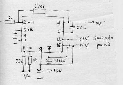

Whatever my reply was previously, I went down to my cave and re-run the input ground: I conected it directly to noninverting input (which is connected to common point). The result? No improvement at all, if not degradation.
Tube Dude was so certain however that it makes a difference, like if he's been working on those type of amps every day. Which makes me wonder if he has the same type of conviction on every issue (like DBT and null testing for instance.😉).
I did one additional change though, after checking grounds. I installed the 50k pot at the input and now the amp reminds me much more the sonic signature of my other gainclones. Which is another issue, either the pot has such a big influence on sonics, or the amp simply needs a sort of resistor at input to the ground?
Tube_Dude said:
I'm not surprised...you have connected the input ground to the negatif speaker terminal...where the loudspeaker retourning currents, retourn to the filter capacitors...and that current produces spurious voltages at that point...
The input ground must be conected to the ground terminal of the IC(in this case the noninverting input) ...that is also conected to the comum ground point(in a inverting amp)...!!

Well, if the source is reliably connected and low DRC/ACR you need no resistor (but that is easy to try).
BTW, I forgot to congratulate on your excellence of implementation. If I could, I'd make you an honarable German.
I rather suspect these Alps plastic pots are to blame. They have a very "manipulative" influence on sound in my experience. I'm afraid I still adhere to the "straight wire" ideas and hence (for example) after much testing no IT coupling in my SE Amp, instead LCL coupling, all IT's I tried where to "manipulative", though thoroughly decent, enjoyable and musical. And hence a preference for $1 Alps carbon trac pots from RS over black beauty or alps blue.
BTW, take the gold BG out and replace the bootstrap with a minimum of BG-N, better BG-NX or best MKT or film & foil (just kidding - I'd use an ERO MKT 22uF anyway).

So far I tried LM3875, OPA549 and today TDA7294.
I've seen grading on a forum of the gainclone chips, where TDA was listed as best sounding, others claimed that OPA was better than LM chip, but my feeling is that LM sounds better than the other two chips mentioned.
The OPA549, IMO, produces the sound that is very clean, completely free of any discernible aberration, but unfortunately also free of too much emotion for my taste. While very clean and taut, the sound lackes involvement, as if the op amps were doing their jobs very professionally, but without emotion - all business, nothing personal. This is not a very big difference over LM chip, and sometimes, depending on listening material, I couldn't decide which chip I prefer, but this is the bias I have.
The TDA chip, although today is the first day I listen to it, seems somewhat lacking coherence (if this is best description). It's very dynamic, with lots of bass, but somewhat bloomy midbass and the midrange seems to be out of phase (for lacking better words). It's sort of bothering and whenever I try to listen, it makes me restless. There is detail, but highs seem a bit edgy also.
It offers somewhat thick and veiled sound, as if I were looking for something through a thin mist, more like a haze. Obviously, it lacks involvement and I really don't know if this can improve after burn in time.
I also understand that the construction of this amp is different than the other clones I made so far. This is the first amp that is using parallel 1000u caps, and my feeling is that a single cap works better. I'm not sure about the bootstrap cap as well. Maybe placing better one would improve things.

Well, it does have an effect. Whether the effect is audible or not is another matter.
The effect is that the voltage drop across the resistance of that wire you have running between the speaker post and ground (due to the current flowing through the loudspeaker) is added to your input signal seen at the input of the opamp as a small amount of positive feedback.

Hi Peter !
As usual, nice job 🙂
Also, I would be interested to take a look at the schematic you used in your 7294 monoblocks if you don't mind.
Thanks !
Thanks !
There is no really any schematic, only the info collected from some posts. I used 2000u BG per rail and additionally bypassed signal supply with 4.7 BG N. You see 33u bootstrap cap in my pics, but this is what I had available.
The amp seems to be improving and maybe it's not that bad after all. But still, I'm missing a bit of air and more resolution in the trebles.
Check the post 882 and 883 of this thread
http://www.diyaudio.com/forums/showthread.php?s=&threadid=9112&perpage=15&pagenumber=59 for instructions and
schematic.
