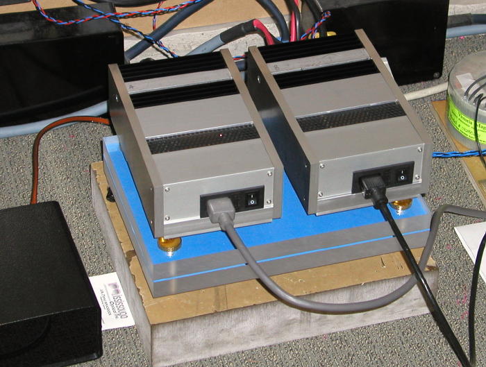

Since there were voices that TDA7294 might sound the best of all amp chips, I decided to built monoblocks based on that IC. I used some small heatsinks and aluminum bars and angles, also found some old transformers which fitted pretty nicely in here.

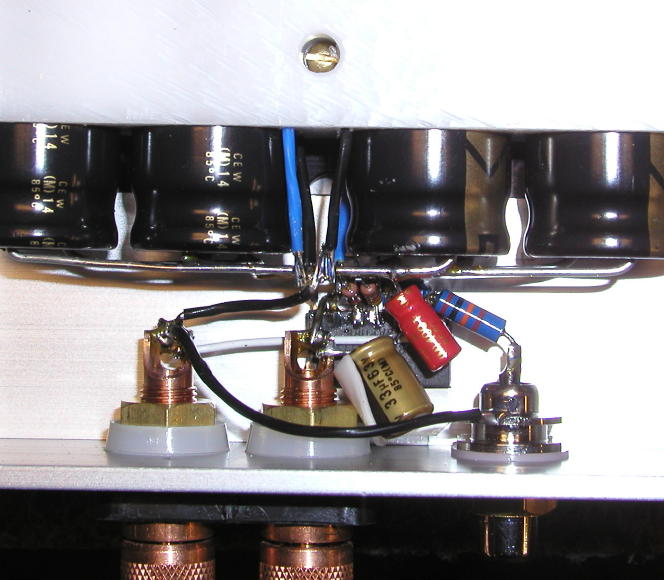

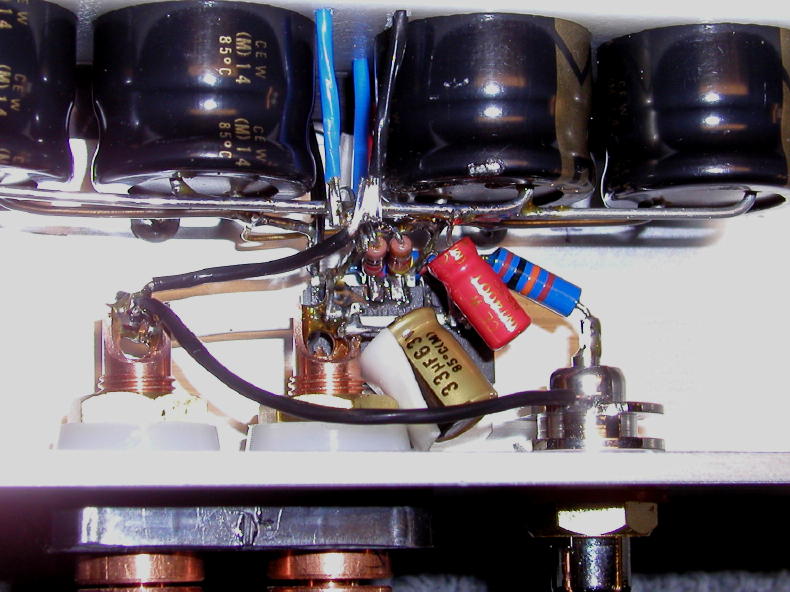

Here's the pic of p2p wiring. It is as short as it gets and I used 4 x 1000/50 BG per channel. The front end PS pins are bypassed with 4.7 N BG. I used 33u for bootstrap cap (Nichicon Gold) and Riken 10K and 220K resistors. Mute and standby pins are connected with 22k and 10K resistors to pos rail. No blocking cap and no pots. I believe the signal path is less than 30mm indeed.😉 It's the length of input resistor, the chip itself and the output pin is soldered directly to the output post.

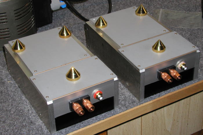

Here's the amps in action. My comments? It seems like the amp is very stable (no oscillations and hum whatsoever). After initial hooking up, I thought that they sound very good, but after listening some more to different material, I think they sound weired. I suspect that it may be caused by that orange wiring or maybe MSR diodes, but something isn't completely right. They are very detailed and bass is great, but midrange isn't satisfactory yet. I will let them warm up and play some more. I'm not using any pot and the amps are connected directly to the DAC's output. I also used 2 BG caps in parallel per rail, maybe it's too much capacitance?😉

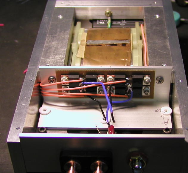

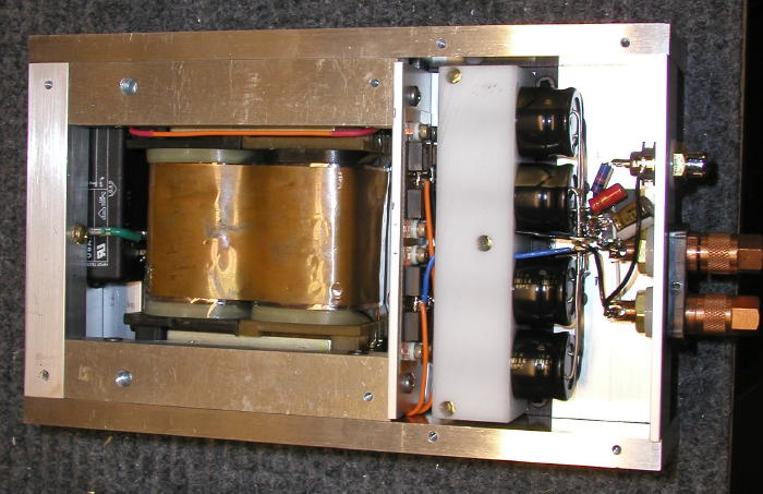

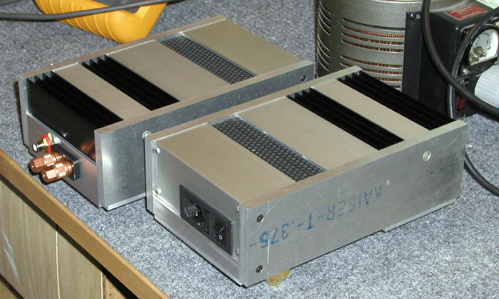

Those are the same extrusions and I'm using 4.5" lengths. I put a 1" square bar between the fins. It improves the looks as well as acts as connecting element between 3/8" side panels and the heatsink. The angles are 1 1/2 extrusions from Home Depot. I only have to anodize the side panels, and I'll do it whenever opportunity arises. The other black thing on top is a plastic mesh I attached with double sided tape, couldn't be easier.
I also have to admit that I really like to work on those small amps. It's much easier than building big aluminum enclosures, with enough detail, it doesn't have to look plain (that was my intention this time) and the results are comparable. It's almost like working on a Swiss watch😉
Peter Daniel said:
This is not a filter, it's a module containing socket, fuse and switch, very convenient.😉 I tried filter before and I didn't like it.
Regarding the cables, this is what happens when someone's in rush to listen to the new creation😉

When ground is not ground....
I'm not surprised...you have connected the input ground to the negatif speaker terminal...where the loudspeaker retourning currents, retourn to the filter capacitors...and that current produces spurious voltages at that point...
The input ground must be conected to the ground terminal of the IC(in this case the noninverting input) ...that is also conected to the comum ground point(in a inverting amp)...!!
In all my other amps the common ground point was always at the speaker's terminal and they sounded fine (not weired). With a distance of no more than 20mm, I don't think it makes much difference where the grounds are connected, it's just that the speaker terminal is convenient point for star ground. My other option was common point at the filter caps, but here I thought the currents might be more disturbing.
BTW, I tried connecting input ground as you propose in the other gainclone and it didn't make any audible difference. Probably because it measured the same.😉
