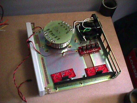

decided on doing a bit of mock up for the layout (dont have a drill or taps here at school, so no actual bolting down of sorts yet). the fan in back will be pulled out, but just felt like making sure everything fits up fine. cant believe i've been able to find heatsinks, cases, and transformers for these projects in the junk bin here at school. this is the 2-ch project box, and the 6-ch version is in the works still

How do we know if we cooked the electrical components when soldering.
I have access to a mutlimeter. Will the readings bee different then what they are specified for if I burned the components?
More questions while I wait for my kit to arrive:
* Does the chip come with the legs bent like that, or do I have to bend the legs to line up with the PCB holes? I hope it's the former 🙂
* Are the PCB dimensions posted anywhere? I'm a little worried I might have picked too small of an enclosure.
* Is it a *really* bad idea to mount the chip to the heatsink/enclosure and leave the PCB hanging? I already have holes in my enclosure (I'm using some old instrument case) that I'd like to use, which means I can't get PCB standoffs to work. I could glue little wood pieces under the PCB to support them (or something else along those lines), or I'll have to drill new holes in the enclosure.
Thanks in advance. I took some pictures of my enclosure (transformer in place, RCA connectors and binding posts added), I'll post them in a little while.
Saurav
Saurav
Yes, the legs are already bent and match the holes on the PCB.Saurav said:More questions while I wait for my kit to arrive:
Each board (inluding PS board) is 1 3/16 x 2 7/8 inches, about 3.02 x 7.3cm.
I wouldn't recommend it. The boards and caps don't weigh all that much, but over time, especially with the chip heating up and cooling down frequently, it could cause the chip's mounting tab to bend or break. Wood or plastic supports would work fine, and I'm sure you could find standoffs of the right size somewhere, anyway.
